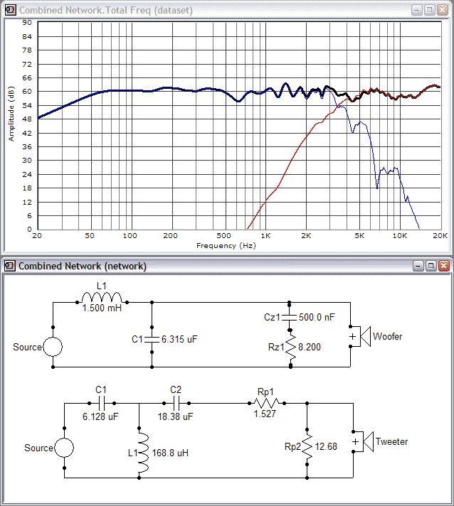

Ok Al, what do you think? How's your crossover design skills? And how are you getting on wil ARTA?
The woofer measurements are taken with them wired in parallel at a distance of 1m.
Hi Vikash
Sorry I wasn't around much this weekend, real life got in the way a bit. The first thing I see is those lumps on the FR chart. They look too regular to be from the driver, is it possible you have some room effects creeping in? Are they nearfield or at 1m? Could even be beaming...
As for the crossover, it looks pretty good, though you might have fun making up some of those cap values. What did the existing TDL3 cross over at? I can't recall.

I think that's the comb filtering effect of the MTM. The measurements were taken at 1m. At 0.5m and 2m the same ripples are present.The first thing I see is those lumps on the FR chart. They look too regular to be from the driver, is it possible you have some room effects creeping in? Are they nearfield or at 1m? Could even be beaming...
I measured and modelled the original xover and guess what!? It's uses half the parts and models better! Nothing to do here.What did the existing TDL3 cross over at? I can't recall.
The grey line is my crossover. The black line is the original crossover. They know a simpler/better way to get round the L-Pad and notch filter that I couldn't do without. I obviously have a lot to learn yet!

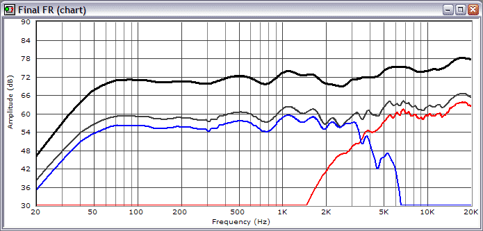

I did some more measurements today with the new crossover parts in place. It's the same xover design as the original (as per my previous post) just changed all the parts for half decent ones from Madisound.
My main concern with the measurements is the small null at 2.5k. All drivers measure ok when measured individually as can been seen, but when measured as a whole there seems to be an issue. I've pulled my hair out with this but I'm sure there's a simple explanation for it...

Hmm. I never measured mine, but now you mention it, it wouldn't suprise me if it was there all along.

Must be your -z and -Y +Y acoustic centres data. Plus that last octave rise looks suspicious. Maybe its your mic climbing due to edge diffraction in that 6mm brass tube. Is it checked against some other mic?

Hi Salas, I thought maybe I had made a mistake somewhere with the wiring but since that null measures the same even with the original crossover I don't see anything I can do about it.
I haven't 'checked' the mic against another. However my measured response follows the tweeter datasheet so there's no concern for me there.
One things I'm learning is that the MTM topology stinks.
