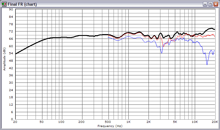

Hi Vikash,Vikash said:I measured and modelled the original xover and guess what!? It's uses half the parts and models better! Nothing to do here.
The grey line is my crossover. The black line is the original crossover. They know a simpler/better way to get round the L-Pad and notch filter that I couldn't do without. I obviously have a lot to learn yet!

Is L2 really connected in parallel with the source, not the tweeter? This could well be "confusing" the sim s/w...

No it's not connected in parallel with the source. That's why the sim looks better than the measured. The last set of measurements are with L2 connected properly and which is the tweeter response is higher than initally predicted.mhennessy said:

Well spotted.
The null at 2.5k has now gone just by attaching the rear connector plate. Weird. I was doing all my previous measurements with the parts hanging out the back (apart from LF measurements of course) and it just didn't occur to me to try it sealed up. I still don't understand why, but it's solved without worrying about time-alignment nonetheless.
It seems all TDL had to do was add an L-Pad and the tizzy top which was the biggest problem with the RTL3's would have been a smaller problem! 30 degrees off axis this (very cheap) tweeter has a very good FR. I'm not up to measuring distortion yet (and not sure I'd want to on these drivers )
Without further ado, here's the final result. Now for the other speaker and I think I'll be ahead of your forecasted finishing time PM
