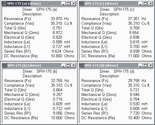

Firstly you need Res, and that is given by the voice coil resistance Re subtracted from the measured resistance at Fs.
Then Qms = Res/ (BLsquared x Cms x ( 2Pi x Fs))
Qts is the same formula, only replace Res with Re.
Off to watch CSI Miami, back later! ;)
I've finished building my clamp and measured the four drivers again. I get consistent results with the same driver now (using 11Khz sampling rate in SW) but the TSP differences between drivers is a little worrying.
How should I pair these drivers up? And which driver should I model an enclosure around?

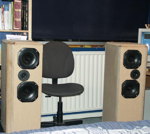

I had the first listening test for my first set of DIY speakers today. I still haven't put any filling in, and so the enclosures aren't sealed properly (screws only), but they sound quite good.
They are *still* impressive at hitting the low notes, which is something I was initially worried about moving from TL to sealed. They also appear to have a flatter response in the bottom end which is great. The midrange is more pronounced than how I remember, and the top end still sounds raspy - expectedly so since the tweeter hasn't been changed.
Still a way to go yet, but what a buzz :D
