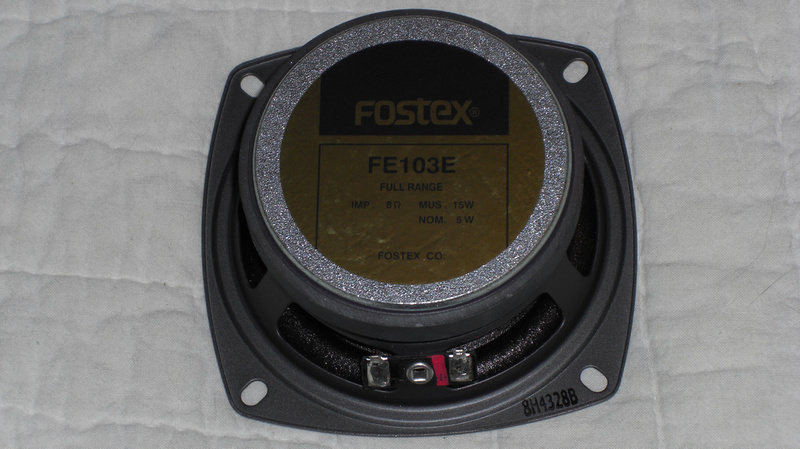

Speaking of FE103E's...

Just a quick update...
I decided to hook these little drivers up to my unmodified, original Sonic Impact T-amp last night to get a few hours in on them. I know it's cheesy, but I have them mounted in cardboard boxes. One is in a total of 0.180cf and the other in 0.198cf., both as sealed as can be. In each one, I have 2 pairs of loosely placed socks (LOL) to add a little damping to them. It honestly helped out a lot! They are connected to the amp via Stout-Interconnects' Extreme Speaker Cable.
At any rate, I've had them running constantly since last night with 5 different pipe organ CD's in an old CD changer I've had sitting around. When I was home during lunch, I turned the volume up just a tad bit, then went back to work.
When I got home from work tonight, I decided to hook my iPhone up to the T-amp and play some Pandora through them. They have improved tremendously, not to mention that I can totally see the great possibilities with these little guys! Even in these cardboard boxes, they have surprisingly punchy, detailed bass that's digging deeper than I had expected, in cardboard boxes that is.
Of course, midrange and treble is just as good, if not a little better. The treble is zippy and crisp enough to not need a tweeter, and sounds just about as good off-axis as they do on-axis. The midrange is very good at pulling out the subtle details. It can fluctuate a bit in tonal character in the midrange, but I'm sure that's because they are still brand new drivers and the fact that they are in a cardboard box. However, most of the time, the midrange sounds very natural and very very clear.
For the past few hours I've been listening to a bunch of old 80's music like Genesis, U2, Sting, The Cure, etc, etc. Now I just switched over to some jazz, blues and big band stuff like Miles Davis, Charlie Parker, Stevie Ray Vaughan, Eric Clapton, Diana Krall, Ella Fitzgerald & Louis Armstrong, Frank Sinatra, Dean Martin, Harry Connick, Jr., etc, etc...
I'm really impressed with these FE103E's in their current state. I can only imagine what they would sound like in proper enclosures! I'm pretty darn sure that these are going to stay in the house and I'll be getting another pair for my vehicle. As it is, they are coming up on 27 hours of constant break-in, so they can only get better from here.
I'm off tomorrow, so I think I might try a little larger cardboard boxes, but this time ported, just for fun. I've got a few other projects going at the moment, so building actual enclosures for these will have to be put on the back burner for a short while. In the meantime, I'm enjoying listening to them as is! LOL
