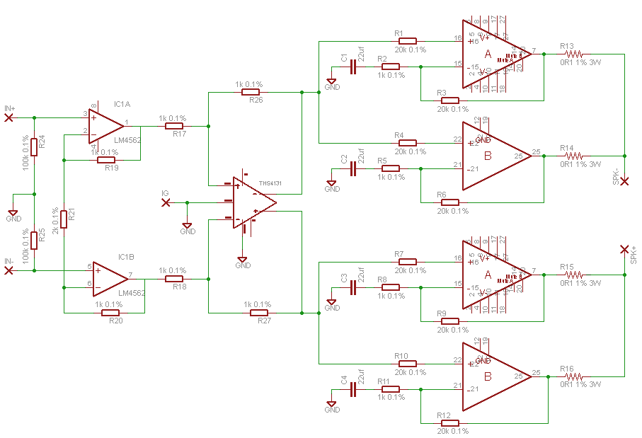

This is my first attempt to design and realize a BPA200 based amplifier with 200W per channel.
I have named it Wendy200 after my better half of course !
The amp features:
- 2x LM4780 power amps per channel, in an BPA200 arrangement as seen in figure 17 of the AN-1192 application notes (using the non-inverting part of the circuit only)
- LM4562 instrumentation amplifier front-end / buffer
- THS4131 for voltage gain
- 0.1% quality resistors all around
- SMD components all around for compact size and short signal path
The front end and power supply scheme is quite similar to the Sympatico amp from my favourite twistedpearaudio.
The attachment shows the schematic.
The instrumentation amp has a gain of 2, the THS4131 has a gain of 1.1 and the power amps have a gain of 20+20=40 (due to bridged configuration)
I just want to share it with you all to debug, improve it and choose the right components.

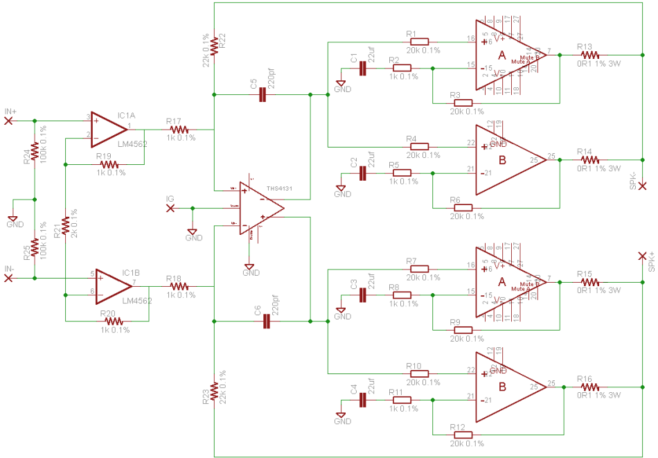

Alternative design
Alternatively this design (attached) could be followed, which theoretically is the same as the above (I think), the only difference is the negative feedback point of the THS4131 is now from its output directly (as in the THS4131 datasheet applications) and not the output of the LM4780. Is that a better implementation and if so why ?
Another question I have is what type of capacitor should I use for C1 - C4 ? In the national's application notes they use both electrolytic and non-polarized ones - which is best? Would ceramic or niobium oxide ones be ok? Another option is to completely ditch them, is that going to be okay?
Also is 3 watts rating enough for R13 - 16 ? It's difficult to find 5W resistors.

All depends on what your looking for.
My personal tastes would be to take the output from the LM4870.
One suggestion increase C1-C4 from 22uf to 47uf, I tried going to 100uf and low frequency motor control became an issue 22uf is to low for solid low frequency's 47uf is the best compromise.
3 watt output resistors are fine, I have used 3 watt ones in all my BPA's with no issue.

Thanks for your advice tiltedhalo
My aim is to achieve good low frequency response so I will follow your advice to use 47uf for C1 - C4
What material did you use for these capacitors?

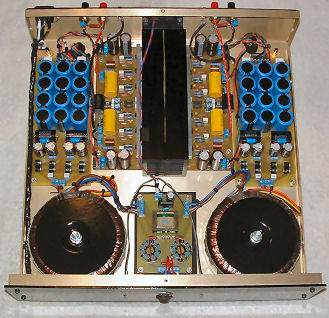

here is a pick of my daily user ...........

Wow nice project tiltedhalo! Seems like you've done a thorough job.

I would use each dual chip to amplify one inverted and one non inverted channel rather than each chip amplifying the same polarity channels.
I agree, C1 to 4 need to be larger.
I would try 100uF or 150uF and try to solve the PSU motorboating problem rather than restrict the LF content.
Each chipamp is driving the equivalent of the load impedance. If your load is 8ohms then each individual amplifier needs +-20mF for C1=150uF. But the inverted signal passing through the dual chip may allow this smoothing capacitance requirement to be relaxed substantially.
A dual chip passing the same signal would require the +-20mF for each half equaling +-40mF per dual chip and +-80mF for the complete amplifier.
Have a read of W.Jung's paper on composite opamps.
Most of what he has to say applies to your composite.
The gain in the final half is determined by the overall gain you require. I think he suggests something like 2 times. If I recall that gain advice correctly then the gain stability of the power chipamp will not allow you to follow Walt's composite model. i.e. it might not work.
Also read Walt on balanced audio.
He advises very high impedance on the balanced inputs. i.e. replace 100k with 1M5.

AndrewT thanks for your educated reply.
Note that I am not any expert in design so your suggestions have triggered a lot of questions to me:
1. What would be the benefit of that ? Balancing the thermal load maybe? I would prefer the poweramps to drive the same polarity for a simple PCB.
2. I think understand your point. So presumably "motorboating" is caused by RF inteference in the negative feedback points, right? If so, how can this interference be rejected? Use of filter caps elsewhere maybe?
3. I would really appreciate if you could point me to these 2 articles (links or attachments?). I have only read the really basic stuff in op-amps.
Ideally I want to keep the gain of the composite front-end to a minimum and really use the op-amps as buffers and for noise rejection (oh and XLR inputs too).
So, If I set the instrumentation amp gain to 1 (by removing R21) and change R22 & R23 from 22k to 44k to get a gain of 2, would that be in accordance to W. Jung's recommendations if I understand well?
Thanks again and apologies for the many questions... I am over excited about this project !

http://waltjung.org/PDFs/WTnT_Practical_Circuits_for_Quiet_Audio_Transmission.pdf
for balanced input advice.
http://waltjung.org/PDFs/WTnT_Op_Amp_Audio_1.pdf
http://waltjung.org/PDFs/ADI_1992_Seminar_Audio.pdf
http://waltjung.org/PDFs/Op_Amps_in_Line_Driver_and_Receiver_Circuits_P2.pdf
http://waltjung.org/PDFs/Composite_Line_Driver_with_Low_Distortion.pdf
http://waltjung.org/PDFs/WTnT_Op_Amp_Audio_4.pdf
for gain in the second stage of a composite opamp.
I recommend you read ALL of Walt's papers, preferably before you start designing anything with opamps/chipamps in them.

no.chatziva said:1. What would be the benefit of that ? Balancing the thermal load maybe? I would prefer the poweramps to drive the same polarity for a simple PCB.
it is to reduce the transient current demand in the power supply pins.
Rather than draw double the current through each pin alternately, each pin draws peak current simultaneously but at sufficient to to supply the load (not doubled).
motorboating is a low frequency instability, more common to valve (tube) circuits.chatziva said:2. I think understand your point. So presumably "motorboating" is caused by RF inteference in the negative feedback points, right? If so, how can this interference be rejected? Use of filter caps elsewhere maybe?
Arranging the RC time constants of SS circuits almost always eliminates it from our designs, but
implies that motorboating can still happen when the time constants are selected arbitrarily.I tried going to 100uf and low frequency motor control became an issue 22uf is to low for solid low frequency's 47uf is the best compromise.
The problem is almost certainly down to the PSU setting the LF filter rolloff.
When the input filter (which your circuit does not have) should set the bandwidth.
I think I will try 100uf and will include an input filter if motorboating occurs
When you say "input filter" do you mean a "signal-in" filter network?
What would be a good one (values) assuming motorboating occurs?
Evan
AndrewT said:no.
I plan to use common V+ and V- for both power amps so the arrangement you are suggesting is not making any difference unless I use separate supplies for each power amp, right?
Evan
it makes a difference to the current flowing to the power pins and through the power pins.
This in turn will affect the way the PSU interacts with the chipamp.
That is why I suggested that the PSU smoothing requirement may be relaxed if you use each chipamp to amplify both polarities.
The input filter should be about an octave higher than the filter effect of the PSU and about half an octave higher than the NFB filter.chatziva said:I will try 100uf and will include an input filter if motorboating occurs ...........When you say "input filter" do you mean a "signal-in" filter network?
I use ~90mS @ input, 130mS to 150mS @ NFB and 160mS to 200mS @ PSU.
90mS~=F-3db@1.8Hz.
AndrewT said:The input filter should be about an octave higher than the filter effect of the PSU and about half an octave higher than the NFB filter.
90mS~=F-3db@1.8Hz.
Maybe a drawing / calculations of RC values would really help me understand this.
What is NFB ?
So does this mean that you recommend the use of input cap ? (like the one shown in the national's application notes i.e. 0.47uf + 47k ).
I was trying to avoid having an input cap... (is that good practice?)
AndrewT said:it makes a difference to the current flowing to the power pins and through the power pins.
Sorry I don't understand this.
In either arrangement all the V+ pins will be connected to a common line for all 4 power-amps and the same goes for V- pins.
So the transient currents in the possitive and negative rails should be the same in any of the 2 arrangements, no?
I plan to use 4x 10,000uf per channel for smoothing, the schematic will follow soon...
I believe the point Andrew T. is trying to make with one half of each chip inverted and non inverted is to reduce the current demand in half at the chip, reducing the loading effects on the PS, chip pins and PCB traces.
When one side of the chip is drawing negative current the other is drawing positive, instead of positive positive negative negative, this will help with the need of heavy decoupling at the chip, and the LM4870 has small pins and multiple power pins, and small traces to connect these it can introduce capacitance and resistance variables at the chip.
Andrew T. correct me if I am wrong.
As for motor boating I have never had an actual problem with this, I have had issues with capacitive saturation at heavy signal swing with larger caps.
