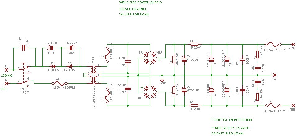

All,
Thanks to your input, I have reviewed the PSU design - which is attached.
So I have taken it a bit further and it now includes:
a) A full CarlosFM MK4 PSU snubber scheme,
b) DC blocker on mains, as per DIYPARADISE to protect the transformer from DC, and
c) Optimised fuse values
I have not included a soft-start as I don't know how to design one, I will consider using it in the future.
To me it looks pretty much there, I am quite happy about how it's turned out :cheerful:
~ Any feedback ? :D
that DC blocker is wired incorrectly.
The two diodes should be wired in inverse parallel, not in series.
The tapping to the mid point of the series caps should be omitted.
A single pair of diodes will voltage limit at around 600mVpk to 700mVpk. If you need more voltage to prevent the small capacitors forcing the diodes to conduct during normal operation you can use 4diodes, each series pair are connected in inverse parallel. Go look at Peranders' site to see how to do it properly.
Remember the mains DC blocker is at mains potential, keep it away from probing fingers and tools and debris.
A very simple soft start can be made from a Power Thermistor in the live mains supply to the transformer primary. It's so easy to implement that it's not worth omitting. Look a Nelson Pass' site to see examples of implementation. I prefer a Power Resistor with a timed relay bypass, but that complexity can wait till you have the amp running.
The mains fuse is in the wrong supply lead. It must be in the Live lead.
Otherwise, when the fuse blows it leaves the equipment connected to Live but appearing to be dead. Now touch that chassis with the fault and you could be dead yourself.
The 8A fuses between secondary and rectifier do almost nothing to improve safety.
Re post41 & 42,
I habitually use 10mF and 15mF smoothing caps. Banks of 20mF, 30mF, 45mF are built up to suit each amplifier.
Not terribly inventive, but they work.
The 4700uF caps before the resistor suffer extreme ripple current on high current draw from the PSU.
Either specify caps suitable for this extreme duty or use 5off 1mF high ripple caps paralleled to give an adequate ripple tolerant first smoothing.
AndrewT said:
no, the mains fuses are there to prevent the mains cables overheating and causing a fire after the amplifier has failed.
secondary fuses are there to minimise damage to the PSU and all upstream of the fuses.
The secondary fuses should be placed after the main smoothing and before you distribute the power around the amplifier. Most builders tend to place them at the amplifier PCBs, but that leaves the interconnecting wiring unprotected.
[/B]
quote:The 8A fuses between secondary and rectifier do almost nothing to improve safety.
But they are protecting the (extensive) PSU, no ?
no, the fuses protect the upstream side after the downstream side has gone faulty.

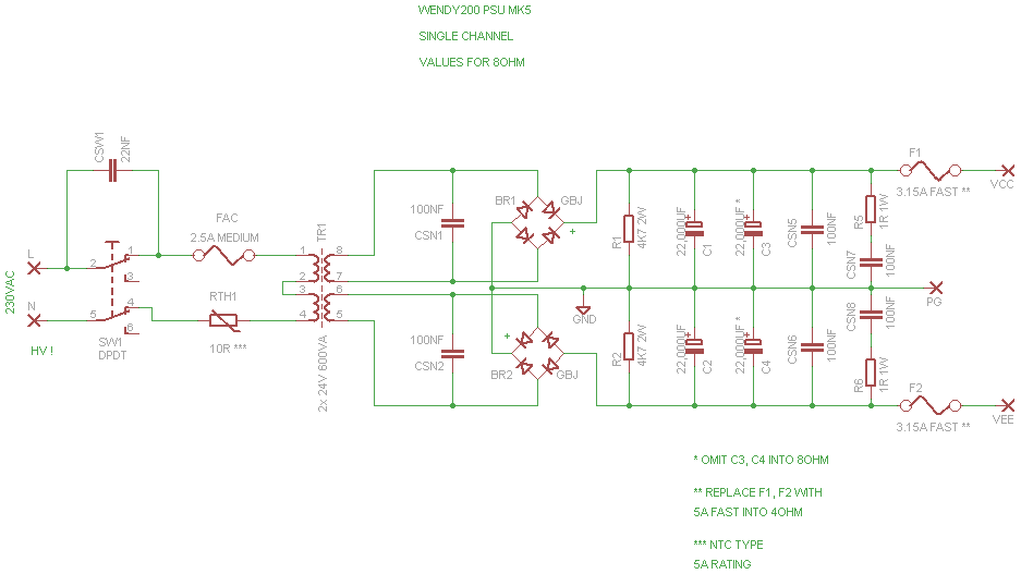

Re: Re: Wendy200 PSU MK4
pacificblue said:
There is the saying "Don't cry before it hurts".
As long as DC from your mains doesn't give you trouble, save your money for that DC blocker.
Well my thinking was that a 600VA trafo will be subject to be more currents, so why not protect it.
It is an optional circuit as it is not part of the PSU board anyway
Here is the latest PSU design implementing a few changes:
1) Soft-start 10R thermistor on the AC mains line to limit inrush current. I plan to use one of these: SG27 or CL-60
Is the position of the thermistor correct?? In the CL-60 datasheet they are applied on the DC rails in series.
2) Big change: Removed the RC filter before the filtering caps for simplicity. This simplifies the PSU a lot as that resistor and cap were physically large plus the cap needs to have large ripple current rating thus difficult to find. The alternative of 5x 1000uf caps will take up a lot of space.
Will the effect of removing this filter be big or should I try to squeeze the 5x 1000uf in?
3) Removed the unnecessary 8A fuses
4) Simplified design by using 100nF snubbers all over
