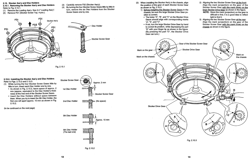

Please don't use WD-40. That will cause more problems. I use'd to do the factory service for Canada. CN701 is the problem, then you have to reset the mech. The solder they used is too soft and pulls off easy so be careful. I still have some parts for these units (MB-70/75/100) and some for the CD-700 series if your looking for any. I've only had to replace one laser pickup assy.
Martin
Martin
This is only one part of the alignment, but its the most important one.
The rest should be right, unless someones 'played' with them.
Most of the others have an associated mod needed too.
(file here, drill there, replace modded part x)
I found 95% of the ones I've done needed only cn107, and this 'stack' mech to be realigned.
Watch those little white 'seats' (F01) on the four legs. (away from the mech plate) They have a small spring in them, and go 'TING' easily.
You will kill yourself if (when) one 'dissappears'........
