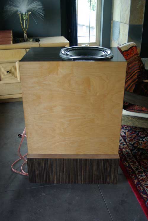

Here is a picture of the finished speaker.

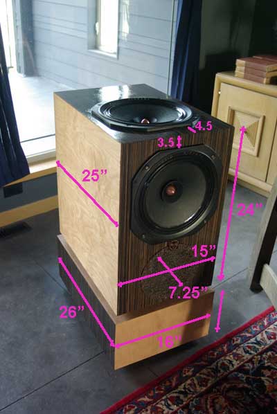

The dimensions are shown below.
The cabinets are made of 3/4in birch plywood, reinforced with drywall, which is glued and screwed to the inside of the cabinet. They walls are braced with wooden rods that go from side to side (middle). For damping, high density foam (used for beds) line the inside.
The drivers are single wired in parallel. At first, I installed a switch that would turn the top driver on and off, in order to A/B the difference, and perhaps use the switch for different kinds of music. But as I preferred the dual drivers in every instance, I ended up removing the switch and save whatever they introduced.
The difference in sound between the single and dual drivers is the sense of space. Subjectively it is like listening to music in a cramped space, vs. a large open one. You would think the placement of the drivers would introduce time delays and muddy the sound stage, but in fact they expand it vertically so the sound has more 3 dimensionality, just like real instruments in a real concert hall.
The 7 1/4in port produces tight and good bass. I heard low notes that I hadn't paid attention to before (in Eno's Apollo for example). The second driver must reinforce this.
For the relatively low cost of the drivers, I couldn't recommend them more. Check them out if you can.
The exterior construction is two tone, coco bolo Formica is used where the drivers are, and on the sides of the base, and they received two coats of glossy polyurethane. The rest of the cabinet is left natural and mat. The only place that I had to worry about cutting the plywood at 45 degrees and biscuit join them was at the front of the base. The rest of the cabinets were simply glued and screwed together, with the Formica covering the screwed parts.

Just curious, why the configuration you chose, and not a traditional bipole?
What is the tuning on this cabinet? It seems a tad small for one of these drivers, let alone two, as the Vas/Qts specs are pretty high (reciting this from memory, so if I'm mistaken, my apologies).

The size of the cabinet was strictly a matter of listening preference. Believe it or not, I started with a cube of 24x24x24. But I found the bass a bit lost, and not as tight as I currently have. I ended up cutting them and making them the current size, but you could be right. Some people use them as open baffle (infinitely large).
I find the current bass to my liking and not cramped at all. At some point I will post measurements.

As for the statement: "What is the tuning on this cabinet? It seems a tad small for one of these drivers, let alone two, as the Vas/Qts specs are pretty high", it is true that the volume called for is higher than 2L, and in my case the volume is around 1.5L, but I find that the additional driver on top helps with bass production, since some of its higher frequencies are away from the listener, reducing the need for a larger cabinet.
If you take a look at the current high end active infinity and B&O (not that I'm comparing with them!), you'll see that the way they get all that bass from a small cabinet is by using lots of watts for the woofers. Here we are acoustically achieving the same effect. The bass is tight and flat to as low as I can hear.

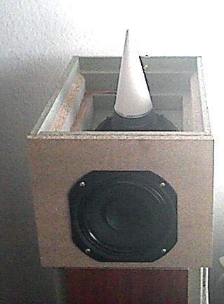

invers bad look:
make it to a design like
my Posaune, Saxophon,
or a heavy flowerpot, magnetfield fixed by a piece
of metal glued under the Flowerpot, try different sizes.

How interesting, I like the fact that you made your top driver almost the same depth as your main driver. That must help with creating a more pin-point 3d source of sound.
I do have a question though, referring to a real instrument like a violin, doesn't it throw all frequencies in all direction? If you're missing the top half of the spectrum, wouldn't that detract from the 3 dimensionality? For example, in a concert hall, the deflectors on the ceiling are usually designed to disperse a wide spectrum, not just the mid/lows.
