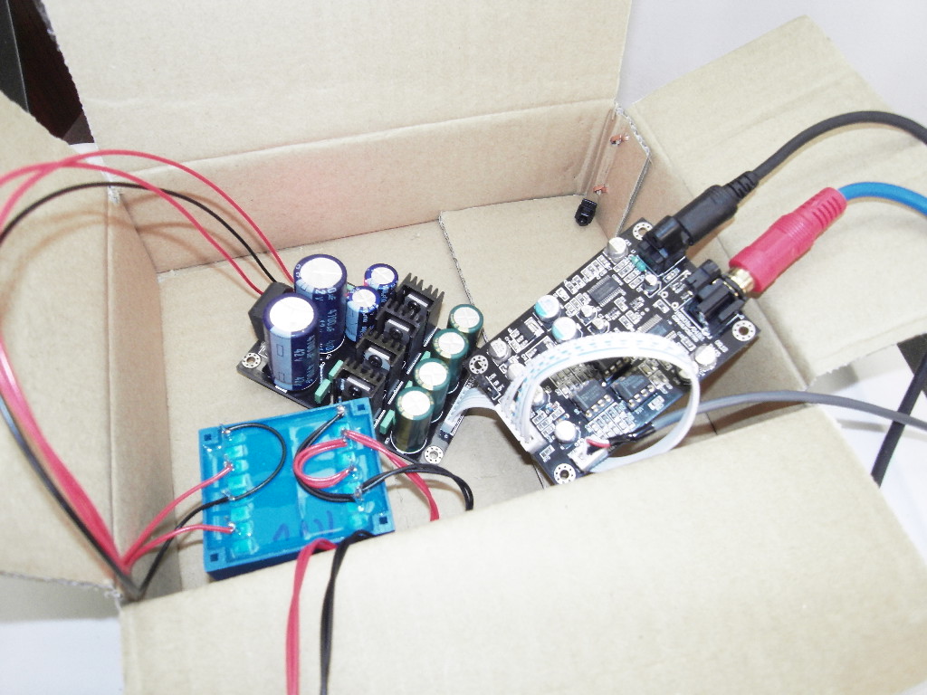

Looks like a good DAC. Uses PCM1798 which reputedly is better than the CS4398.
Not sure how you would use output transformers though. It is easy on the bigdac, but this uses SMD parts so no holes to tap into.

the 2010 lampucera is completely different than previous DAC.
maybe the modding will be the same but i don't know.
ok, 2 OpAmp are for the I/V conversion(OpAmp conversion? sorry but i don't know what this project means) and the third is only for the output?
if so, the transformer will be connected to the last(THIRD) OpAmp.
i mistake something?

and literally out-of-the-box (see pic) it sounds splendid... i have a Burson opamp and OPA627 that i'll try in those two for kicks in that third socket later today and let you know how the sound changes. Now need to find an old external hard drive chassis to put this in...
My romantic notion of spending big bucks on a bitchin' TT is tarnished now with this simple lovely sounding setup -> MacOSx86 netbook clone -> Buffalo NAS server -> ripped FLACs -> Airfoil -> Airport Express(s) -> toslink -> Gigawork DAC -> Primaluna integrated tubey. Listening lossless and wireless to Sinatra's "Nice n' Easy"... and it is indeed! :nod:
I have very good results with 2 lm4562ma as i/v + 2 lt1028cs8 on a 2 simple=>1 dual opamp on the third socket.
I'm about to try some LL1636 Lundahl transformers to shortcut the whole opamp circuitry. I know it triples the price of the dac, but passive output may be pretty rewarding! At least, I hope so... :rolleyes:

Tried both LM49720 and LM4562 in the I/V stages and i truly cannot hear a difference between the two. That's not to say i'm not happy however ;) The Burson dual on the output sounds splendid now after 100+ hrs. twas a bit bright initially with my Maggies, but has warmed considerably.
Has anyone here had any experience with upgraded caps to replace the SMDs (a la Lampucera investigations on the previous rev board) they'd like to share?
