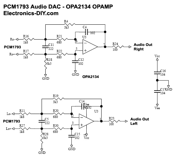

Here's my existing output stage schematic attached - a differential Vout from a PCM1793 into a LPF with gain of 1.83 to bring the level up to 2 Vrms. Instead of OPA2134 my board has an inferior op-amp OP275 but it still sounded good stock. I moved the 1K8 R on each leg down to the cap so as it was now isolated from the DAC output & I could connect a wire to each vacated solder pad on the DAC output side. I will be able to use a switch or jumper to reconnect the original output stage if needed.

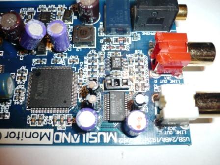

(Pic of board is attached before this mod)

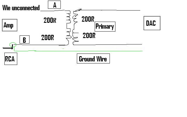

I've attached a crude drawing which I hope explains it. One of my secondary leads is left unconnected (A) to the amp - I just use the other one (B) as the signal into the centre pin of RCA connector & a ground wire runs all the way back to the DAC board. Is this wrong? It seems to be the only way it will work? If I connect both legs without ground I get hum. I discovered that if I connect the A wire across a 100R to ground I get a higher volume (stronger signal) - any explanation for this?
That is why I had pause about the Tripath connection - should I connect the A wire to the Biascap, this will give a 2.5V bias to the B wire but also 2.5V to the ground because of the 100R across it to ground - should I leave out this 100R?

It sure did & I'm sorry for all the questions - it's just that transformers are another world to me in this role & there doesn't seem to be much info on here - thanks for your help 🙂 I really don't know how to calculate the R reflected back from the secondaries & is this R the impedance of the input stage of the amp? Why does my cross-connected 100R increase the volume?

A few answers:
Your circuit will work, I've done it (by accident.) But it's not the best way to do it. And you will often see 2X the output wired like this. You should really connect one end of the secondary to the point where the input cap normally goes. The other end to the 2.5V bias. Think of the 2.5V bias as your ground.
If your transformer has dual windings then you have the ability of wiring them in series or parallel. That will change the ratio of the transformer - and the DCR, as you note. In series is probably best for you. So 400R. With that you have to figure in the inductance of the transfo and the load on the other side. With a 1:1 transformer the reflected load is the same as the secondary load. Thus 1:1
The impedance curve of the transformer will start at DCR at DC (of course) and rise rapidly toward about 20Hz. From there it will rise more with a few kinks and bumps to be a bit higher than the secondary load at 20KHz. As you can imagine, putting a 2K or 3K resistor across this will swamp that rise. You'll get a much flatter curve and your chip will be happier.

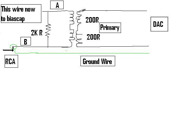

I'm sorry Mike, I don't understand - can you do a quick sketch please? Also I don't just want to make this specific to a Tripath amp as I may want to plug it into other amps!
Also you say a 2k to 3K across - do you mean across the secondary or across one secondary & ground? See my diagram

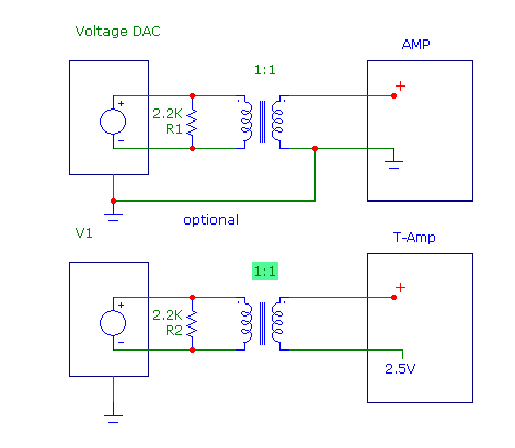

Here is a little diagram. The top is for a normal amp hook up. You would just plug this into an integrated amp or a preamp.
The bottom is cap-less connection to a T-Amp. But - you will have no analog volume control. OK if you do it digitally. But if you need a normal volume pot you'll need another transformer. A TVC would be ideal here. (not the autoformer type).

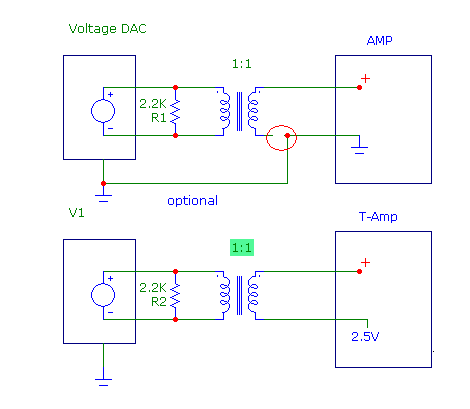

It's funny that the casual practice you have shown of tying a ground to a trafo primary or secondary is totally contradictory to the original need for their use in the first place, galvanic isolation.
John, your trafos are definitely not line out units if they measure 400 DCR, the nominal impedance is in the range of 10x to 20x the measured DCR so they are around 5k/5k. In your wiring diagram with one leg floating they are acting as coupling capacitors, not trafos. With a 5k trafo, try a 5k load across the secondary. Contrary to many opinions, 600ohm output trafos do not need a load. Look it up if you don't believe me.
I know nothing about T-Amps, but I know not to subject trafos to DC, it will magnetize the cores unless there is an air gap built into them. The only air gapped trafo I tried was the UTC A-22 which was fine sounding but missing a lot of low end weight.

Panomaniac, (Mike, isn't it?) - thanks for the diagram - I see now 😱 So I've attached my version which is different in the red circled area which just leaves one leg of the secondary floating (although now connected a 100R across this leg & ground). I'll experiment further trying to understand what's going on.
I see your 2nd Tripath diagram - I can see how the connection to biascap floats the signal at the 2.5V needed but I'm not sure how it will work without a ground - I will give it a go, thank you

I'll try grounding the primary CT.
The basic wiring concept is simple, balanced out from the chip to balanced in on the trafo to either balanced or unbalanced out of the trafo. No grounds except for a needed reference ground for your downstream single ended equipment which is simply tying one side of the secondary to the shield of the RCAs and not the chassis. I have used both balanced and SE preamps with zero hum.
This is the way I would also have understood trafos to work, that is before I actually tried it & got hum,no signal, etc. This threw me & I realised that I needed some expert help!
If the Tripath needs something else then you have some research to do. Try the basic setup on a different amp to gain some insight, if the Tripath is problematic.
It's just that the Tripath has 2.5V bias on it's inputs (It's a Class D amp) which is normally blocked by a capacitor - Panomaniac was suggesting a way to avoid using a capacitor by the schematic he drew.
If you are using a meter to verify the circuit output and have no signal as previously stated in the other thread then you have problems other than the trafo implementation.
No I now have signal but with the configuration I drew. Time for some more experiments 🙂
I agree with Bill. The bottom diagram by panomaniac (post 13) should work without hum.
If you have hum them either something isn't hooked up right or you have a power supply fault. Or a bad transformer.
I say that without knowing what the amp input schematic looks like. Do you have a link to it?
isolating the grounds is the main benefit you will see in using this transformer approach. You shouldn't need to connect grounds between the DAC and amp.
