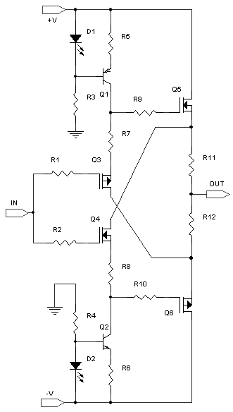

I've attached a schematic for an amplifier I designed to drive a 1 ohm ribbon speaker where I tried to adapt the diamond buffer topology to a high current bipolar output. Hope this example can give you some ideas for experiments.

Hi, Linesource,
Thanks for the schematic. Very nice design. How is the sound?
With diamond buffer, I wanted to eliminate the need for VBE multiplier, but your example uses both of them :D Without VBE multiplier, how will it looks like?

Here's what I used in the output stage of my amp. The output FETs are biased by the voltage drop of the driver pair and the resistors in series with the driver current sources. One can tweak the ratio of the series resistors and the output source resistors to get the desired bias current. The drivers go on the same heat sinks as the output devices for thermal tracking. I generally use driver FETs that are one to two sizes smaller than the output FETs. That way, I can run them with a smaller quiescent current than the output devices and still get sufficient voltage drop for proper bias.
The big disadvantage of this setup is that it lops about 10V off the output voltage swing on either side. I made an amp using a complementary JFET differential folded cascode input stage to drive the diamond buffer. Even with only +/-30V on the rails it sounded like a pretty big amp. This beast is currently in pieces on my work bench getting outfitted with a new toroidal transformer for higher voltage rails (+/-40V), bigger drivers and outputs, a better heatsink and thermal interface, and more voltage across the cascode devices. I'm interested to hear how it will sound when hooked up to my new JFET open loop preamp...

Hi, Wrenchone,
How much bias do you put in your amp? Will this DB works properly if the bias in the final stage only about 25mA?

Lumanauw,
I ran my diamond buffer at about 200ma bias on the output stage, and 20-50ma on the driver stage, depending on device size. If you really want to use 25ma in the output stage, you will need to use smaller MOSFETs or bipolars. Actually, the diamond output stage may be overkill. This afternoon, I simulated a single ended current source loaded source follower using a pair of IRF510s. Bias current was set at about 20ma, supply was +30V. With a 300 ohm load, distortion at 1V out was around 0.016%, and 0.1% for 5V out. The output of such a beast needs to be capacitor coupled, but this may not be a severe restriction. With an open loop amplifier you would probably need a capacitor couipled output anyway.
The diamond buffer was part of a closed loop amplifier. It's the preamp that's open loop.
