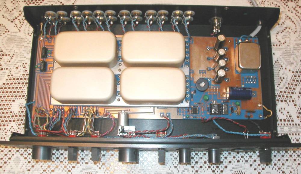

Just had Jon Soderberg of Vintage Amp go through the NS 10 I have.
Jon advised this was a prototype NS 10, not the standard production NS 10.
Was fully operational when I received it, but being some 28 years in service, decided to send to Jon for a check out and any needed service. Replaced all non film caps and additional work done of the modules. Sounds fabulous, great build quality, as we have come to expect.
Connected to a Threshold 400A power amp. Amazing to me that after 47 years in this hobby, I keep going back to the early Threshold gear. For me there is just something special about this gear, and now when I can afford most high end gear, its become back to the future - Kinda weird in some respects.
Anyway I highly recommend Jon for any and all service work on Threshold products. Great work,price is right, and knows what he is doing. Hard to find today.

Forgot to tell Jon to replace the Volume pot. But I can handle that chore. Any ideas on which one to use? I have a Noble 50K around here somewhere, use that or something else?
For me the NS 10 is just magical. Perhaps not everyones cup of tea, but for me and quite a few others it remains after all these years a bench mark pre amp. As the 400A power amp remains a bench mark power amplifier.
