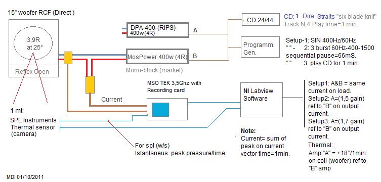

This is the test bed, we have equipped for these measures.
As soon as possible, put all the charts. and, reason becouse dpa-400 can increase the sound pressure at constant watts rms and speaker than another amp.

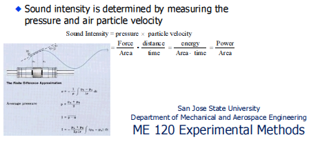

This diagram illustrates the relationship between the geometry of the electrical signal and the pressure / depresión produced. a signal very fast (if it is reproduced with the same speed) can produce high sound pressure levels peak. as in the case of the bass drum.

After the measures as the pic "Current Test", the error is impossible.
I mean: we sent a continuous signal at 60hz (SIN) in MosAmplifier adjusting the gain for a clip, we measure 58vP (this is our reference amp, with very big psu). we set the DPA-400 for the same value (identical).
that's ok. Now we change the signal pattern with triple-burst. repeat the steps for one minute (ref amp and DPA-400). output voltage in both the amp is the same but the dpa-400 increased the output current. at this point with some colleagues from the CNR, we have tried to study the phenomenon.
Increase in current is also testified by the increase in temperature on the woofers. also, that during test, when the burst was on the DPA-400, he was a very different sound. (MDI has set up this laboratory measures in an anechoic chamber).
I can confirm in this moment: the woofer impendance change when in acceleration. this is correct, the mass changes in relation to speed.
the speaker and bass reflex determines the pressure / depresion internal, this is a factor in the calculation of the dynamical mass.
End, not all amps can follow sequentially the speed of a sound envelope containing accelerations.
I wait all the curves to show the differences between a mospower 700w (2R) and our DPA-400 750W (2R).
I can not show a company name of mospower.it's a prestige model big case.

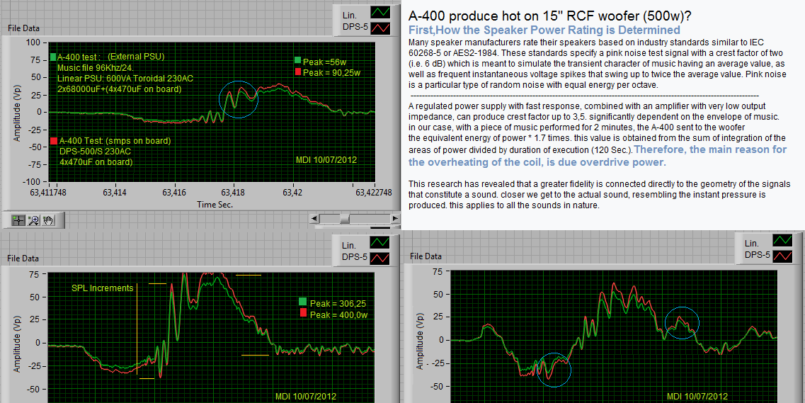

The tests have focused on psu (for heating of the coil of the woofer), this measure of piece of music has been performed by changing the type of power supply, on the same amp.
The graphics show a segment of the same captured file.
the probe was added to the amplifier output (resistive 8R).
The acquisition started with the trig. the start of the song, repeated by changing the power supply.
Internal: power supply of the A-400 integrated amplifier.
external: 600VA toroidal high flux, with 2x68000uF +4 x470uF and BYW29-200 fast diode (8x).
Only one comment:
During the sound, as opposed to as many people think, the difference increases in relation to the presence of the transient. (the faster the modulation of the current, the greater the drop in voltage). this means that the bulk capacitor on the power supply unregulated, does not do the work that we believe. completely changing the angle of the peaks, as you see also, regardless of whether the power is high, or in the range of 50w peak
Regards

in summary, we show that the drop voltage(on psu) does not have a relationship only with the loss of power.
the envelope is changed right where expresses the character of the musical instrument.
In fact, if we reproduce a sound very close to the geometric characteristics of the original envelope, we get an spl closer to the original instrument (with less power required), and obvius, in fidelity as the dynamics of musical instrument.
"Closer" mean that is not possible reproduces same spl of musical instrument's.(in relation to the same energy imprinted).
the first reason is phase of emission of the pressure/depression, plus inefficient transducer that is the loudspeaker.

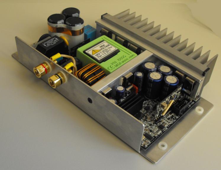

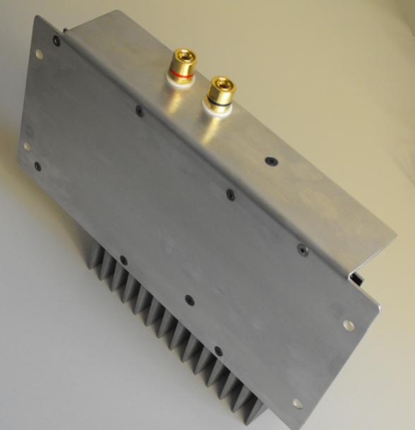

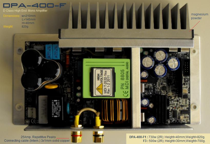

Hi, The DPA-400-F1 diy version.
Simple... ready and complete to drive a nice pair of full range speakers as Magneplanar or B & W or other models with reactive load between 2R to 2.7R without perceptible distortion or fatigue in the range of 200 to 730W output.
not only a transient, may exceed 730W with the APC system, this amplifier corrects in real time the power, even if the load at that instant is 1R, the output power remains 730W without additional thd. (this system is activated below 2R) This lets you hear is full and clean orchestral envelope.
(some musical instruments in the presence of crossover in the speaker, generate extra absorption, creating audible thd.
we usually we lower the volume in this case).
at end...this amplifier (after one year of testing) is also indestructible :)
P.S. this in photo is one for my lab, so not have label on alluminum frame.
Regards

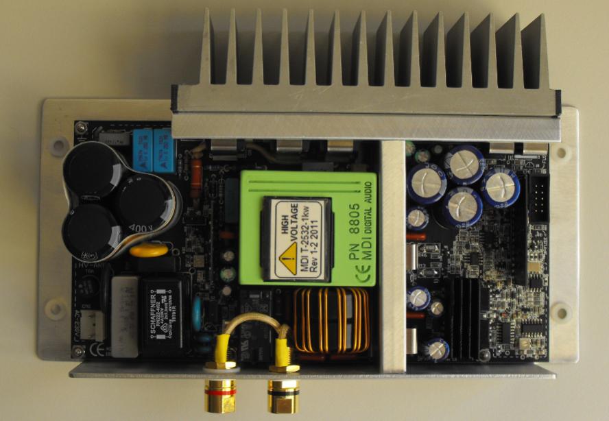

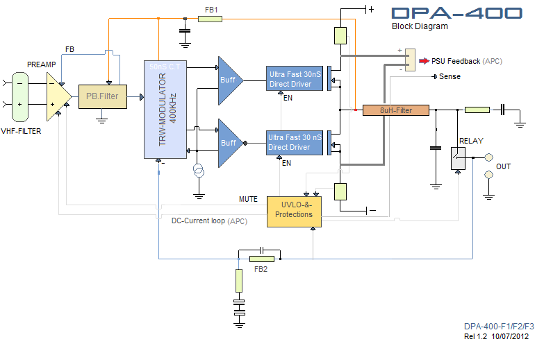

some additional info.
There are 3 versions with different setups (F1-F2-F3) with different prices.
This idea allows, according to use, better performance.
the smallest power is the DPA-400/F3.
F1-F3 are for audiophile use.
F2 is for guitar bass, sub, musical instruments with power output 600w(4R) . All model not need fan.
I'm sure I can say that in this moment, the DPA-400 is the only amp that can offer a dynamic uncompressed (or not adds compression to the input signal)
the acoustic power will seem like double (if the speaker holds up well) hehe!
Regards

Very interesting the F2 version (I'm a bassist).
But what is then the difference between the DPA-600 (already present at AudioPower) and this (new) DPA-400 if the F2 version is 600 Watt @ 4 ohm?
Roberto
Good question (already received from others via email).
The DPA-600, already offers new performances just used for bass guitar, as well as a high-definition (feels the touch of strings) just before the "big hit", which is very popular with bass players (in this amplifier is repeatable to each shot), this has been well studied and is a big difference compared to competitors. but .. Power Unit of DPA-600 requires a fan (although its speed rotation is controlled by the temp.), but for a few millimeters, does not allow the mounting 1U case.
second reason, the F2 has 30mm high, then it can be revolutionary (even with extension up to 750w) if mounted in a case very close to the size of the module.
AP perhaps have one project in mind at short. ;)
Also, this new versions have some special components oversized,so the price is also higher than the DPA-600.
