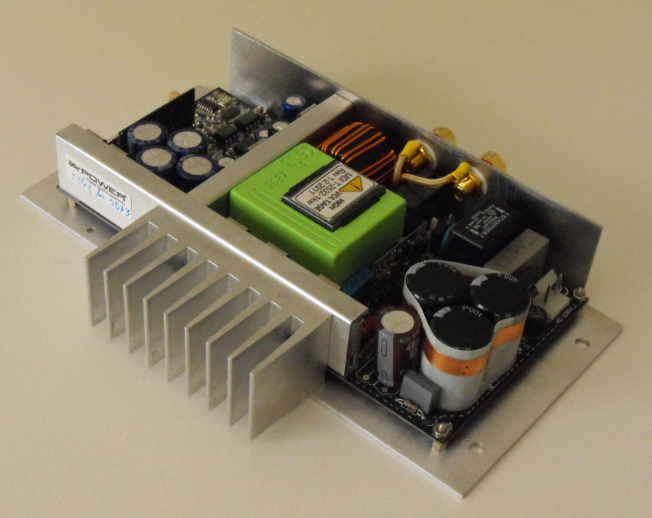

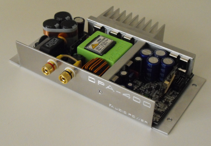

Heat sink changed (weight saved) after new study of thermal on "F3-version", stressing the amp on reactive load (2.7 R).
The new heat sink has the surface treated with magnesium powder, this treatment creates micro hollow increasing the radiating surface of 25%.
Regards
This is the current version released after 07/2012.
Regards
