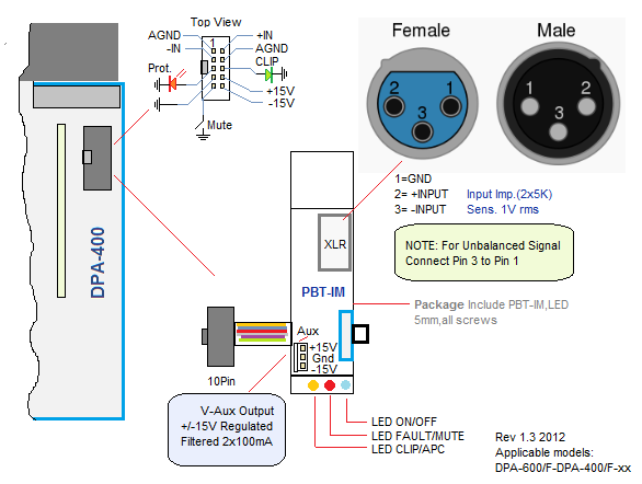

Thank's. Do you have the datasheet ready?
I apologize and take this opportunity to put this information on connecting to the connector 10Pin, maybe it can help you prepare for your connections. to complete the datasheet, I need this weekend.
some pasienza, I did not expect this huge demand, the next batch is already engaged. while waiting for the public review of F1.
the DPA-400/Fx allows you to use the 10Pin connector with flat cable up to 40cm in length, inside the case, with absolutely no noise.
this is ensured, not only by the shielding provided by the frame, but by a careful development of the signals in use, especially in the section. power supply.
I recommend not to remove the frame, the amplifier has passed the test of RFI / EMI, with the lowest emissions obtainable.
Regards

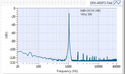

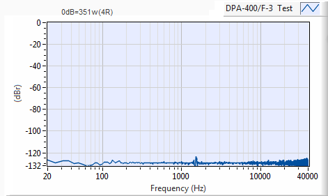

Hi, for now just a fft at 3w and 60w (4R).
DPA-400/F-3 connected direct on analyzer without filter.
Please, watch the segment 100Hz to 1kHz too.
without this cleaning harmonics, I can not put a smps in a good amplifier.
combined with the fast response, this amplifier is able to offer new performances, immediately listenable than another amplifier with smps, or linear power supply.
We have no doubt that this is a new real direction, instead of ultra low thd.
The audio system of perception (ears + brain) is very sensitive to the geometry of the sound. because we use it to recognize sounds.
If I add a lot of treble on the sound of the snare drum, I am not able to disguise, everyone recognizes the snare.
same if I add 1% thd. but if haughty the geometry of only 0.4%, we perceive immediately that the musical instrument is changed. the geometry of the envelope sound defines the dynamic structure and consequently, the harmonic content.
Everything is so clear and perfectly repeatable in the lab, I do not understand why so many still insist with the linear power supply without fast regulation.
The circuits that stabilize the working point (in AB class) or a pseudo PSRR in D class, are not designed to respond to changes in the transients, are designed for DC or vs. the temperature.
The smps integrated in this amplifier is unique in the world a this moment.
like it or not, this is a truth!
regards
