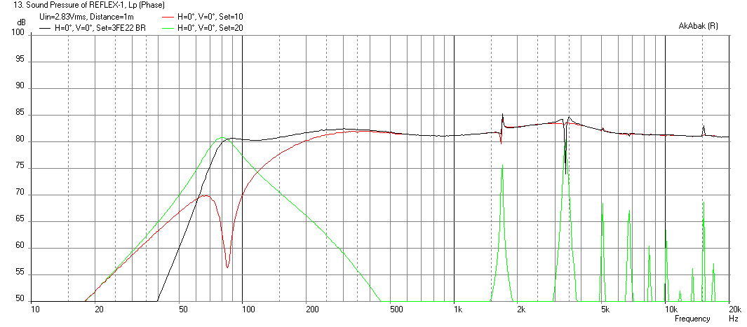

If you really want compact bass then, you need a different driver. A 2 liter bass reflex (0.7in dia x 1.75in long vent) can be had with a Faital Pro 3FE22 cabinet down to 75Hz. I have made such a box and used a 1mH and 6R BSC for a 4in wide baffle and down firing BR port. Very compact.
No picture to show though, but here is sim with diffraction and baffle step loss and correction but far from walls.
