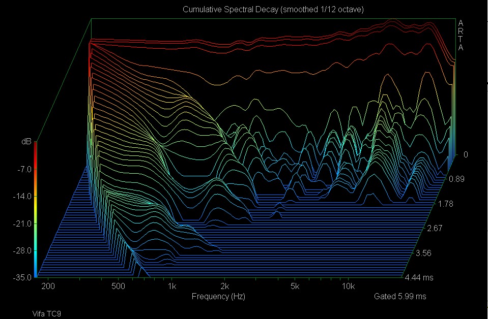

Measurements shown here and elsewhere suggest that the Vifa TC9FD18-08 currently seems to be the best bang for the buck. Far better performance than drivers that cost a lot more.

Like any small driver it starts to distort at low frequencies and is limited in output though.
