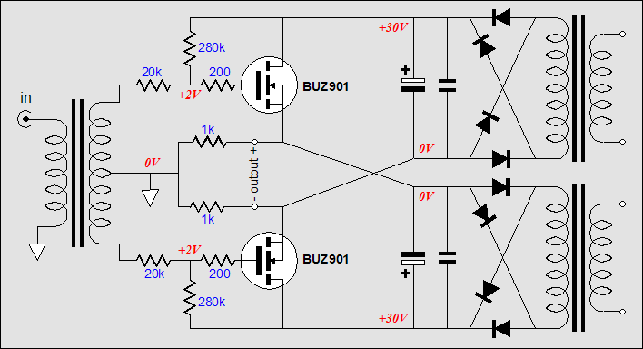

If I convert your topology into a OTL version, I will get a schematic (only buffer) from TCJ Blog 6

Circlotron Zeus
about
Circlotron Amplifiers Once Again
respective "simple circlotrom amplifier" about
MOSFET push-pull buffer/amplifier
Simple Circlotron Amplifier (and include front end (LTP/VAS) a schematic like this:
http://www.ne.jp/asahi/evo/amp/J200K1529/exp21.gif)
what are the pros and cons of both (i. e. with and without output transformer) from the audible view (not from the THD/IM measuring results) ??
BTW - here are to find more URL's with additional details arround CSPP/Circlotron topologies:
http://www.diyaudio.com/forums/soli...e-ended-related-solid-state-output-stage.html
http://www.diyaudio.com/forums/soli...better-audio-non-complements-audio-power.html
http://www.diyaudio.com/forums/soli...-names-commercial-solid-state-amplifiers.html
Yes, thanks for this one.
A few years ago I did do some circuit simulation of standard and Circlotron version Zeus power stage. Using the transformer of course.
Please accept my apologies if I am being slow however I don't see the point of the version as you show.
1. The two power supplies won't match unless you balance the caps carefully, so the PSU ripple won't cancel out as well.
2. The biasing arrangement won't track, may again add asymmetric ripple, and will result in poor HF bandwidth.
3. Big good quality electrolytic capacitors are fiendishly expensive, the cost of the power supply has just increased significantly (okay, you have got rid of the cost of the output transformer.)
4a. Using the output transformer one can absolutely guarantee that there is no possibility of ever putting any DC across the speaker.
4b. Also with the PP cancellation one CAN have quite high PSU ripple with little effect. Note that I happily run with only 10,000uF smoothing.
5. Why complicate?
6. Finally, using the Circlotron topology one halves the output swing.
7. Oh yes, there is no longer the output transformer to generate the "phantom" negative rail!
