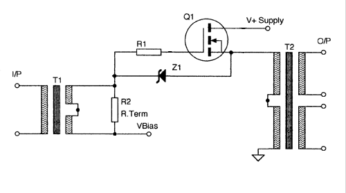

If you look at this, it's an input transformer set up as a voltage amplifier. It feeds a MOSFET set up as a Source Follower to provide current gain, the Source is loaded by the inductance of the output transformer which will give it good linearity. The output is taken from the output transformer so this is not a directly coupled output and you therefore you don't have to worry about dc offset or capacitors at the output.
Of course this isn't my amplifier so I could be wrong - at least I think I must be wrong because it looks as if the transformer must suffer the full dc current bias current flowing through the output MOSFET which means it can't be an ungapped transformer at the output - which was a benefit of the original balanced pp design.

You'll find this on Susan's site (link on first page of thread):
Zeus Amp - Schematics
The first circuit is temperature compensated by the Mosfet. You can use a different current source for this too. You could do something like is done with temperature compensation for a SS amp VAS.
The second circuit is not temperature compensated, but will shut down if it gets too hot (first will also).

Do you say, that this Vbias circuit put ca. 4-5 Vdc into the Gate through the secondary winding and thats all?
Yes.

Hi Joao,
To be biased, I think mine is better. But that is my preference and given that I have now been working on my transformer based follower amplification topology for the best part of two decades, probably my operant conditioning too.
Amongst other things in my topology the follower has below unity gain, therefore variations in load impedance etc. do not cause problems in the way a common source voltage amplifier does.
Also, unless one sets up as near identical circuits as possible, with mosfets, transformers and base topology (SE or PP) staying the same in both, one can't really make the absolute comparison between the two.
With mine, the low level "first watt" distortion is down at 0.005% THD for the whole amplifier i.e. pre and power stages (in 4:1 mode which is how I have my system setup). And that is without any global or local looped feedback, just the degenerative action of the followers.
Without naming names, someone who has been very active in the HiFi business (actually selling stuff for many years) told me recently that my system was the best solid state system he had ever heard. That was in his listening room, with his speakers, his normal CD player and his selection of music (although he did suffer to listen to a few of my fave tracks too).
Of course, this is all anecdotal, and at the end of the day the main attribute of any audio system is that you like to listen to it and can enjoy the music without being distracted by the sound quality or other artefacts.
