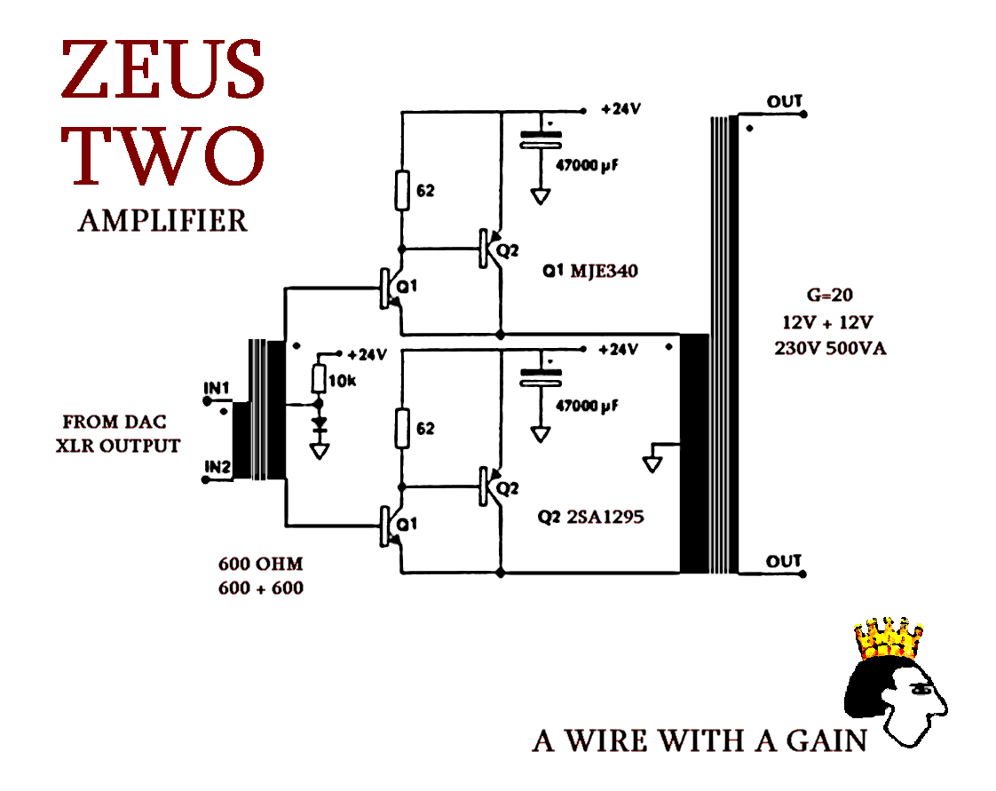

Design of Zeus Bi - two identical units with the exception of the output transformer. I leave open the input stage as I would like to use vacum for driver.
Susan's design uses the input transformer as a voltage amplifier and phase splitter. However, a low impedance source is required to reproduce low frequencies. Her line driver is a buffer. Do you intend to use the tube stage as a voltage amp into a transformer phase splitter?
Sheldon
the italian version
of Zeus:p
(CFP)

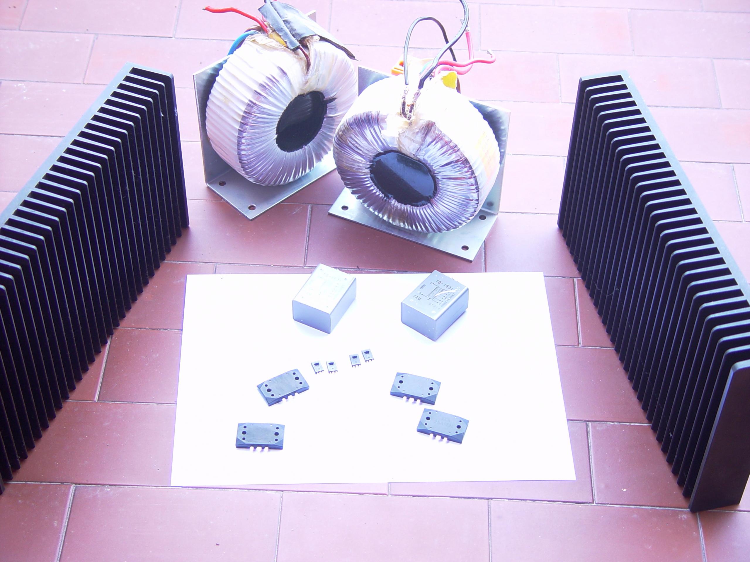

Hi Susan,
I copied the specifications of the 75W transformer from your website:
Electrical
Inductance of each winding = 99 mH @ 1 kHz, 468 mH @ 120 Hz.
Impedance of each winding = 3.9 KΩ @ 1 kHz, 1.25 KΩ @ 120 Hz.
Inductance between input and output windings (wired for use) = 2.68 H @ 1 kHz, 181 H @ 120 Hz.
Inter-winding capacitance between input and output windings (wired for use) = 9.34 nF
Windings to laminations/frame capacitance (wired for use) = 176 pF
Output impedance in PP NMOS circuit when powered = 0.94 Ω @ 1 kHz, 0.90 Ω @ 120 Hz.
Can you confirm the inductance 181H at 120Hz? I thought the inductance was less at lower frequency.
not yet
but today or tomorrow I will
because I have all the parts

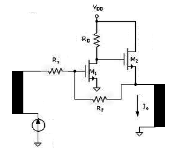

Steve CFP in essence, a high gain super transistor, somewhat similar to a Darlington. But there are major differences. Unlike Darlingtons, there is some voltage gain with Sziklais. Another unique feature is local feedback.
no news? have you built it?
unique feature? I wouldn't say so. Any follower configuration (such as the one used by Susan) does have plenty of it.
As for the next version, it does depart quite a bit from Susan's original idea, which is to get all the voltage gain only from transformers and use active devices (as followers) only for current (power) gain. Yet it may be worth trying. Let us know if you do.
BTW: I don't see it fair to call your variations ideas "Zeus n". The name "Zeus" referred to an audio amplifier is sort of a de-facto "trademark" of Susan. I think only she has the right to call "Zeus n" a variation/evolution of her own design.
Using the name "Zeus" as a form of "citation", together with something which makes it clear that it is a different, derived work may be acceptable (e.g. something like "Son of Zeus" or "CFP Zeus-like", etc). But "Zeus n" isn't. IMHO.

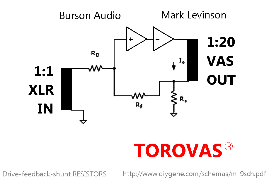

toroidal output as VAS stage
I found a way to equalize the response of the speaker
using the power consumption (shunt resistor)
and eliminating the need for cross-over:)
so speaker (16-18cm max) is not filtered
also uses a toroidal power
because transistors have hFE flexing
with increasing voltage
so are suitable to amplify only the current:rolleyes:
Note that the sum of the balanced input signals
is done with a transformer signal
and constitutes an important contribution to the realism of the scene:p
