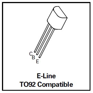

I've a question about Q5(ZTX450)what replacement can I use without changing values of other components but when it's needed what need to be changed?
Any small signal npn tr satisfying the followings is useful:
- The same leg marks (ref. to the attached figure)
- Max. Vceo rating greater than 30V
- Max. power dissipation rating greater than 600mW
- Min. dc current gain of 25 or greater (min hFE of ZTX450=100)
- Similar physical size as ZTX450
- The black-color body
I have used KSP42 with success.

Thanks for this information Babo. I always feel ripped of for whatever reason when I use ZTX450 and ZTX550, so if I can use 2N5088 (npn and fits all the criteria you mentioned) I'll try it.
ZTX450 is about 8-10x more money than the 2N5088 at digikey
