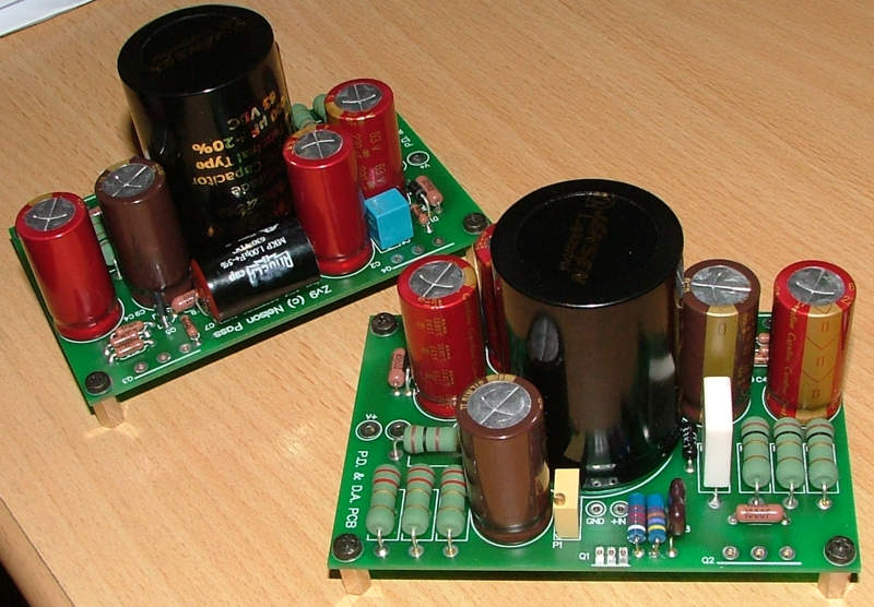

sts9fan said:
Can somebody explain C5 in the PS for me? I have the boards and all the parts but this cap does not seem to be on the schematic from veteran.
I found the cap in one part list from GEWA. It is not in Veteran's schematic, but on PS board there is a symbol of a cap on output side.
I used this because usually, in PS, there is always a small 0.1uF cap to filter hi-freq.

farl said:
Can i use 15000uf for C1 (output caps) instead of 10000uf. I have this one from my Marantz receiver power supply and I want to use it. It is Elna for audio 15000uf 63V.
I remember somebody have used 15.000uF.

meanman1964 said:
I've a question about Q5(ZTX450)what replacement can I use without changing values of other components but when it's needed what need to be changed?
Any small signal npn tr satisfying the followings is useful:
  • The same leg marks (ref. to the attached figure)
  • Max. Vceo rating greater than 30V
  • Max. power dissipation rating greater than 600mW
  • Min. dc current gain of 25 or greater (min hFE of ZTX450=100)
  • Similar physical size as ZTX450
  • The black-color body
I have used KSP42 with success.

Thanks for this information Babo. I always feel ripped of for whatever reason when I use ZTX450 and ZTX550, so if I can use 2N5088 (npn and fits all the criteria you mentioned) I'll try it.
ZTX450 is about 8-10x more money than the 2N5088 at digikey
