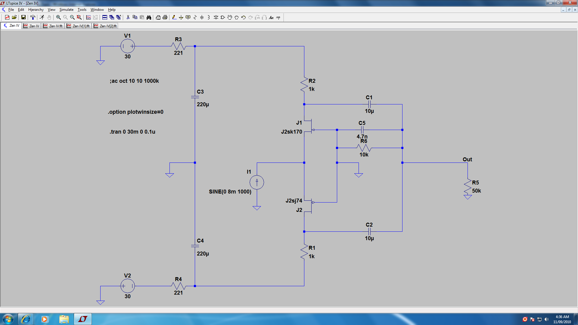

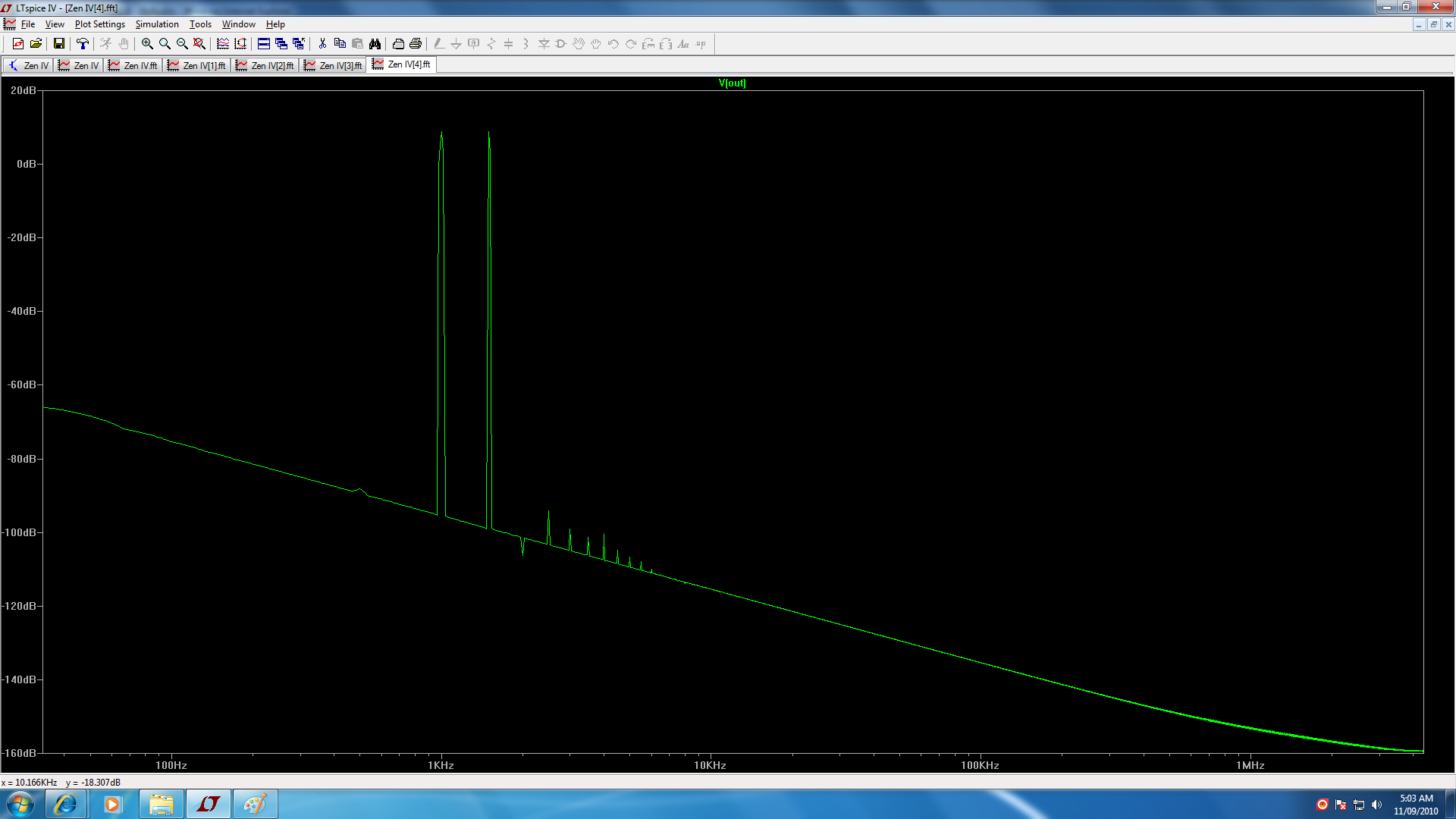

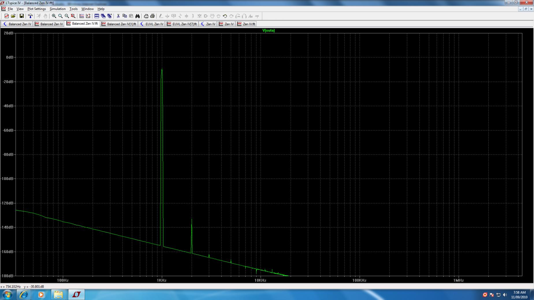

OK just to keep you happy.
Here is results of ZEN IV with 10k resistor and 4.7nF.

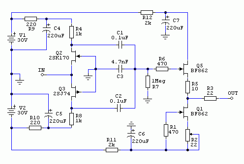

How about using 0.1uF instead of bulky 10uF? It's possible if the ZEN I/V is loaded by B1 running at approx. +/-10V (it's easy to scale down from +/-30V). Additional benefit is higher drive capability.
That is a quite good idea, juma!
I have a hypno board left (wise idea to buy some more).
How shall I do the down scaling? Just change the resistors for the same current as with 30V?
Greetings
Sam
...How shall I do the down scaling? ...
RC combo is the easiest way to do it (like R1/C1 or R2/C2 in ZEN I/V schematic). For example:
I make my buffers with BF862 running at 10mA. We want to loose 20V. So, we'll need 2k resistors rated at 0.5W at least. C member can be usual 220uF or less.
R2 sets the DC offset, buffer's Zout is approx. 50R. Schematic would look like this:

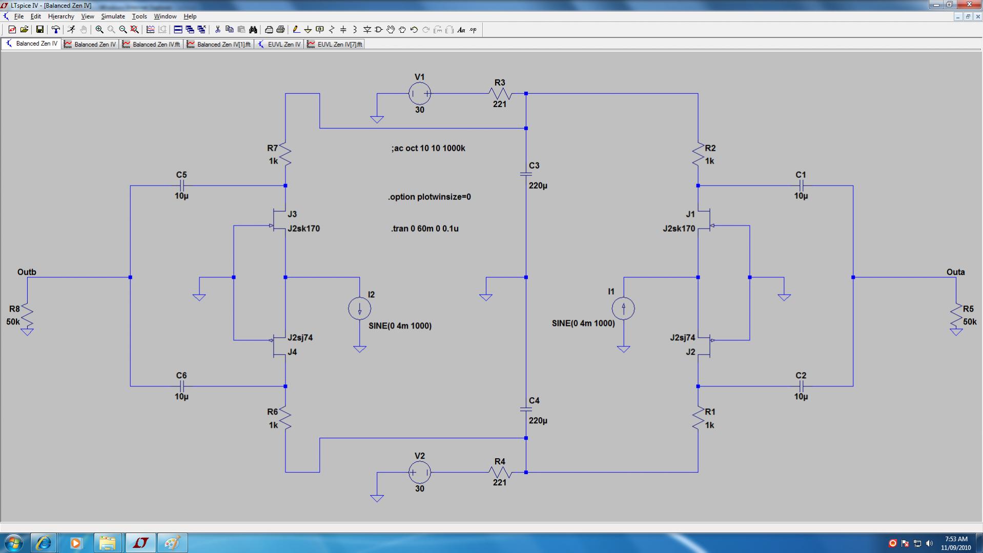

Problem with this is you would be stuck with balanced ouput and the input would require 2 extra DACs. R2R DAC chips aren't chip or easy to find these days.
I do not understand why extra DACs would be needed (did you mean 2 total, or 2 extra? 3?).
Current-output DAC chips often have two outputs; each is a complement of the other. When the sample bits are loaded for conversion, each bit switches a fixed current to one or the other output, and thus the total current through the chip remains constant - and that's much better than having the total current load on the supply change frequently.
In other words, with a complementary current-output DAC, only one chip is needed.

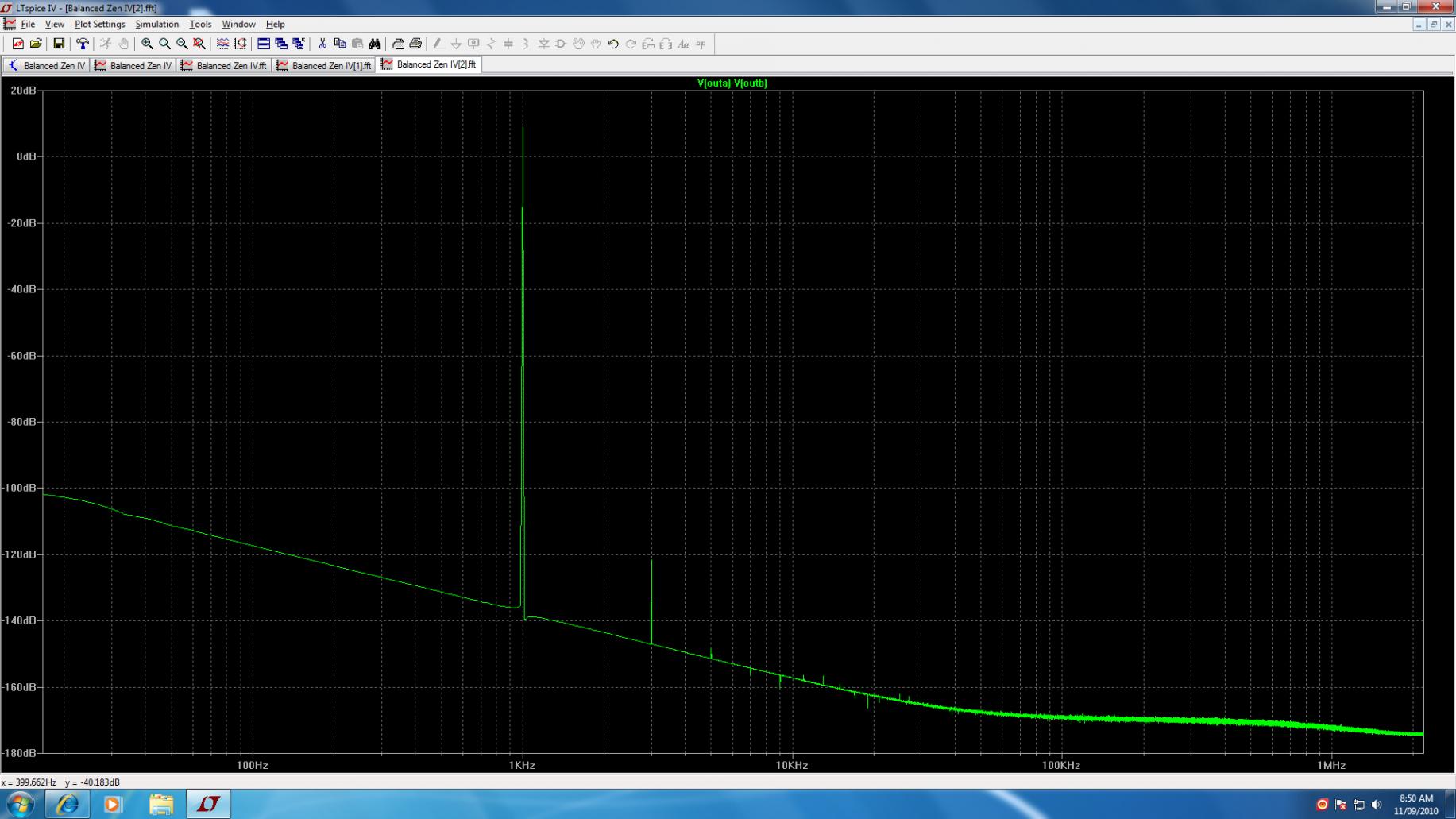

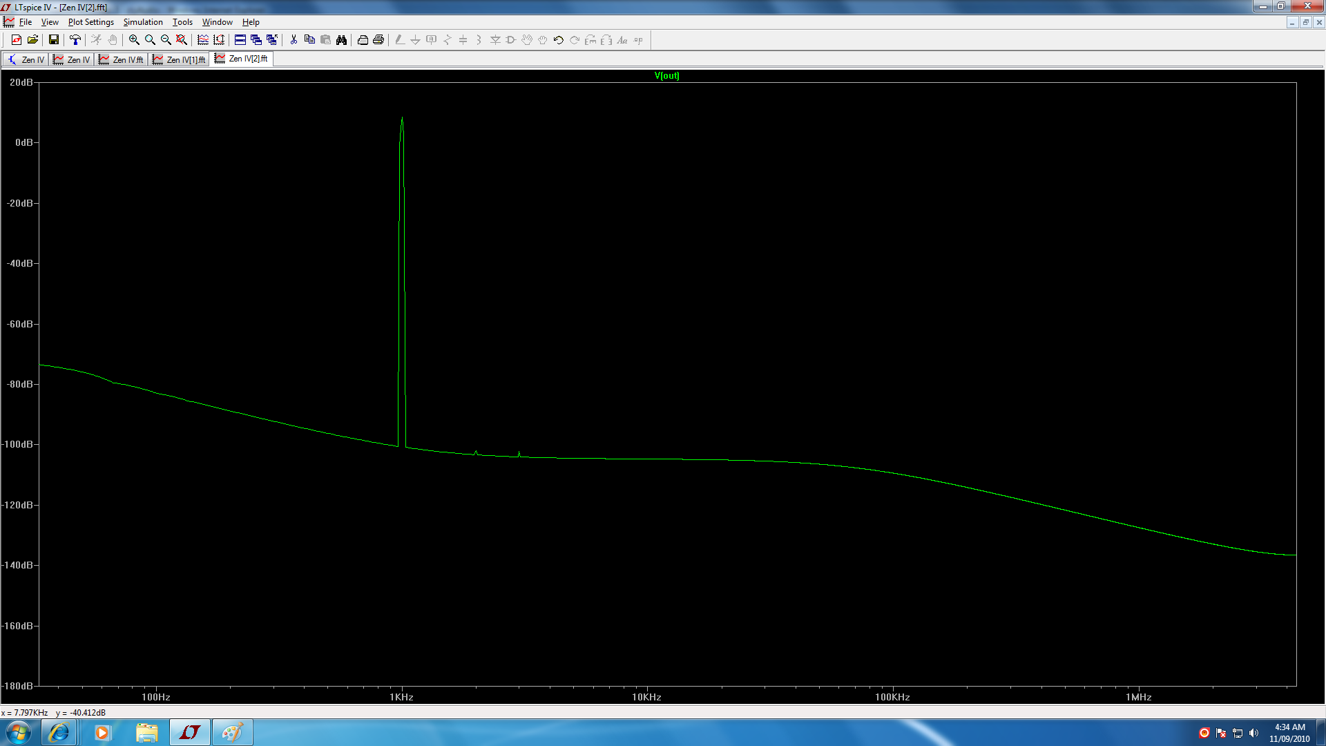

Thanks for the info, thanh1973. As I can see on your balanced model (the corrected version of THD), there is only about -130 dB (+10dB fundamental and -120 dB of 3rd harmonic), this data doesn't correspond to Mr. Pass's THD graph - the best result is at about 0.5V output with 0.0026% THD, while -130 dB is about 0.00003% THD.
AFAIK AP should not be a cause of such difference (x87).
Concerning the op amps - what is the difference between the discrete op amp and IC op amp, if the last one has been designed correctly?
