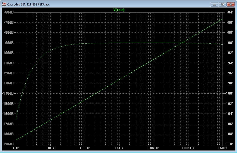

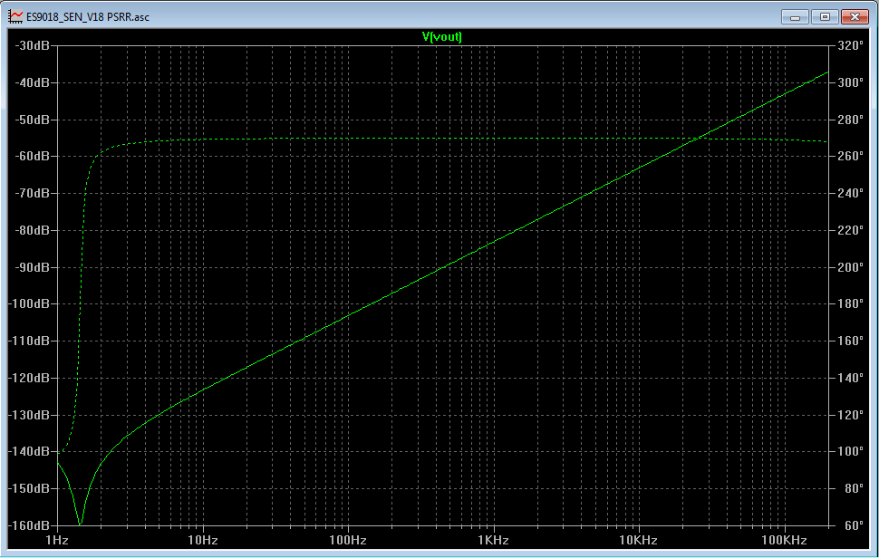

Elsewhere the SEN IV has been accused of having poor or no PSRR.
http://www.diyaudio.com/forums/digital-source/232940-pcm1704-nos-strange-clipping.html#post3431830
I wanted to find out for myself, so I did some quick simulation using my proven Spice models.
The input current was set to zero, and a 2V pk-pk noise voltage was added to the PSU.
The output is then plotted against frequency.
The first graph belongs to the SEN V18 for ES9018, using 2SK369Vs.
This is the worst of all variants, due to the higher capacitances of the 2SK369's.
Still, I personally would not consider -42dB at 100kHz to be poor PSRR.
The second graph belongs to the Cascoded SEN for PCM1704, using J111 cascoded BF862s.
I do not consider PSRR of -66dB at 1MHz to be any issue at all.
Most of your output noise will come from the digital noise of the DAC, not the IV PSU.
Unless of course you have really poor power supplies with huge ripples at HF.
Patrick

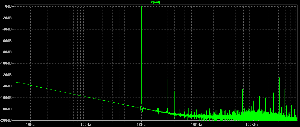

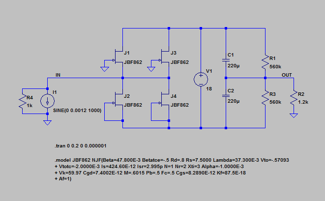

Hello,
sorry to hijack this thread, but i had a quick question. I've simulated the SEN with paralleled BF862's, results are attached. I thought distortion would be lower. Could please somebody check if I've done something wrong?
Thanks,
Peter

Thanks for your quick reply.
Without R4, the distortion levels are slightly better. Would it mean that the SEN does not like the PCM1704's lowish output impedance? The CEN with SK170/SJ74 sims way better.
Peter
PS: Forgot to mention that cascoding didn't help with R4 present.
For good sim results, try #1375 with more parallel pairs to get the input impedance down. Not sure if anyone has actually listened to #1375 working though...
