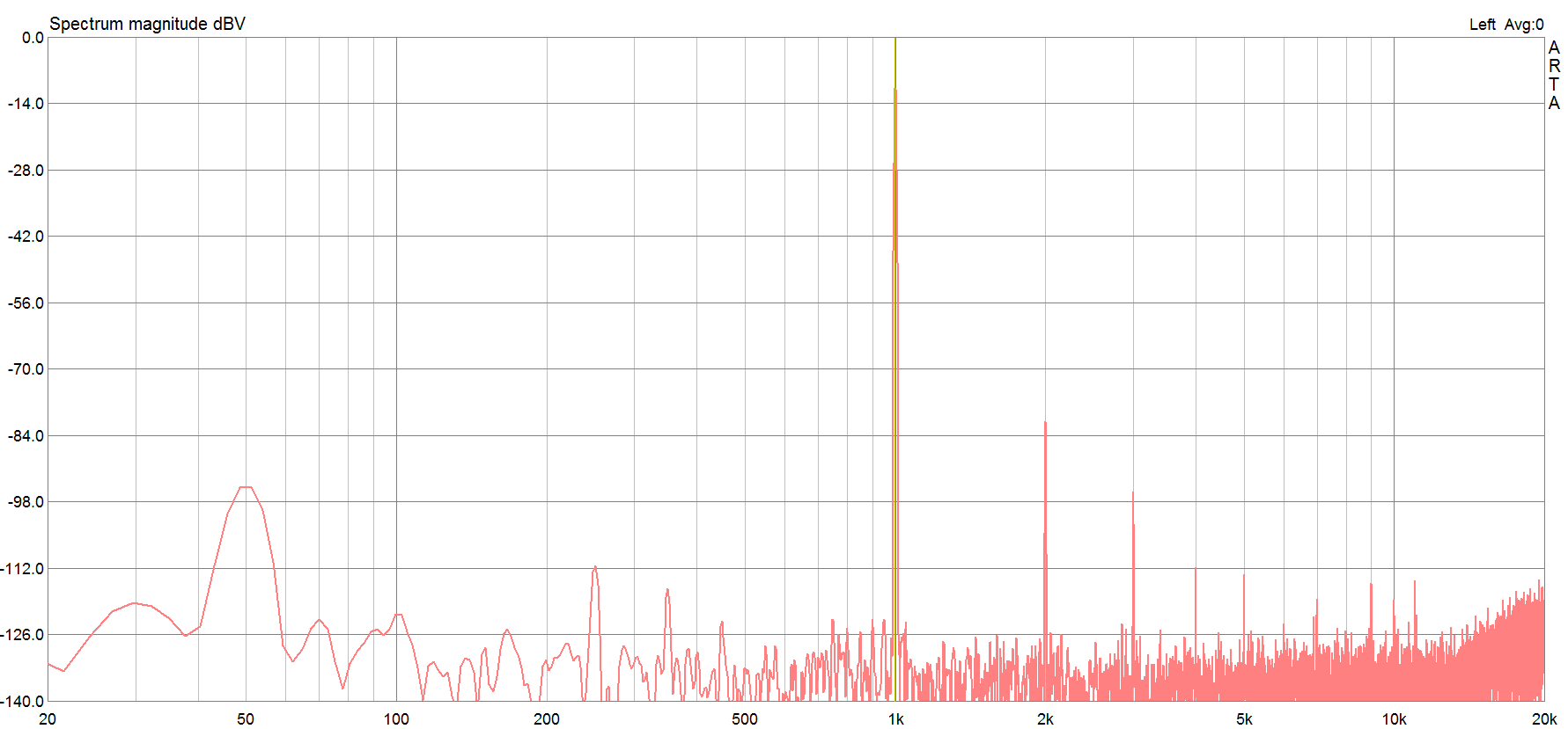

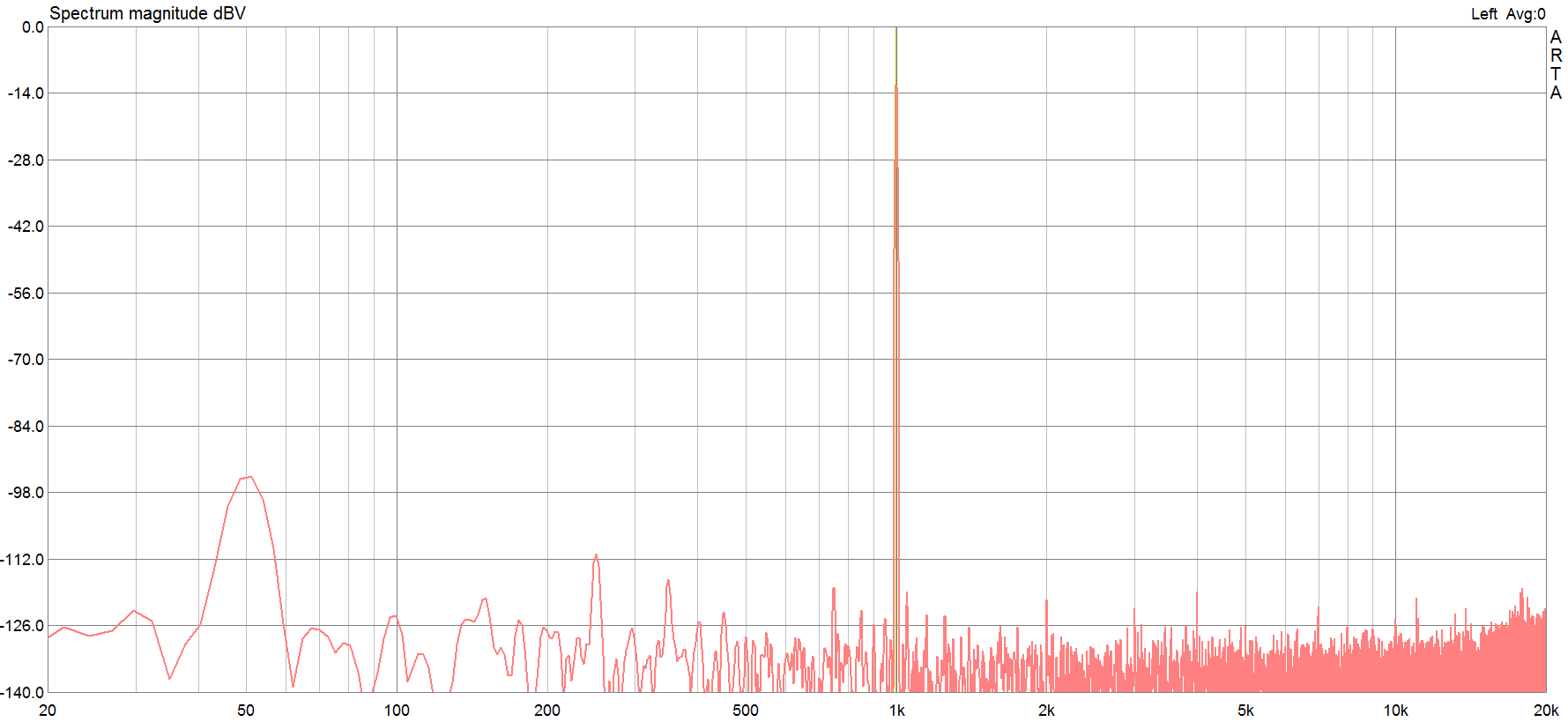

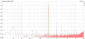

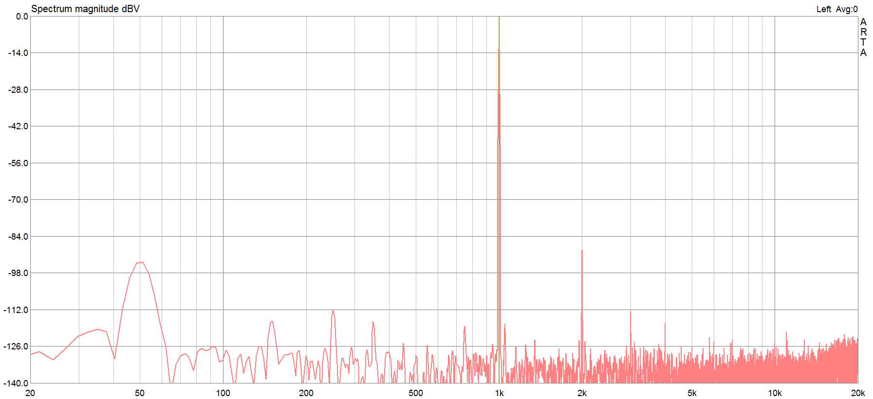

Here are my quick measurements, sorry for the noise and hum. From left to right: Cen (2SK170 and 2SJ74), Sen (paralleled 2SK170's), Sen (paralleled BF862's).
Cen has vanishingly low distortion, it clearly beats the Zen I had before.
Somehow I didn't have any luck with the Sen. With 2SK170's its not that bad, but with BF862's the harmonics above 2nd rise remarkably. Maybe the parts aren't matched tight enough, or I've done something wrong. Could somebody help me with this?
I would happily buy a kit with matched fets, if there is any available. Maybe it would work better.
Peter

Your measurements do not totally disagree with ours.
CEN is push-pull, and have some even harmonic cancellation.
But SEN has 2nd harmonics below -90dB, and what I call a health distribution down to 5th to give good sound.
I personally would be very happy with it as is.
If you want to chase numbers, then try cascoded SEN.
We can only support SEN V18 right now with matched 2SK369Vs.
I am not sure whether it will give you even better numbers than paralleled 2SK170s for you application.
Suggest you try to get 2SJ74 / 2SK170 matched sets from Spencer.
Do some listening first ?
Patrick

If the devices are badly matched or you have any DC out of the DAC then you will see higher distortion. Also if you have high frequency oscillation (but that looks different from your current results).
Assuming your signal is where it seems to be at about -14dB and not actually at 0dB then the -84dB mains hum you have is not a good result. Also there seems to be quite a lot of high frequency noise in there too - certainly the 3rd picture has higher noise than the first two which wouldn't be the case if it were an artifact of the measurement.
On batteries you can get hum down below -110dB for single ended Sen and -125dB for balanced.
Some of my earlier measurements looked a bit like yours with mains hum and high frequency noise before I eliminated all the ground loops.
How have you wired up the L+R channel input and output signal and grounds? Also, how are you doing the measurement?

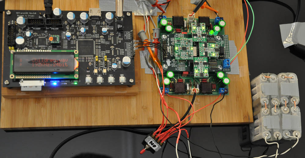

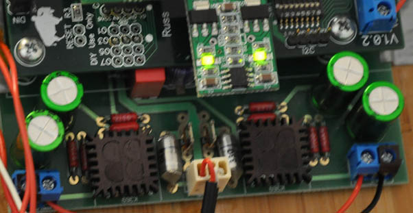

First and foremost...a huge thank you to Patrick.
This is a gorgeous IV ...never had such crystal clear, dynamic sound..across whole spectrum...great defined bass, voices...highlevel details...the whole package.
I can...almost have to enjoy the music and forget looking for what else to work on....
SEN is running on 16 AAA enoloops per QUAD...sucking about 37mA bias and running at a shade under 50ºC each heatsink after 2 hours playing.
DC offset was trimmed to around 1 mA stable temp.
Running with SDTRANS - UGS - F5.
Testing tomorrow with my BJ2. :).
Gorgeous....build one !
CeeVee,
Many congratulations with a truely DIY build (including own PCB).
And glad you like the results.
If you would ever consider another build, I still advice you to move the IV away from the digital circuit.
Physical separations of 50mm or more is no issue as the DAC is current out.
Try it once to convince yourself.
50°C is OK for the sinks, as their main purpose is thermal tracking.
If you would want lower temperature, just increase sink thickness.
But I personally am quick happy with 50°C.
As to the Cascode SEN, it will be realised once we finish the ES9018 DAC.
So please be patient. It is also only a hobby for us, as it is for you.
Patrick

CeeVee,
Thanks Patrick,
This is quick and dirty first try setup.
Even so it is highly rewarding.
This is proto...now that it works and certainly deserves my utmost effort for final version I'll design another PCB taking separation of digital and analog into account , with physical separate compartments in case.
...but now i can do this while listening to gorgeous music ....:D
...and keep working on my other main project ;)
Do have one problem though...since i don't have any more 2SK369Vs ( this matched set was all i had ) I'll use 2SK372Vs in next build, heatsink must be a bit bigger though since power handling is smaller with these.
