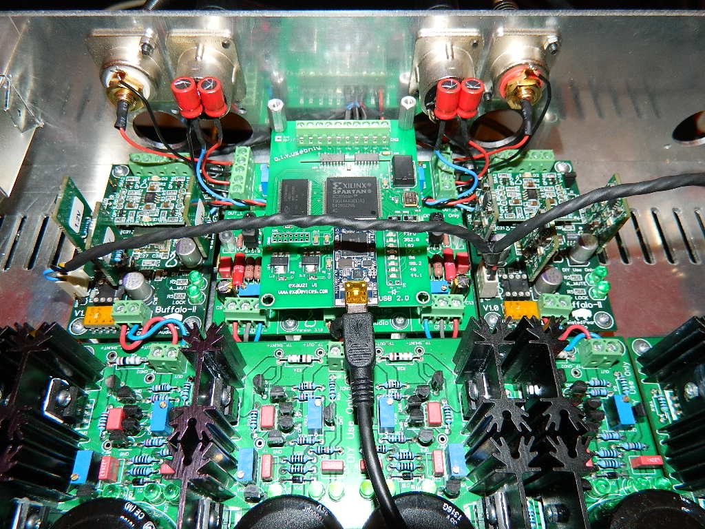

Time for a little update.
I have now listened to the SEN with the ES9018 for about a week (a few hours per day) and I am truly impressed. The SEN will stay.
To put it very simply it is as if a bottleneck has been removed from my system - a bottleneck I never new was there
I find myself listening at lower levels now as if a "loudness" button had been pushed. This actually comes together with a clearly expanded dynamic range and frequency extension so it is all positive. I have lately blamed my speakers for being a bit shy in the bass domain, but with the SEN it looks like I just lost an excuse for buying/making new ones
Deep, fast and precise.
The sound is beautiful with voices and the tonal balance is great.
The only area where I am not yet completely convinced is the treble. It does seem just a tiny bit harsh to me. I have the feeling that this depends on the quality of the recordings, but I need more listening to confirm this. I may also try filtering the SEN output a bit more.
I'm currently using the SEN with a modified Buffalo II directly into a set of UcD180HG HxR monoblocks (with regulated supplies) and my French Apertura ALTRA speakers. Attenuation in the digital domain ("volumite").
I look forward to a serious upgrade of the power amp

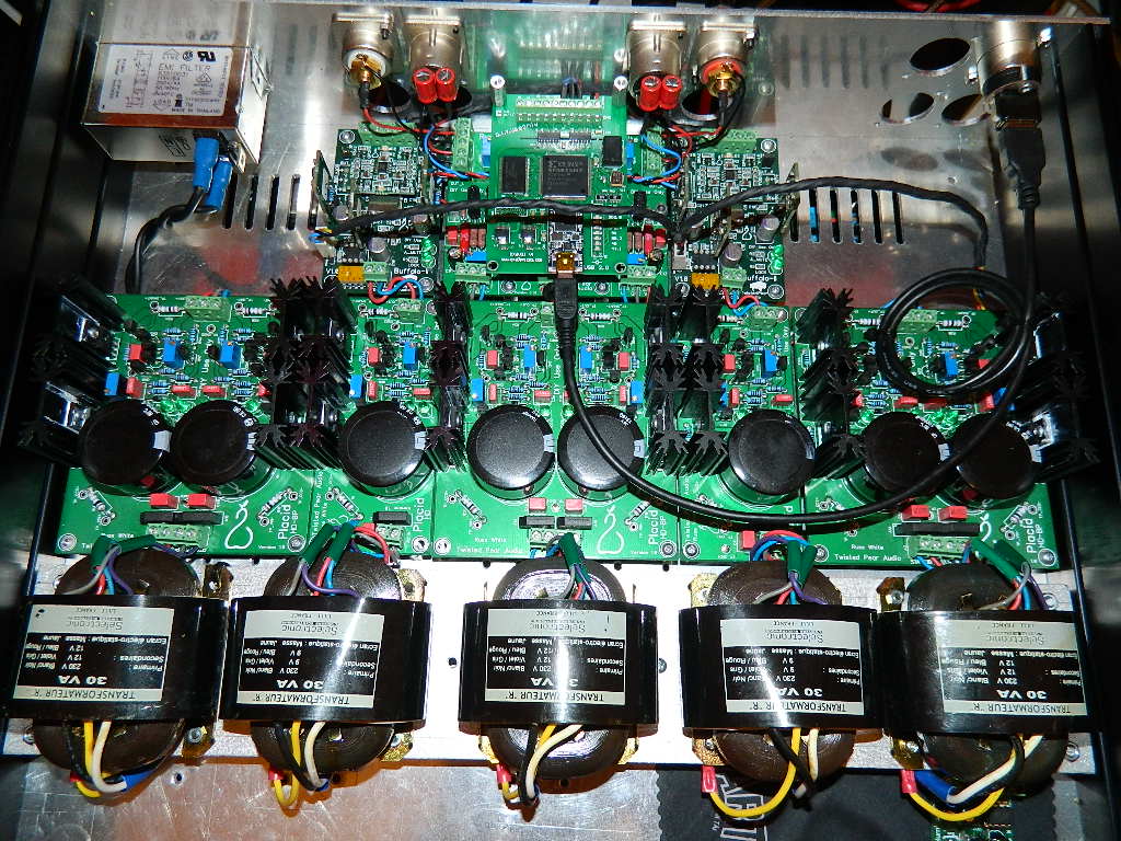

Initially, when cranking up the volume without music playing, I realized that I was having some kind of low-frequency hum resembling ground loop noise. As grounding is something I have been very careful about I was quite puzzled where I was getting that noise from
As I could certainly not exclude magnetic coupling (one transformer with a single primary) I decided to do as Patrick suggested from day one - use batteries!
I got a bunch of alkaline 9V batteries and the problem was completely solved! The only issue is that it sounds horrible when the batteries run out of juice.....
As I have plenty of power sources in the build I will try NiMH batteries and I may even end up using batteries and regulators. Or maybe separate R-core transformers for each channel.
Before I find the final home for the SEN, I will play a bit with the circuit and see if I can locate any new bottlenecks. A nice thing about these circuits is their extreme simplicity and thus a limited number of components to tweak
I will maybe also try out the CEN in a similar configuration.
Those of you who have the V18 evaluation kit lying around should really try it out. Highly recommended!
