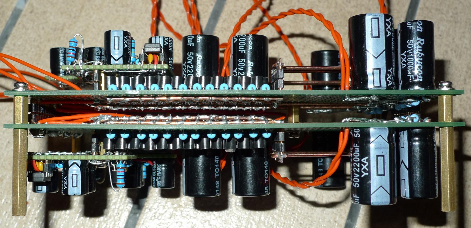

He is probably using 12 pairs 2SKq170 per single ended SEN.
And of course not my PCB, no heatsinks, .... etc.

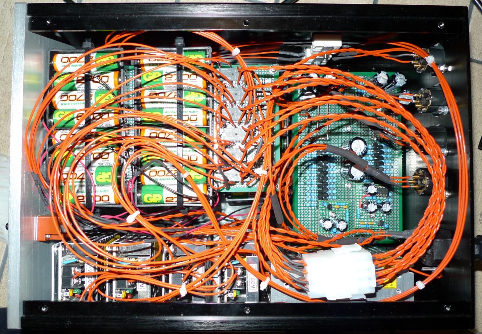

I don't think my jfets are matched well enough for heatsinks to make a difference. I tried pretty hard this time and let them reach their operating temperature when matching them but the ambient temperature varied by 10C during the process and none of the results were repeatable. I think I'd have to try again and attach each one to something that was thermostatically controlled. Is there an easy way to match up sets of jfets properly?

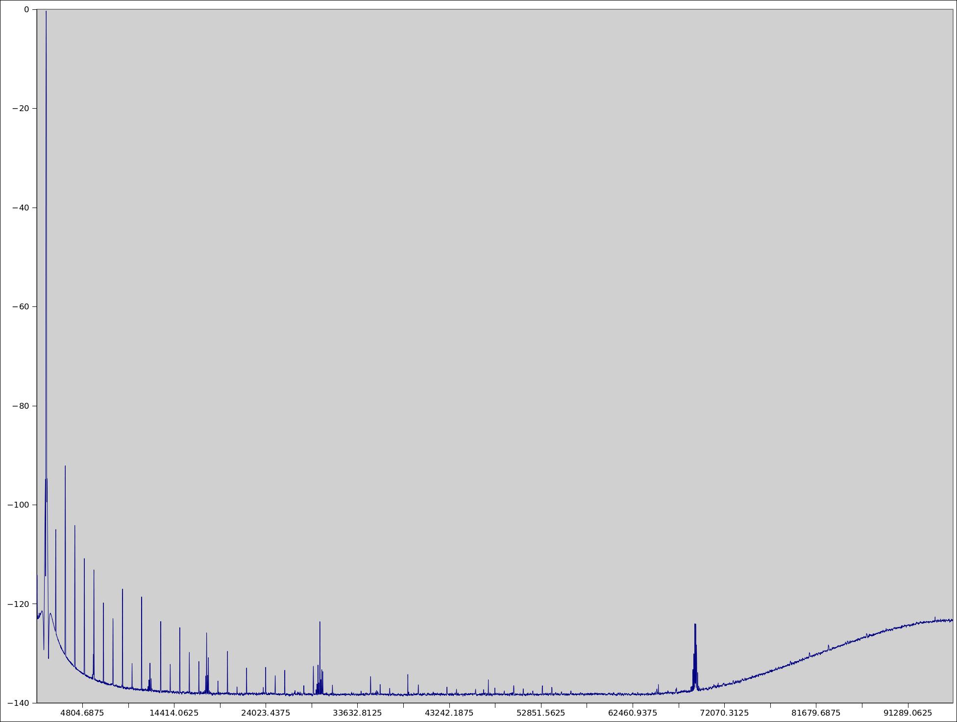

On the breadboard, I measured SENs with 4,5,6,9 and 12 pairs of unmatched jfets. For my circuit under test where I was using 2 servos, 2nd harmonic distortion went down with increasing numbers, 3rd went up a bit and there was a significant reduction in higher order distortion with 6 or more pairs (maybe an artifact of the 2nd servo). Adding more pairs seemed to increase noise but I thought this may have been from extra wires on the breadboard. For my circuit and my DAC, the sweet spot is somewhere between 6 and 12 pairs depending on preference for 2nd or 3rd harmonic distortion.
I wasn't able to get good enough measurements on the breadboard so I had to build it in a box and retest to see proper results.
I have reduced Riv which increases the noise floor in the measurements (maybe because of the limit of the ADC). I wasn't able to see this on the breadboard. I think I'm going to increase it again.
My jfets are only just about matched at 12 pairs. I haven't made the second servos yet - there are sockets on the board for them with copper across at the moment - when the second servos are working, I can snip off pairs of jfets and measure each time until the 2nd harmonic is just above the 3rd which I understand is what I should be aiming at.
The wires are long to allow me to open the box up flat without unsoldering anything. I avoided cable tying the ones from the floating power supplies together to reduce capacitive coupling between them. There isn't a lot of noise from the mains (-120dB haven't grounded the shields yet) and it looks neat enough with the lid on so the wires will probably stay as they are. I guess I should check channel separation though.
Have you got any measurements with a real DAC and a lower noise floor which show the distortion profile of your version on a proper PCB? It would be nice to see whether or not the higher order distortion is present.

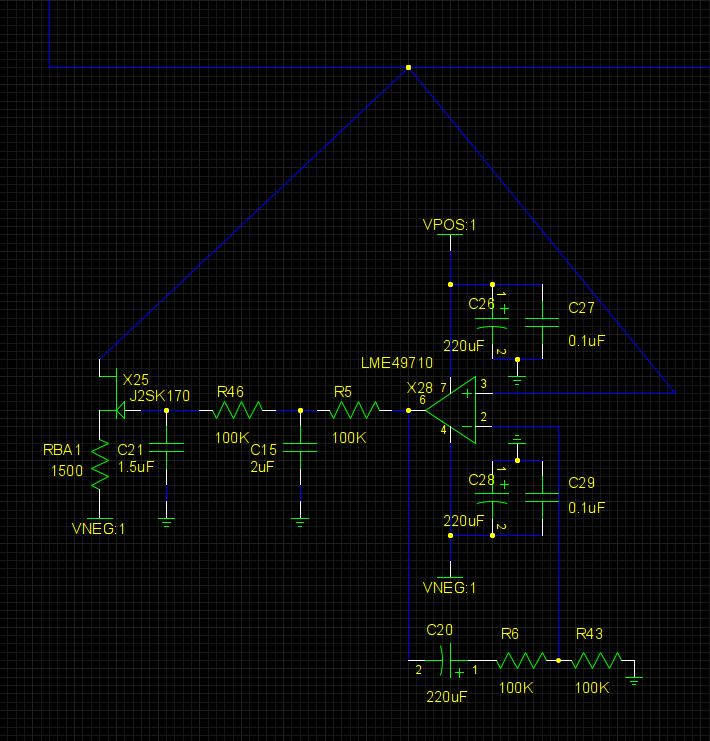

Hi Heb, sorry to be persistent on this, i'm just trying to understand.
I'm pretty sure, having made Sen work with 1794 and a negative bias supply voltage that the bias current is 6.2mA flowing out of the DAC chip.
Besides your servo schematic, do you have a schematic that you've tried as in such configuration?
I was pretty sure that the PCM1792/4 was designed to sink current and not source it.
If you look at the table on page 25 of the PCM1794 data sheet you'll see that VOUTN - the output of U1 in Figure 24 is -4.65V at the center of the DAC output when the current is 6.2mA.
The DAC output is connected to the inverting input of the op-amp U1. If the output of U1 is negative and the inverting input is close to ground then the current must be flowing through R1 out of the DAC from left to right.
Why do you think it was designed to sink current?
I only have schematics with servos. The servo below is the one I used for the results I posted most recently. I used it with 8 NiMH AA cells (9.8V?) for + and - supplies and I used a 1200R resistor. I have shown 1500R for +-12V supplies which I think will probably also work. It takes a few minutes to settle.
I don't know if the op-amp decoupling is as good as it could be and I don't know if the filter caps should be connected to ground as shown or to the negative supply for the best results.
The blue line at the top is the DAC output.
You can look at the measured results I posted and see some distortion that may be the result of this servo. If you improve it, please let me know.
I'm a complete amateur - you have been warned - so don't complain if it blows up your DAC.

You're quite right about this. A bit of a misunderstanding..
Out of curiosity why are you using servos and not a simple ccs?
I want to try to get better measured results than my op amp IV and I thought that a servo would get closer than I could adjust manually. Also my listening room temperature is very variable and the earlier posts were talking about using thermistors to stabilize the example current sink circuits against thermal drift which put me off using them.
