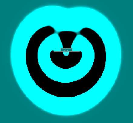

When i look at my OX plots on a string at 10kHz the energy is already down 12dB at 90°.

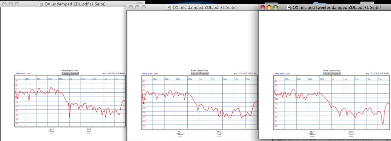

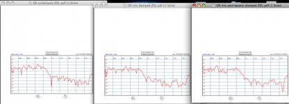

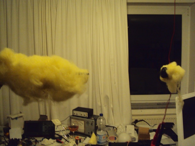

I have now measured the OX tweeter on a string without damping, with mic damping and with mic damping plus tweeter damping in the back. As expected, the frequency responses look very similiar, the red one ( both damped ) shows the least "rippleness" but not much.
You have to look carefull. This time i put the mic a bit closer at 25cm from the tweeter.
The Power Cepstrum reveils more. Most profitable is to damp the mic. The tweeter damped on the back again does a very slight improvent but i do not know if this is audible and it is only measured on axis. Maybe i have to do more damping in the back to avoid the roudabout effect ( i like that phrase, do you ? ).
