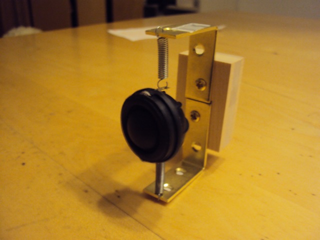

I build a little jig to measure the tweeters "open air". The tweeters i chose are the Vifa OX20SC00-04.

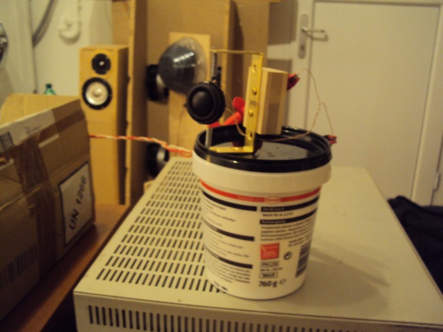

Today i measured the tweeter on and off axis. This does not look as pretty as your wavelet graph ( i mean in the aestetic sense ) and is presented in the traditional way at 0°, 30° and 60°. The jig and the surrounding material is not optimised in any way. I just used what i could find in the lab but i think from 2.5kHz up it does not look too bad. The on axis response has a slight up tilt and there is a shallow hole from 2.5kHz down and in the deeper regions the sound preasure recovers somewhat. Measured from 30° the balance is nearly flat and well extended and from 60° the sound drops over 15kHz. This is much more offf axis energy then the usual 1" dome on a wide baffle so it fullfills one of my goals. Sensitivity is around 90dB and that fits well to the midranges i elected to use. The well know Scan Speak 10cm wideband that i also use successfully in my Mini MPL but without tweeter there. You can download the specs here :
http://www.scan-speak.dk/datasheet/pdf/10f-4424g00.pdf
The impedance curve of the tweeter shows a surprisingly low fundamental resonance at 1.1kHz for something so small. No ferrofluid is used i asume and there must be some impedance control ring or cap fittet because the impedance shows no tendency to rise in the treble.
Tomorrow i will measure distortion and look if those details have any advantage besides extending the response in the higher and deeper ranges. I have a conventional SEAS 19mm tweeter that i will use to compare. That one has ferrofluid, no control ring and a traditional ferrite magnet.

Sy, i was surpised too but it may be responsible for the "hole" i experience under 2.5kHz.
The wavelength there is around 20cm so the sound travels to the bucket and comes back partly out of phase. Higher frequencies are not affected as much i think. I may put the tweeter in a nylon ball i have and may or may not damp it on the back to avoid the "roundabout problem" ( that was really new information for me ).
