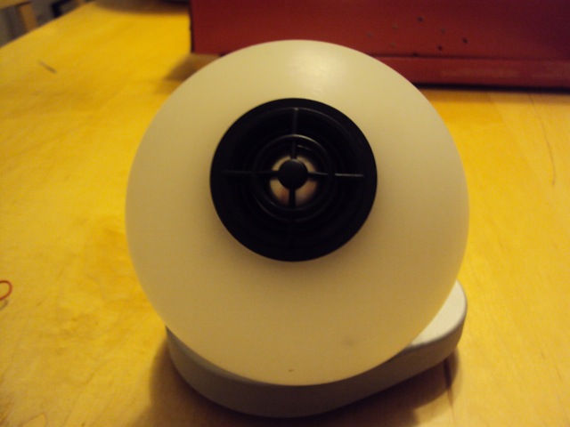

DT, i will place the crossover from woofer to midrange at around 250 Hz, maybe lower.
I have to check if the midrange gives up before the woofer. Frequencies at that point are more then a meter long so i think i can build the woofer box rather conventionally.
As i have shown in a picture i plan to place the tweeter as is on a nylon ball that contains the midrange. The midrange in the nylon ball will maybe angled so that we hear that driver from slightly off axis. It also will allow matching of arrivel time with the tweeter.
I plan to use as little damping on the outside of the box as posible. Maybe a blanket under the tweeter will do. The reason i do not like damping the outside much is the loss of energy we will get and also it is hard to find a damping material that is linear over frequency so we may get some iregularities off axis even if the response on axis looks fine.

I will build the midrange in a Nylon sphere.
