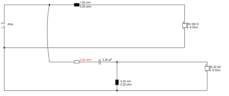

Perhaps I can just repost my thoughts on this problematic Zaph 2.5 way:
The scanspeak 18W/8531-G00 woofer is extremely difficult.
And the simplistic Zaph 2.5 way is what Lynn calls a LGWAG speaker which distorts complex music. You really must read Lynn's thoughts on this. I've certainly found it to be true when using simple filters at lower crossover point.
What Lynn is saying is that distortion is the great enemy with low-order filters. TBH, I always hear some good in them. A lively acoustic. But after an hour of listening, my ears pick up distortion.

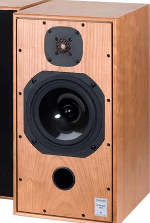

Just for completeness, let me recommend this Harbeth C7ES-3 design with a complex3rd/4th order filter as being a good way to do things. Metal dome, well-behaved 8 inch polycone bass, damped ply cabinet and doubtless negative polarity employed at around 3kHz. Classic BBC design by Alan Shaw. And for sure, a much easier woofer than the Scan 18W/8531-G00.
People who've suggested a three way might solve this are dead on the money, IMO.

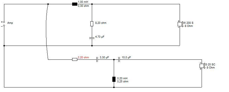

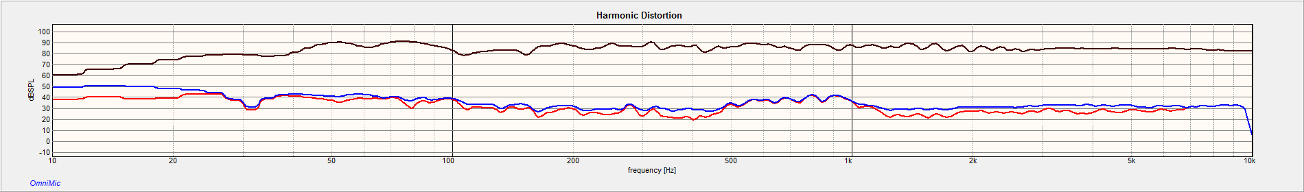

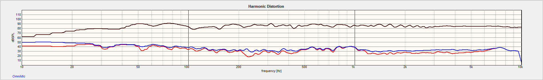

I don't think tweeter distortion is the problem here. The Scan-Speak 6600 AirCirc is a $200 high end product and is capable to handle a low crossover frequency.
The woofer (Scan-Speak 18W/8531G00) is more problematic IMO. It does indeed have elevated 2nd harmonic distortions in the range from 500 to 1000 Hz. Both German loudspeaker magazines show a distortion level around 1% at 90 dB and Merlin's own measurements also show an increase of 10 dB:
I assume that's the coloration Troels Gravesen describes and that's what bothers the OP. Unfortunately there's no cure for driver inherent distortions (except exchanging the drivers). No crossover modification will really help.

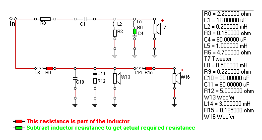

I am dubious whether this whole Zaph Revelator 2.5 way is fixable.
Zaph|Audio - ZRT - Revelator Tower
This may not be how I would choose to do things, but for sure, the Ekta Grande holds out hope for improvement.
Terrible low impedance, IMO. But we just do our best.
^^That range of higher distortion matches with baffle step in many cases. Zaph shows in-box measurements with xo and we see nice slopes of two drivers in .5 config. Thus we can expect problematic distortion only with extreme spl. Same goes for the tweeter.

IMO, the problem here is frequency response based. It may look good in a scale covering 60-80 dB but it only takes small amounts of emphasis to really ruin the balance. In my experience, I have to get the response within 0.5 dB of "correct" throughout the band to really sound great.
