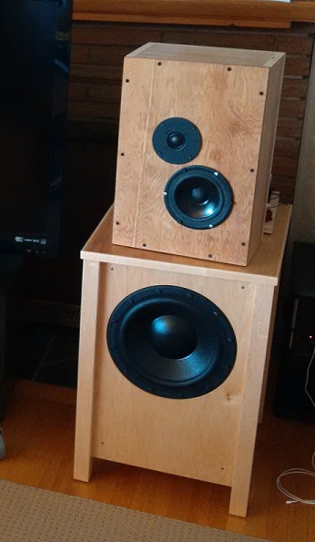

I'm not sure if this helps but since the start of this thread I have put aside my ZRT2.0's and replaced them with 3-ways constructed of parts I had on hand.
With the ZRT's I could only play them equal to a loud level of conversion before a bit of distortion started creeping in. The 3-ways play much louder. I always thought it was my amp. Probably I am also overly picky and I usually just play at low volume.
The 3-way has a HiVi W10 woofer; Seas CA15RLY; and Seas 27TDFC crossed over at about 600Hz and at 5000kHz (a bit high but limited by my stock of crossover parts). All slopes except one are 2nd order electrical. Need to order some parts!
If your ZRT2.5's do not pan out I highly recommend attempting a 3 way. It was not as hard as I imagined it to be.

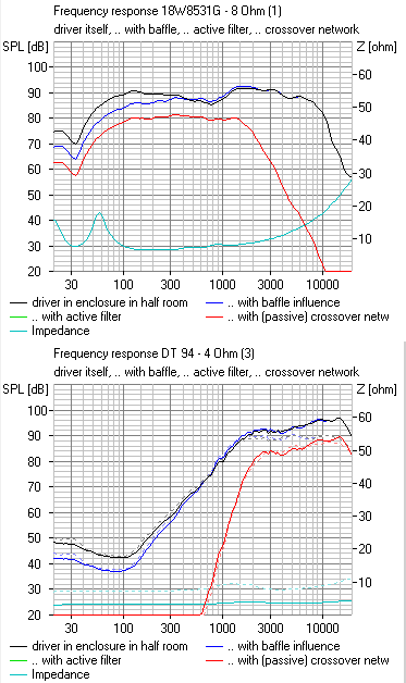

Here for the interested student are the FRD and ZMA files for the 18W/8531G00 which look quite reasonable to me.
I can't swear to this, but I believe they come from no less than John Krutke himself.
From what I can see, Visaton Boxsim, which I am using, finds a good correlation between reality and the Zaph measurements.
The impedance and shallow rolloff are the things that need improving IMO. And this is what I have addressed. Whether it's enough, remains to be seen. A difficult driver forces compromises elsewhere.

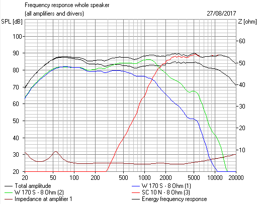

But it does fall into what the wise Lynn Olson calls a "LGWAG" speaker category. I mean, does anybody apart form me think that a second order 16uF and 0.25mH crossover is pushing a tweeter quite hard, albeit with a fairly hopeless LCR added.
And look at the level of the cone-breakup on the 6" bass which I modelled without great attention to the exact tweeter:
Where's the 5kHz cone-breakup notch? Gone AWOL.

Some of the diagnose seems a bit of a contradiction. First of all, an xover shouldn't introduce distortion unless there is something wrong or there are defects in the components. The xover may allow the drivers to operate beyond its range therefore let through more distortion. But the vibes I got from some of the veterans here is that there is nothing wrong with the design and low xover of the tweeter is perfectly fine so I don't see how you can say the problem is distortion at the same time saying the design itself is fundamentally sound.
If you still insist that distortion is the problem then the only source of distortion can only come from the drivers, but these are Scan Speak top of the line so it's unlikely that the drivers themselves are the problem (although personally I never worked with these drivers).
The other criticism is somehow a 6.5 + 1 is a compromise design, but there are a lot of very good 6.5+1 out there so everything just points to the xover design that is the problem.
I just want to put this here as food for thought. Quoted from Troels Gravessen's website regarding a 2-way with the 8531:
"I'm afraid this is where it's going to end for the time being. "Afraid"? Well, I'm not really sure this 8531 driver was meant to perform in a two-way system up to 2.5 kHz. Rather in a three-way system. A classical set-up would be the 8531 + the new 12M sliced paper driver from SS with a point of crossover at some 800 Hz -or a rather more modern three-way system with the 15M for midrange taking over at 300-400 Hz. The sound from this series-V4 is very transparent and with good tonal balance but I still think the 8531 has a certain "paper-sound". Too much lushness, if you get my meaning. Almost a classical JBL sound despite having a rather flat response contrary to the old JBL speakers (I'm thinking of the L100).
I feel very tempted to coat the 8531 driver, but applying coating material to a 300 US$ driver is a one-way ticket and you may end up ruining the driver. I'll have to consider this carefully. I'm sure some people will say that this is just what they want, and others will notice the "sound" (= colouration) from this 8531 driver giving too much sparkle to a piano note or a vocal performance. Running the SP95s-V4 from a Copland CTA505 valve power amplifier in triode mode and a home-made valve pre-amplifier makes this coloration less pronounced, so be sure not to have some aggressive front-end driving this speaker."
You can see his design here: SP95
Yes I realize, different XO at 2.5khz, but it is some food for thought. Just because it is a high end driver with low harmonic distortion & the final FR is quite good, does not paint the whole picture. Not saying I won't look into things further, but people act like those 2 graph are good so there is no reason for me to not love the speaker.
One speaker does get floor bounce on the hardwood floor but even that bounce should be at least mostly blocked by a tiny side table right next to me. Nothing else between us. This problem has been present in multiple positions in 2 different living rooms. Again, it was even present when I had different boxes in an MTM configuration which is why I really lean towards it being a characteristic of a driver, or at least a characteristic of a driver used at this XO point anyway.
MTM speakers have a different lobing structure due to the MTM arrangement and the reflections are reduced for the same reason. Have you tried laying a rug on the floor, or moving the end table to next room? I know mine get harsh when the coffee table is empty and in between me and the speakers.
