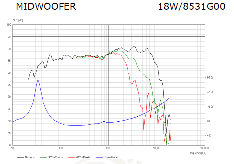

Dear old Zaph aka John Krutke is in the American school of thought that all can be fixed by a low crossover. Maybe 1.7kHz. To me this is just a way to design what Lynn Olson calls a "LGWAG" or "Little Girl with a Guitar" speaker. Useless for complex Classical Music. Fatigueing.
The European school of thought is that a 1" tweeter should be crossed reasonably high to avoid distortion. I don't much care what the 6" bass is. It always has issues around 4-6kHz for cone-breakup. Cone breakup is terrible stuff. Best reduced. Troels Gravesen favours a tank notch across the bass coil.
Then we have a certain midrange shout with smallish drivers due to cabinet issues. These things can be notched or reduced with an LCR.

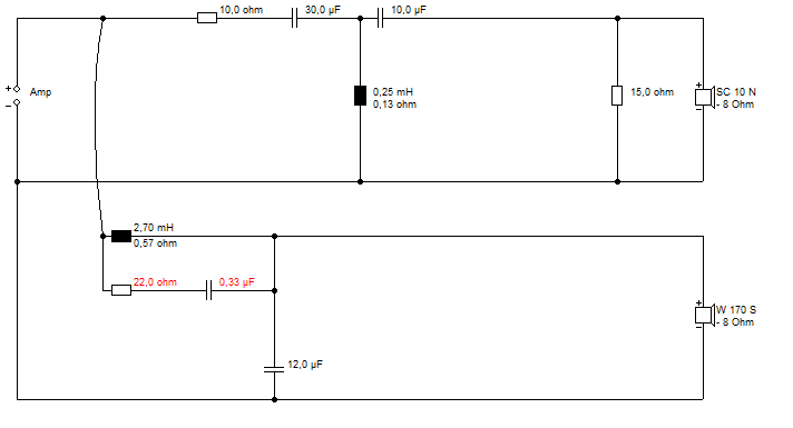

In general, regardless of two way or 2.5 way design, I'd think that notching the cone-breakup is a plan. Maybe reducing the midrange around 1kHz with an LCR. More controversially, I detest soft-domes. A flawed concept if ever there was one. Scan usually do a ring-radiator version of most of their soft-domes.

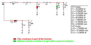

Overall, I think this speaker can be fixed. Notch the bass cone breakup with an added tank around 22R and 0.33uF across the current 2.7mH bass coil. Ought to be nicer. But that doesn't fix the stressed tweeter. Some serious redesign needed.

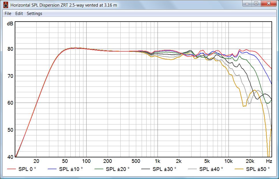

I don't see any inherent problem in Zaph's vented ZRT 2.5-Way design. The horizontal dispersion plot even looks perfectly balanced. Well done, Zaph!

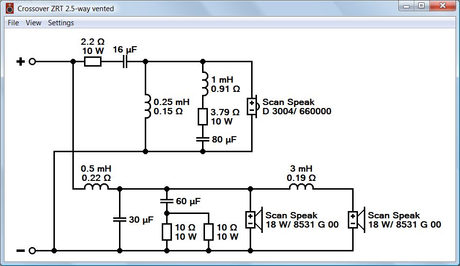

The woofer filter has indeed to deal with a strong resonance at 1.5 kHz. An RC (60 uF in series with 5 ohm or 2x10 ohm) is used to damp that resonance. Your description points to a wiring error or to burned resistors there. It's worth to inspect that part of the crossover particularly.

Along with what's been mentioned, I'll add the possibility of a mislabeled inductor, wouldn't be the first time. Inadequate sound absorption material in the cabinet can cause significant upper midrange peaks. Generic (non-acoustic) type foam can sometimes have very poor sound absorption qualities.
