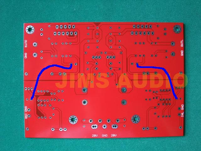

I have just made the modifications of lifted ground from linuxguru on my jim's audio board, and WOW, this removed all the annoying hum that had before.
The output offset gone to 77mV on one side and 7mV on the other.
Now I gonna change the NE5532 to OP2134 and see what happens.
Thank you very much, linuxguru!

Anyone, please, show photo "Yuanjing" PCB with linuxguru mods on the reverse side.
I can't take photos right now, but this image shows what is done on the reverse side of the board.
