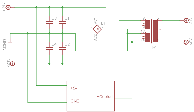

electricity flows around a circuit.
It cannot enter without an exit.
Sure - to elaborate, there are two AC lines for the uPC1237 circuit, powered from an isolated secondary (floating wrt to the main secondary winding) of the trafo. This is rectified, filtered and regulated to +12V and used to power the uPC1237. The ground on the filtered side of the rails connects to the main star ground, and that sets the DC 0V level for the protection circuit. The uPC1237 protection circuit senses the speaker-out DC level (through a resistive divider) with reference to this 0V.
It also independently senses the AC level of the trafo through a resistive divider - this is what seems to be confusing some of the previous posters. It can do this, because the DC 0V to the uPC1237 is shared between its own rectifier-filter network as well as the power (star) ground of the main secondary winding.
put your thinking cap on.A sense circuit does not require current flow. Only a difference in potential.
How does the sensing circuit detect a difference in potential?
So...in essence, I just hook up either one of the 28V AC lines to the board, and it would be fine?
Just do it. It will work. I promise. xxx
Haha I trust you. I'm just confused about the concept.
How are you confused? Explain and we might be able to help.
Yep there is nothing to it, 3 inputs basicaly, 1 to cut off speakers if mains is switched off, one to power the chip, one to sense if there is DC on the output... (which is why I prefer useing them as mono units... there is only one input from the 2 channels which is just tree-ed off by 2 resistors....
