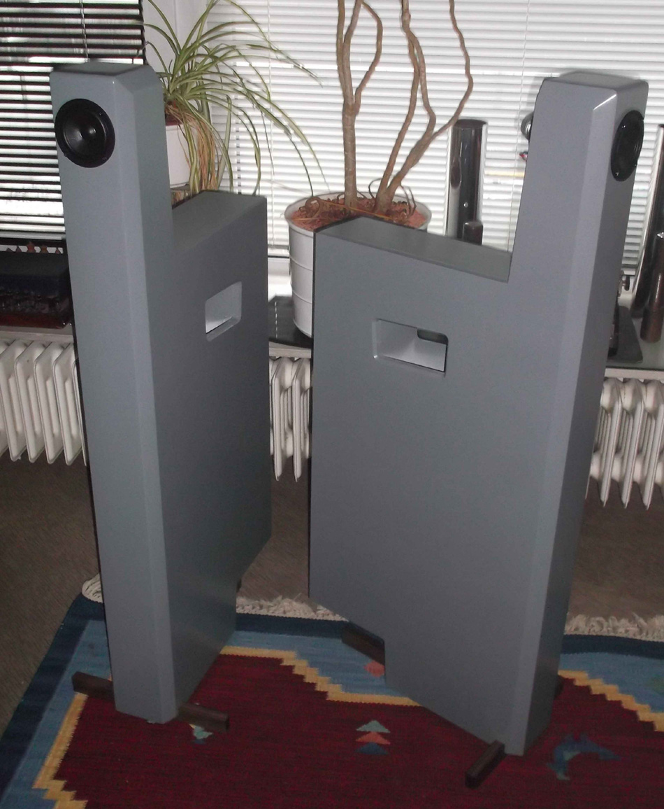

double horn Miniposaune
Hello,
i made a superb experience with
Frontdriver: scan speak 10WB 0824 G00
Backdriver: scan speak 10 F 8414 G10
down to 35 Hz in 22sqm room.
look my HP, with measurements
MPmess
http://www.diyaudio.com/forums/full-range/249361-mini-posaune.html
