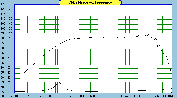

Yes in either a 1.5, or a classic 2 way.
There is so much "gain" from the woofer that baffle-step compensation shouldn't be a problem (when used with this driver).. Plus, it has good low freq. extension vs. enclosure volume when compared to other driver's of similar spl at 1watt/1meter in relation to it's response at 150 Hz. A 3.5-4 cubic foot enclosure volume with a *low* tuning freq. results in a pretty spectacular low freq. response when you "shelve" the baffle step loss area. (..and there are a number of ways to do this, both electrically and acoustically.)
It obviously has some problems in response in the mid-range 400-600 Hz region, and generally that suggests bass driver use only.. BUT there are design schemes that will mitigate an issue like this - and can work favorably with BSC. (..hint, hint )
It's not too shabby from Mark's (.25 meter) tests either:
Looks very impressive for a high powered high quality 3 way project! I'm not sure it quite cuts it for a full range though... could perhaps act as the mid/high in a two way crossed around 300Hz though

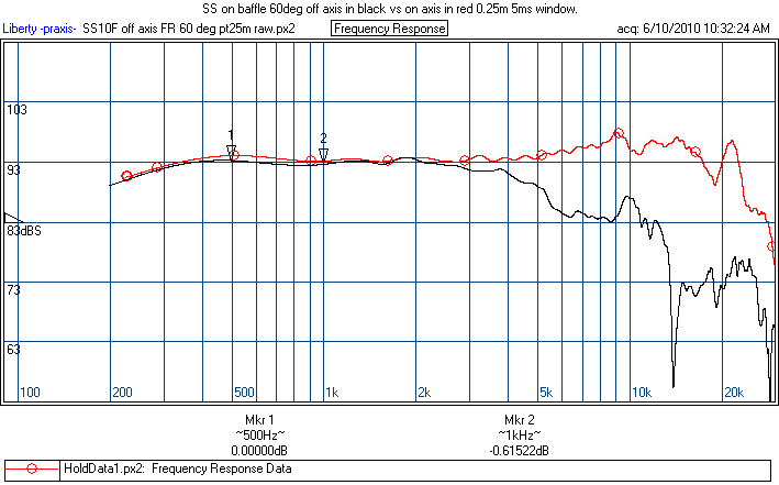

well make your own picture:
ScanSpeak measurements:
Zaph's measurements:
to my eyes, that is pretty damn close and discrepancies could well be production method induced variations
I have the actual units (which I sent to Zaph) that he tested and I will be receiving professionally calibrated microphones soon. The 10F that MarkK tested also happen to be the same actual drivers (again, sent by me to him, then returned back to me).
