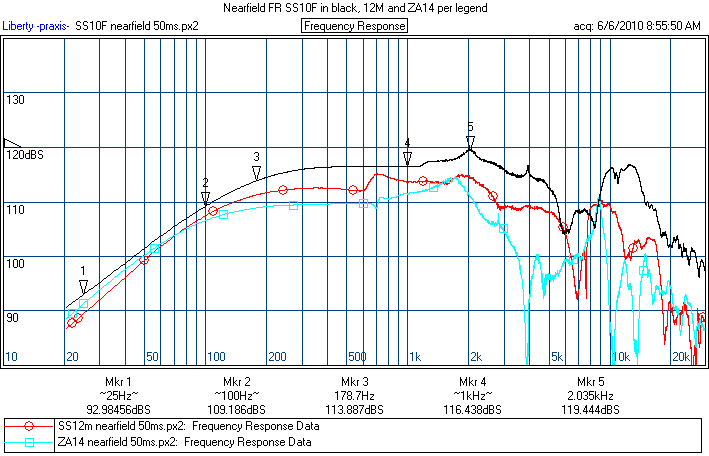

well this thread went dead in the first place only because people with commercial interests ganged up on it right after the original post since it happened to say something positive about a competitive driver.
never understood why the forum tolerates this where any thread here is meant to be by DIYers for DIYers.
and all this going back and forth on the measurement practices trying to undermine data for the SS 10F driver(s) was really a turn off for me. If it wasn't, I would have used the referenced professional equipment in a hemi-anechoic chamber I have at work (yes, one of those dressed up with 2 foot cones all over the walls and the ceiling) to get "the real measurement", but I am pretty sure that would have been a waste of my time.
A similar thing happened in this thread where a driver I measured had such a an odd (non-flat) frequency response that the immediate response from the manufacturer of the driver, was that because my equipment was too cheap (not a Earthworks M50 running on LMS) and I did not have an anechoic chamber were the reasons why my measurements did not match the factory response curve. Deja vu all over again. Turns out, several others got similar measurements. In any case, what was an interesting thread had to get shut down permanently because of too much discord. Oh well...
http://www.diyaudio.com/forums/full...parison-3in-4in-class-full-range-drivers.html
