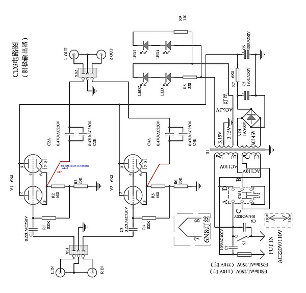

Is not a 6n1p a 9-pin tube and the CD3 is wired with 8-pin sockets? You would have to replace the sockets or acquire/make 9 -> 8 pin socket adapters which are somewhat costly.
Two New Tube Adaptor ECC85 6N1P 6H1N to 6SN7 or 6N2P to 6SL7 Free Shipping World | eBay
Why not put in two premium name-brand 6SN7 or 6SN7GT? Done, 2 minutes!

Hi Konga!Took off the tube guard and swapped in a pair of NOS RCA 6F8G tubes on adapters.

The 6F8G upgrade is also easy, and as the pictures show, very elegant. Yes, rewiring or adapters. GOST22 you must evaluate the spec sheets of the stock original tubes and compare them to any tube spec sheets you wish to us as alternatives. Pin layouts too!! I would NOT expect miracles.

Hello again. Hope you like the schematic.
I'm not a tech, though I've built some kits in my time. I'd appreciate some observations and corrections from the techs in residence.
First, judging from the schematic I've submitted, I'd say that all the capacitors and the 680 & 100K resistors are in the signal path. I concluded that the 20K resistor is not. I'd appreciate any corrections.
Second, in the interest of properly orienting any capacitor upgrades, could someone point out the source and destination or ground sides of the capacitor positions judging from the supplied schematic?
Third, a very vexing issue. There's no damn difference whether my unit is on or off. That is, the system continues to play music when I shut off power to the Yaquin. There's no sonic difference whether on or off. When the unit is turned on, it's 'instant on' with no tube warm up, or turn-on thumps, and likewise when I turn the Yaquin off, there is no shut-down thump and the music continues to play merrily along.
Is it plausible that this unit acts as a 'straight wire' connection when powered down? Or have we been scammed? It just seems improbable that an active circuit would behave like this.
My connection scheme is DAC > Yaquin buffer > passive stepped attenuator > amp.
Any help is more than appreciated.

the tubes used in this buffer are dual triodes, and each tube has those triodes wired in parallel in the circuit, so, in a way you are already getting both segments of each tube, per-channel. If you found a way to mono-block as you say, I doubt you would hear anything much different. Now, it is more likely that sonics could be impacted/changed some by tube swapping, or modding to take the various other options like 6F8G, {or if I had a CD3, maybe the 7193}. Or just try better 6SN7s. 6n16b-v might be a simple experiment, solder some leads to a pair, or use socket-savers to adapt them.
I don't understand your question, but a buffer cannot be used as s monoblock or any amplifier as it provides no gain by design.
