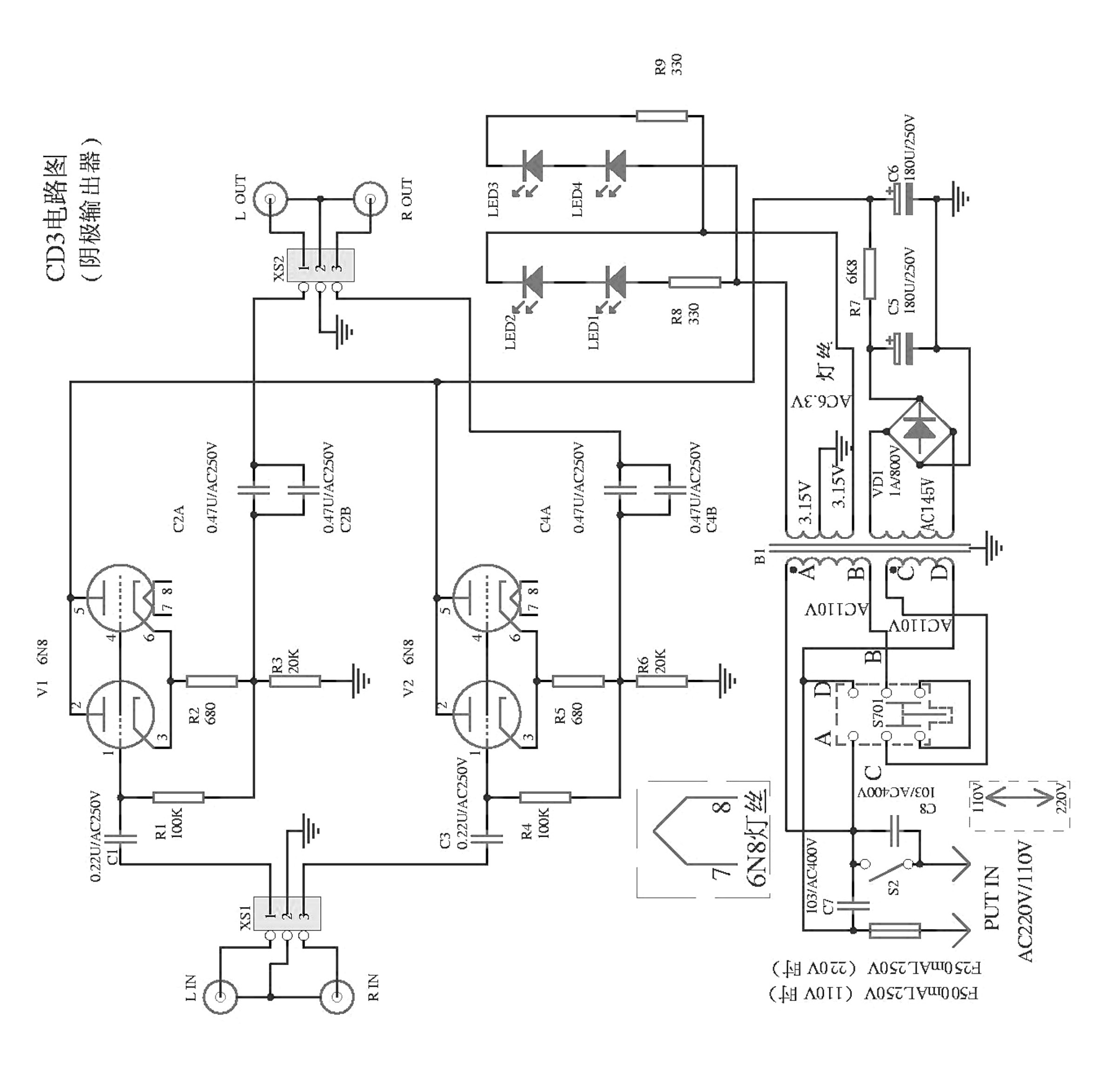

Hi folks:
Just bought the CD3 buffer and have access to the schematic, which I thought you boys would like. But I have a vexing issue and some observations to follow in my next message.
How much is the voltage on anode (V1 =?).

After changing the original coupling caps with numerous film caps, I'd say
1) I'd agree the stock caps are OK. To better them costs quite a few pennies.
2) IMO the sonics of the coupling caps has as much impact as the sonic quality of the 6sn7's.
In the end, I stayed with original AuriCaps on the inputs - which I think is an excellent value,
but are quite transparent.
For the output coupling caps, I used Mundorf M Cap Supremes.
But would like to try the new Mundorf EVO silver/gold oil caps.
Please note that even though film caps are "Non Polarized", the outside
of the foil should be used as a shield - which means it should be connected
to the low Z side of the circuit.
As for changing the diodes, the CD3 is dead silent, so is noise on the +Ve rail an issue ?
As for signal tubes, I'm a huge fan of vintage Amperex and Siemens
however, within the 6sn7 family, the best tube I've ever heard
are Shuguang Treasure CV-181z's.
