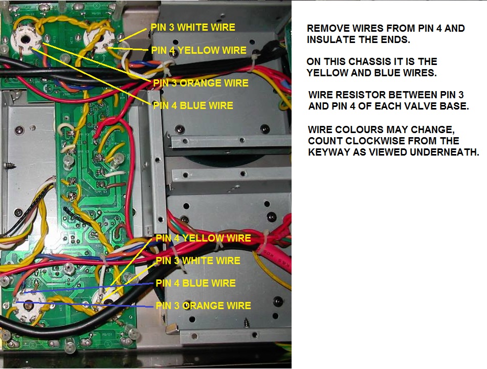

The resistors have arrived, but can't remember what I need to do. Anyone got any photos of the triode mod ?

Triode mod: Ok got the lid off, but I am crap at reading schematics..
- So how can I know which pin is what ?
- Can I snip the wires with the board still in situ ? Looks like a right pain to remove

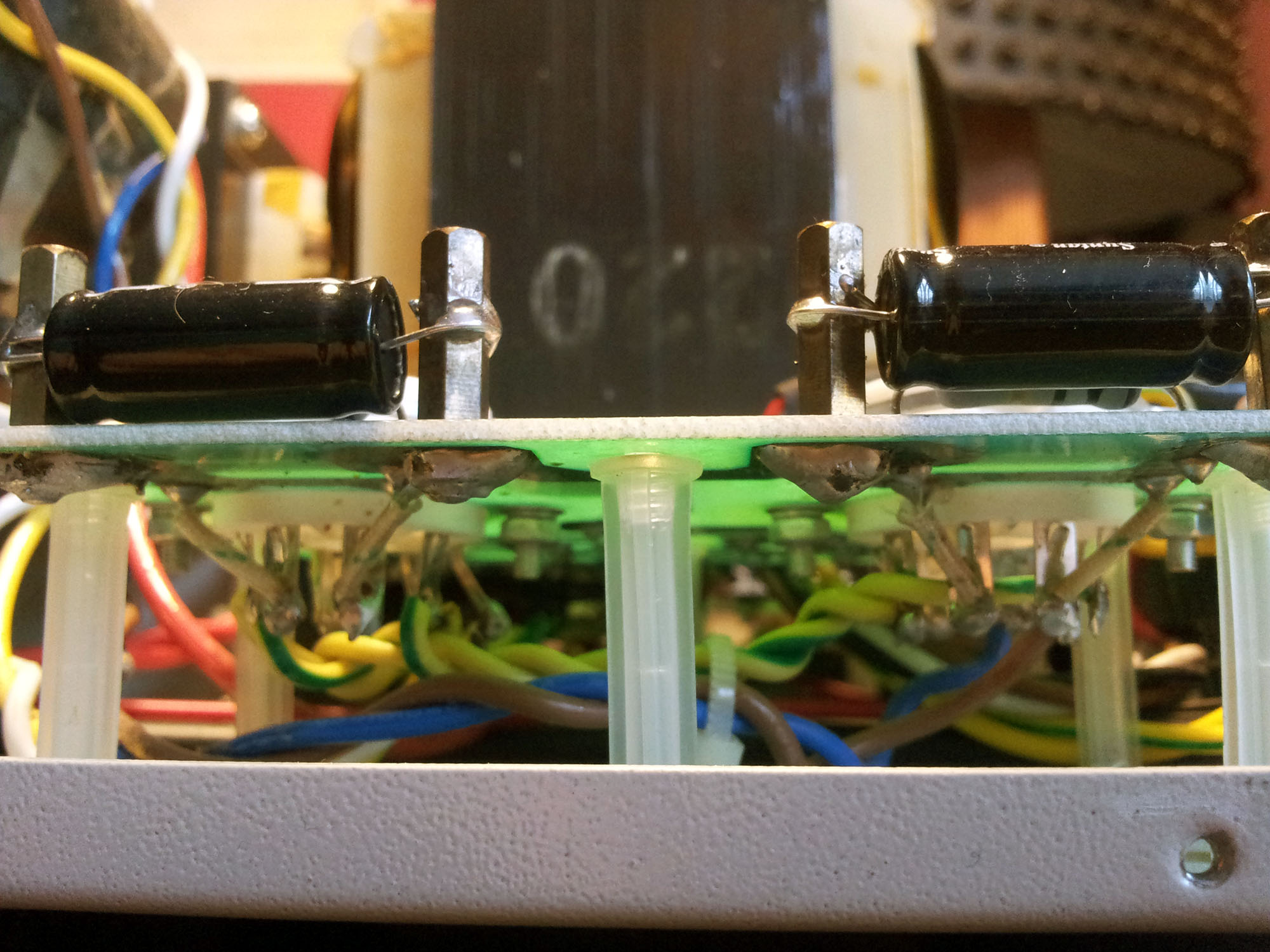

I would tip the unit over, resting on the transformers and remove the base panel. Yep I know it is a chore with so many screws to remove but note which ones come from where.
When the base panel is removed, all the output tube holders are very accessible to do the required operations on the output transformers U/L screen grid taps etc.

Nice one Les, far less hassle that way !
Les is the man! Now get that mod done and let me know how it sounds! Ill need to order some more Takmans and the required components for the triode mod should I decide to do it.
Will do it soon, just a bit scared about being able to identify the correct pins to snip

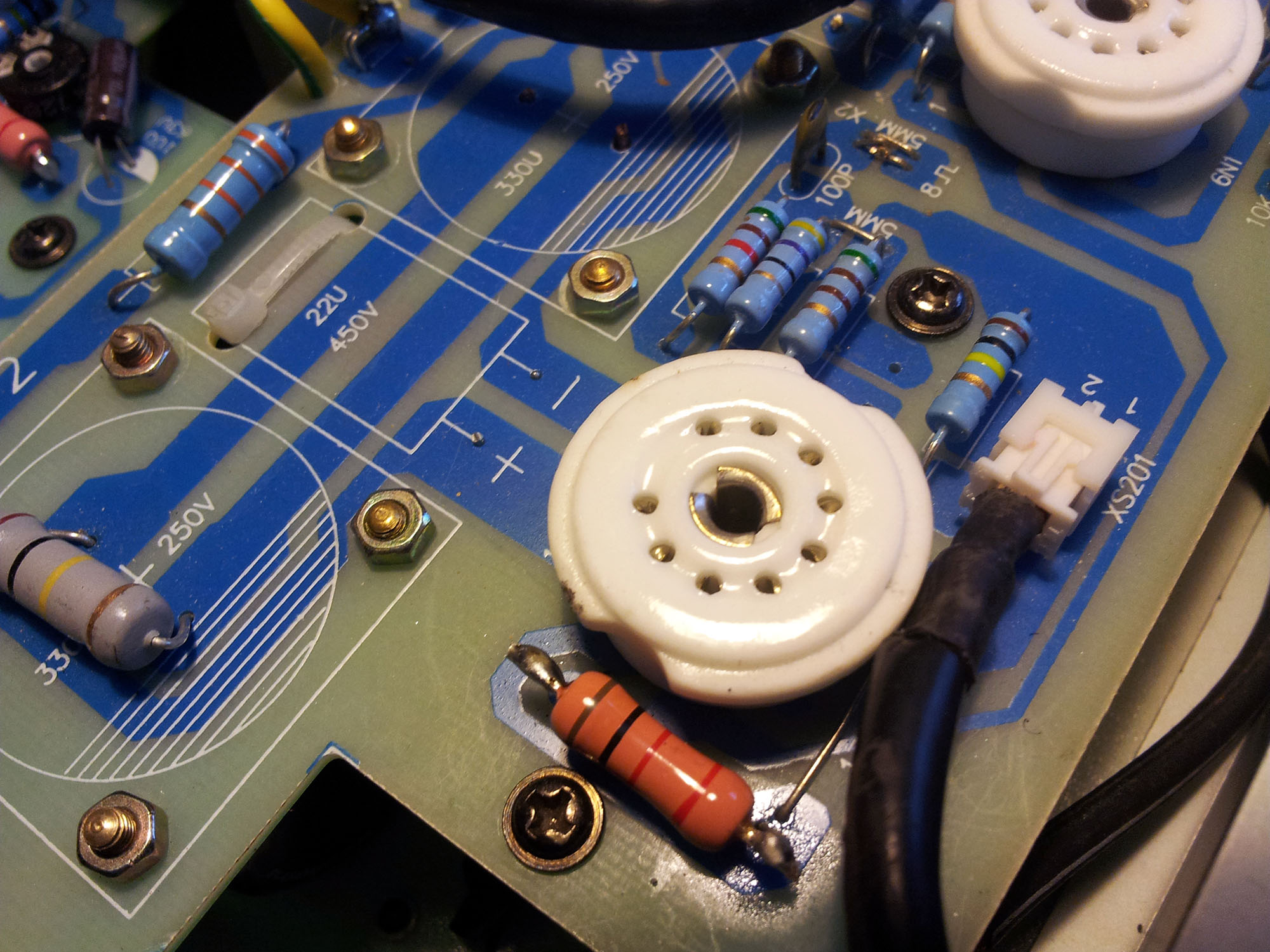

Yes did crack it up on my second session last night, all was fine and requires turning the knob only a little more than before. Though wish I have let the preamp Takman's burn in for longer to evaluate them properly, think they are still easing in. Odd how never noticed this on the output valve mod
I believe my parts will be here today. I'll be giving this a go, it is reversible after all...
Just remember to cut or desolder the UL wire at the pin for easiest reconnection.

I opted for the cut, wires were too wound for an unsplattered removal.
Have a tea tray placed to the side of the upside down amp for putting all the different size screws on and so in line for easy referencing when putting the amp back together !
