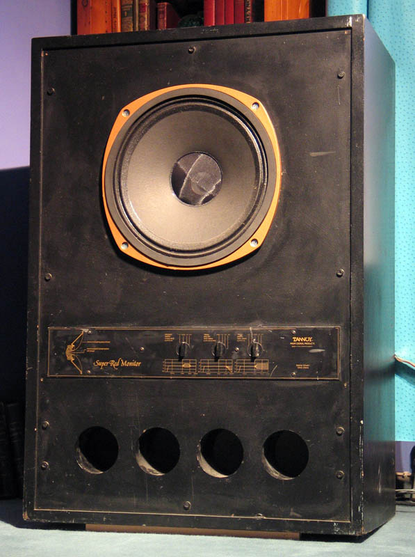

Me too going through a reminiscing stage and just bought a pair of speakers I had back in the 80s off of ebay for pennies and they sound wonderful. Didn't appreciate them at the time but certainly am now. Musical Fidelity MC4 (v1)

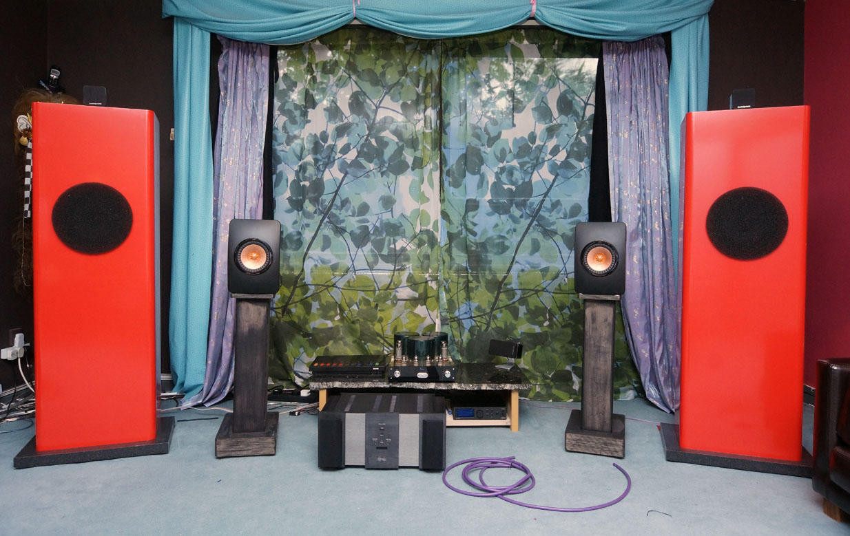

The little speakers are a pair of KEF LS50s which I had on loan for fun.

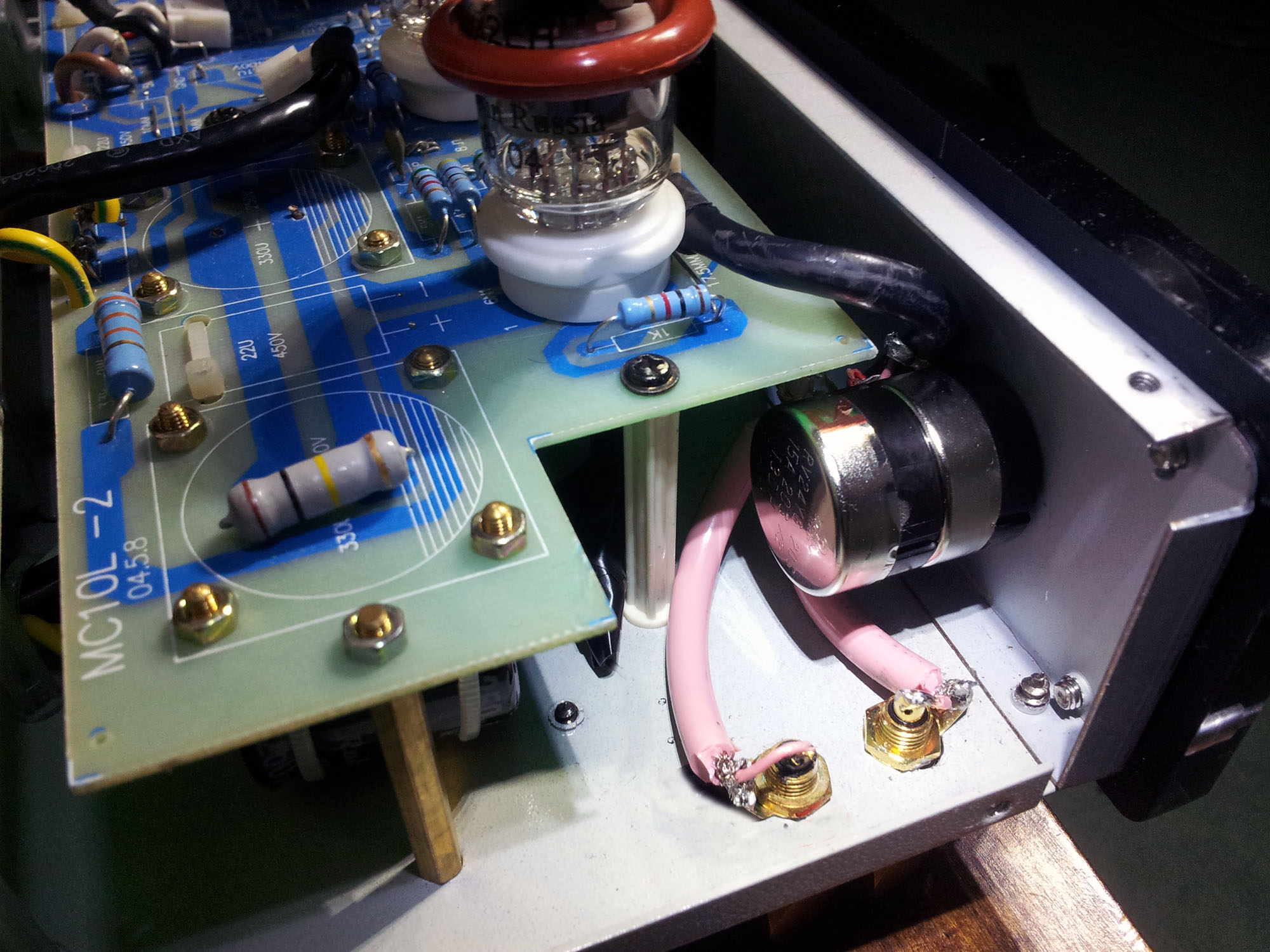

It is a joy to hear the detail being allowed to come through by cap replacement etc. On that note here is my latest to up the detail revelation stakes. I only have the one source so why not have that direct into the vol pot bypassing the selector switch.

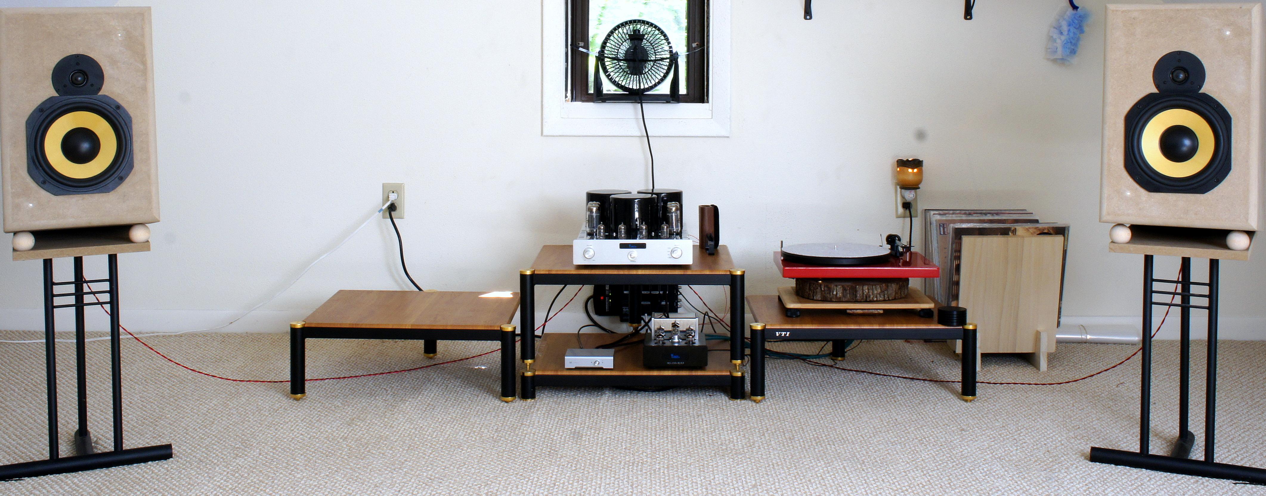

Interesting. If I weren't running two sources I'd be tempted to give that a go. Here's what I'm working with currently. I haven't finished the speakers yet because I don't want to part with them for the amount of time it will take LOL.

I put new input RCAs on the chassis by the volume as the most direct feed and so to leave the original wiring undisturbed.
Not sure why they rave about the Takmans that much. Anyway why only replace the outputs and not the preamp ones as well ? Think one [1K] can be seen in my last photo.
Is that the EHs running on your amp ? Nice set up you have. When will you give the Genalex 77s a shot ? :p Can't wait for the verdict !
Yeah the Takmans didn't improve or degrade the sound IMO. Either the originals were pretty good or the circuit doesn't require higher end stuff in that spot.
Those are the EHs, they sound great. The Gold Lions will have to wait a month or two, Vacations and such are top priority right now.
