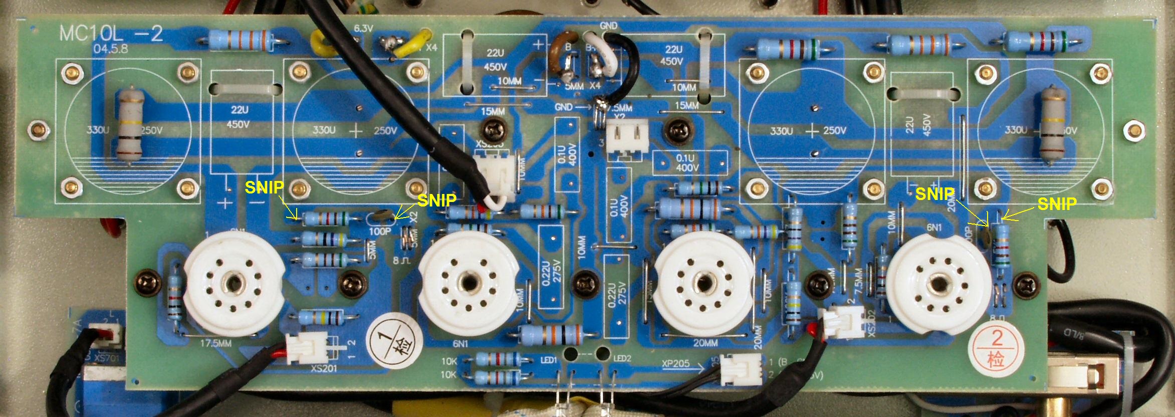

Just set the bias to the normal figure (0.35V). Have you tried removing the negative feedback?
In theory with true Triodes, because they are more linear then there is no need for negative feedback or at least a much reduced amount. I have no idea what the MC10 would sound like in Triode mode with no feedback. Just carefully cut one leg of the 5k1 resistor and the 100pF capacitor. Carefully means try to leave a piece of wire sticking up from the board so you can re-solder the components without having to do a major strip down :-D.
Interesting...where are these components located? I'm willing to give it a go!
Okay, found 'em and clipped 'em. They're on the pre-amp board, small components right next to each other, one set for the left channel and one set for the right, the cap is a small ceramic.
Um, Les...this is nothing short of amazing. I've only listed to 5 songs that I'm very familiar with so far:

The detail is just crazy. I'm noticing things on these tracks that I've never noticed before. Tom drums sound so lifelike, cymbals are metallic and each strike has it's own slightly different sound, highs are much clearer and less harsh, everything has tightened up nicely. All of the background noises and voices on "The Wall" tracks are more intelligible and easier to place.
You're up Barbieboy!
This is the later MC10 series, an early version will be slightly different.
Yes the psycho-acoustics can be very real. I notice this a lot on re-mixing where just shifting of the levels is required and one is easily fooled into thinking it sounds better, frequency wise :-D
Now if I had done what you done so far i.e. removing the NFB, I would at least try to set up the phase splitter outputs to give the least harmonic distortion. Without any test gear this really is a no-go but then you probably are not hearing any more distortion than normal? If you have a dual channel oscilloscope you can use that to give a reasonable assessment of equal and opposite drive to the output tube grids.
