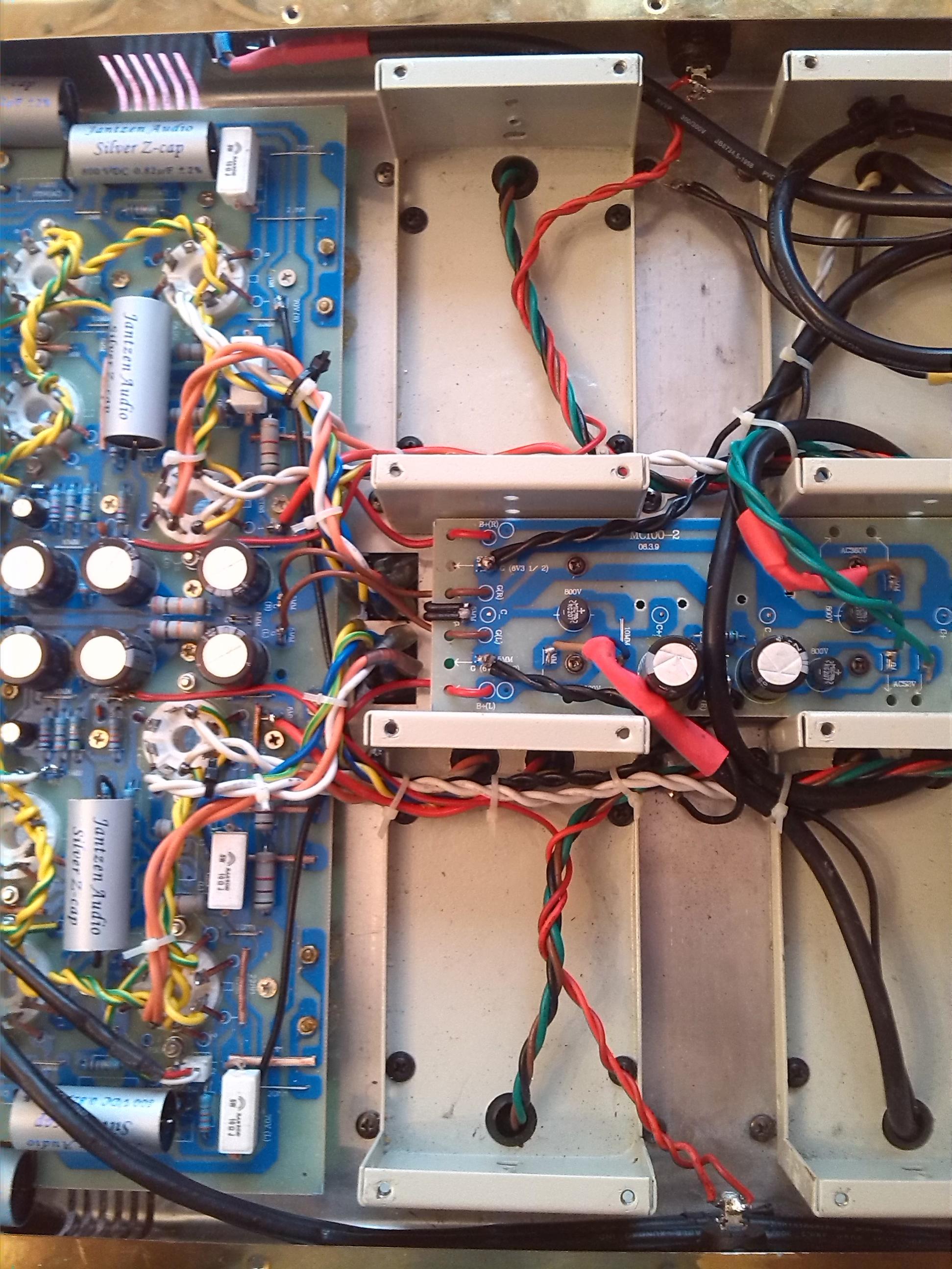

Hi thanks for your reply and help.
I have been looking at the link you put and reading up on the Internet about feedback loops.
It looks a bit more complicated than I first thought I was just hoping it would be a matter of taking the loop before the output transformers.
My speakers are already on the 4ohm taps.
They are monitor audio studio 12se 96db 3 way floor standers with metal dome tweeters and two 5 1/4 inch drivers.
I am new to DIY electronics and this is my first valve amp but I built my first valve dac about a year ago (coppied most of it from lampizator site).

Glad to help Dave.
As DF69 pointed out I meant that the output impedance rises when you drop the GNFB (global negative feedback). I'm not sure why he is interested in my bedtime however - he's a queer one!
Is 96dB the sensitivity of your speakers? Sounds a bit high TBH - I'd guess 85dB/watt.
Partial feedback is not a huge deal on your circuit TBH.
You have what looks like a high gain SRPP input stage driving a LPT phase splitter into two cathode followers. It's a bit naughty that they use the same filament power for all lower and upper tubes but there you are.
So you could re-purpose the followers and KT88s into 4 class A partial feedback amplifiers (2 per channel), to give a dual/stereo bridged drive to the OPTs. Then you simply drive them from your LTP, perhaps with lowered gain from the input SRPP.
So you have all the bits to do the conversion with - you just need to significantly rewire the follower/driver triodes and feedback from the KT88 anodes to their cathodes. Job done. It's a very suitable amp for doing this to actually - lots of handy tubes just sitting there ready to use.
I do not think that removal of cathode followers is a good idea. Phase splitter does not like to work with variable load, which class AB power stage presents to it. And significant reduction of feedback is only possible if power tubes are biased solidly for class A operation.Glad to help Dave.

Absolutely.
However the LTP will be driving a regular triode grid, and there will be more feedback - not less.

Hi Globulator I think these mods are still above me at the moment.
I don't understand what LPT is.
I'm at the stage where I can copy other people's mods circuits and swap components.
I don't understand ohms law or the Maths involed.
The DAC I made was easy because the lampizator gave lots of photos with step by step explanations and mods.
It stated out as a behringer dac with tube output then I got a bit carried away.
Perhaps at a later stage I will try these mods when I understand more.
I think for now I will change the resistors as in the diagrammed you have put and feedback cap to 72mf.
Change the capacitors for better ones and put some switches so that I can switch feedback loop on or off.
I will keep watching incase someone else cleverer than me does the mod and I can copy it.

Well it's a good place to learn .
Long Tailed Pair = LTP. It's a pair of triodes with connected cathodes, so when you drive one of them the other leaps up and down in opposite phase. This therefore forms a 'phase splitter' - i.e. you put in a signal going down-up-down in, and from one anode you get a bigger down-up-down, and the other one you get a up-down-up. I.e. one side inverts the signal and one doesn't.
This allows a push-pull or 'bridged' amplifier to drive the speaker actively one way and then the other. If you imagine a very low frequency wave pushing and pulling your bass speaker cone in and out - the push comes from one side of the LTP and the pull from the other.
For a beginner the first thing is safety (read the top posts) and possibly adding a LED and 'bleed' resistor across your main power capacitors to ensure they are discharged. Seek advice to do this safely as they can hold a lethal charge for some time (weeks!).
So I'd prescribe a mild upgrade to all the main components as you suggest, as you learn more about stuff.
Ohm's law is merely a relation between voltage and current in the form of a fraction, and is R = V/I. Therefore if you wanted to connect a bleed resistor across a 400V source with a red LED (dropping 2V) that takes 5mA you'd have:
V = 400-2 = 398V. I = 5mA (5e-3A).
R = V/I = 398/0.005 = 79600ohms, closest real resistor = 81k.
Of course that resistor is now checked for voltage - most only go to 200V so you'd need 2 of them in series. Power dissipation P = V x I, so it would convert 398 x 0.005 = 1.99W into heat, which is quite a bit of heat - each resistor would need to be at least 1W rated and carefully placed in the air so they could cool.
With that in mind I'd experiment with a meter and see if I could use a bleeder resistor further down the amplifier resistor chain so you had less voltage and power to worry about. You can also work out discharge times too with capacitor equations.
As you can see the benefit of learning resistance, power and other simple equations allows you to plan out your modifications - I'm sure you'll pick it up quickly. They are also the only equations you need to learn to plot tube operating points. E.g the ECC88:
Tube operating curves show you the relation between grid/cathode voltage, cathode-anode voltage and current. For instance if you have a 200V supply ('rail') and want a 10mA current when the anode is at 100V you look up that and find the grid voltage is about -1.5V. You achieve this on the grid by attaching the grid to ground via a tiny current (big resistor like 470k - Rg) and put a resistor between the cathode and ground - Rk - to elevate the cathode.
So a 1.5V cathode at 10mA = 1.5/0.010 = 150ohms on the cathode (Rk). The anode needs a resistor (Ra) to take 100V at 10mA so you need a 100/0.01 = 10k resistor there and your circuit is done (for that operating point).
Of course now you can work out the power of the resistor required etc - and choosing the best operating point is another question.
This is a page (there are lots!) about the above example I gave (with a different tube!) Designing Common-Cathode Triode Amplifiers
Also take a read of the tubelab.com articles - they are some of the best written I have seen and you'll soon learn a lot from them.
BTW which resistors were you planning to change and why?
