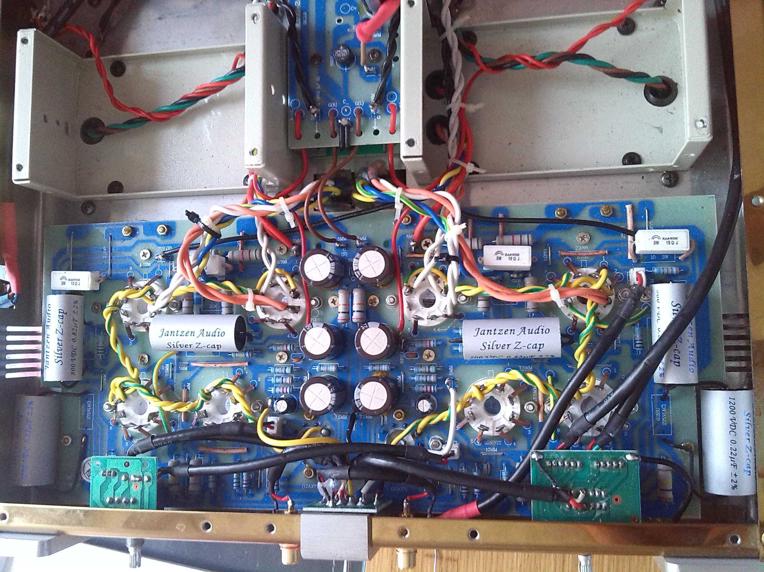

I've tested he Jantzen Superior Z in my MC100B. They sounded to my ears a bit "nervous" and little lean and cold. They sounded good on piano though I remember.
I also tested Mundorf Supreme Silver In oil and they had a overall better sound but I didn't like them because they said; "hey come listen to me, here is plenty of detail" type of sound and i couldn't focus on the music at all..
Wima MKP 10 was also in place as a low cost alternative but they sounded flat and dull. I've found them to be much better in other curcuits,
After all this I took a turn to Intertechnics Audyn-Cap Reference and I had them a long time.. All the warmth in the mid I wanted and all the details but i listened to music this time. Just for fun I also decided to try True Copper from same company and yes even more coherent and natural.

Hi I have got tungsol KT120s set at 120ma but I have not checked my B+.
I did try changing all resistors to the suggested resistors on the circuit diagramme on this thread.
I didn't have the 18k resistors so I used 20k instead but my amp didn't like this at all.
I got a low level distorted sound at full volume no sound until volume was half way so I put the old resistors back.
I have added switches so I can remove my feedback loop and I think it sounds better without feedback loop.
I have replaced all blue capacitors with jantzen silver capacitors which gave me a slightly clearer sound and slightly more bass.
