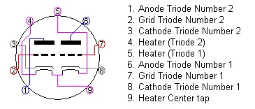

Göran at www.Webb-Butiken.com sent me some russian "6N23P" I'm gonna try out. Just have to move one heaterwire to another pin. They suppose to "the best ever russian eq to 12ax7".

Are we talking about the same? Pinout looks like 12ax7 except heater.

Amplification factor is lower and heater current is higher?
You mean that my mc100 have to be redesigned totally to take this 6n23p?
I know many people have changed 12ax7 to 6n2p without issues and what I understood some also later on replaced the 6n2p with 6n23p.

Correct.
6N2P is a 6.3V heater version of the 12AX7A so that's easy enough to do if the heater voltage is 6.3V already. Just be ware of pin9 which is the shield.
That's not impossible but I'd doubt it'll work optimally without any further changes though.
BTW, looking at the vendor's website you linked above I could only see a 6922-EH which could be the same as the 6N23Ps you'll receive.
I don't know if they actually are one and the same valve.

My octal sockets are in bad condition are in bad shape, I need to replace them all. Tubes are dangerous loose... When i do that i was thinking hardwire everything anyway so if someone have any suggestions of improvements for the mc100 i would gladly hear them.
One thing i notice that B+ has well over 40-50cm trace/wire before reaching tubes! Mount the last 3x22uf caps closer and add maybe 10uf mkp wouldn't hurt i think.
Yes, replace the SRPP with mu-follower - it's really easy mod - since they are quite alike toplogy like.
If the total gain is pretty much higher then you need - then i would suggest try replacing the 12ax7 with 12ay7's and run then with approx -2v bias and 3mA current. Which would result in less then half gain in that stage (approx 45 vs 100) - but alot better drive and less noise. If you are using the amp as power-amplifier only - it would probably also let you input higher lever before clipping. (since 12ax7 is probably biased a bit lower).
I really wanted to use my russian 6n23p i just got if possible.
In England "tube distinctions" modded a mc100b (to just an poweramp) and removed the first stage. How's that possible?
Is there any simulation software so i can calculate right values for a mu-follower? Or so i can optimize it for use with 6n23p?
This Russian tube was designed for radio frequency amplifiers. It may not be the best for audio. For simulation you can start with LTSpice, which is free. Or find a way to get more advanced tools like Microcap with educational discount etc.
That's not too hard to do and it will also allow to bias the heaters of the remaining input stages correctly and to run the Schmitt phase splitter at more appropriate current levels reducing distortion.
As it is now all but the output stages have their heater to cathode voltages severely violated.
And if your mains voltage happens to be higher the 220VAC none of the tubes will last longer than a few months as they're all being cooked.
As for the 6N23P, these actually fine sounding 6DJ8 clones. I quite like them actually.
