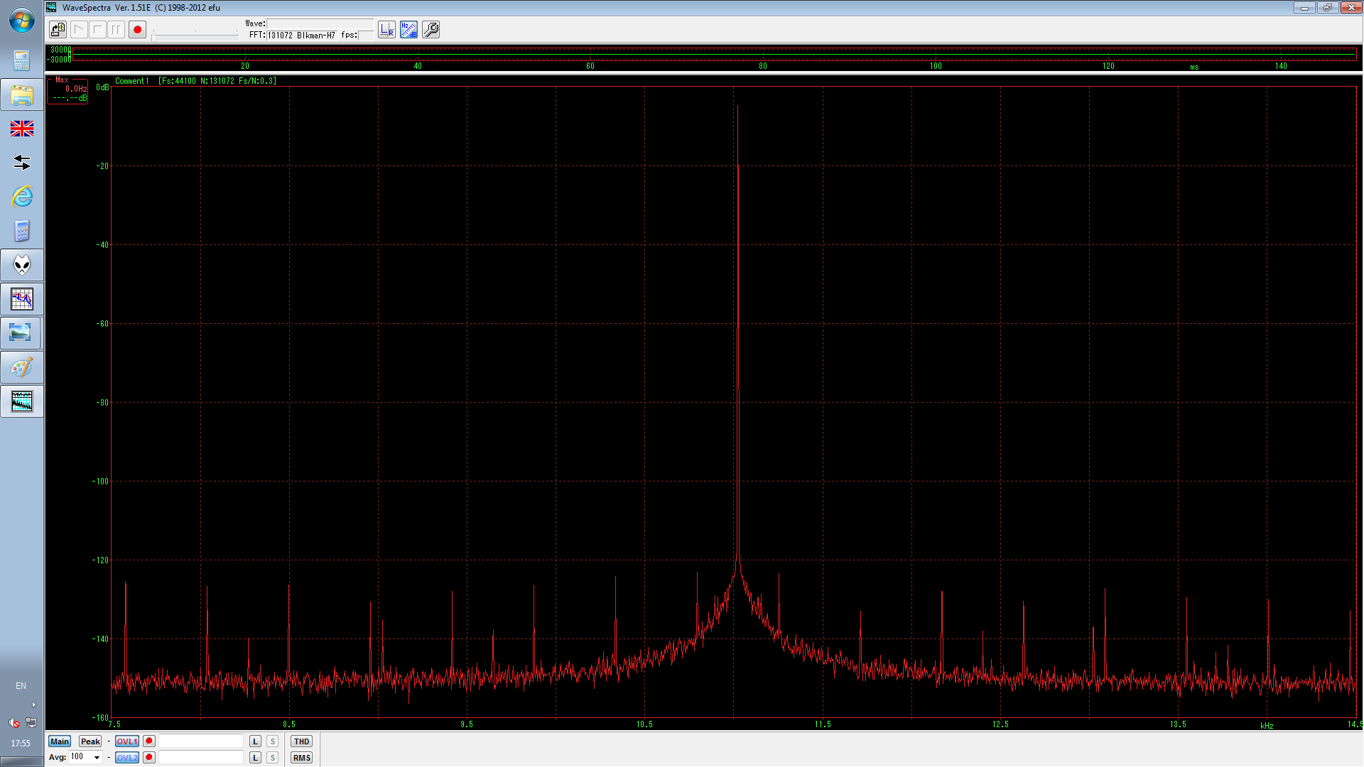

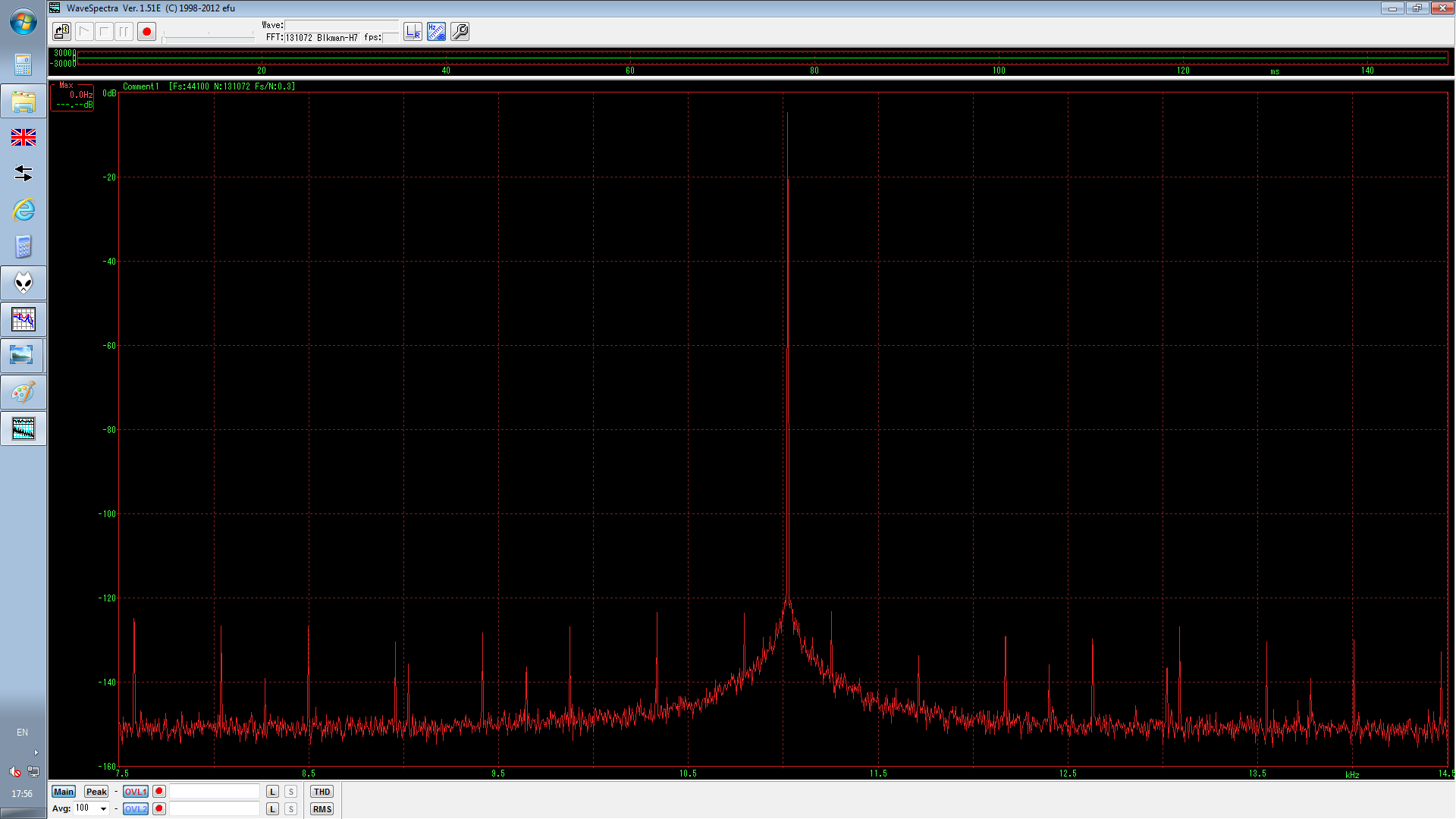

I made some measurements on the spectrum of a signal 11.025kHz + 229Hz_1LSB, I attached spectrums of a board with additional capacitor (digikey link: RR71A101MDN1 Nichicon | Capacitors | DigiKey) and without capacitor (stock board). I attached a pic with the test system: XMOS board, AK4490 and DRV603 board. The measurements are done with an EMU 0202 (little “mod”), so all the results are with addition error of the EMU and XMOS board.
PS: Since a while I haven’t got enough time as I want to. This probably will takes a few more months. If the rules are OK, could my son Lyuben to register and sometimes he to answer the questions (he is fully aware of the material and would be useful), of course we wouldn’t make traffic of the thread

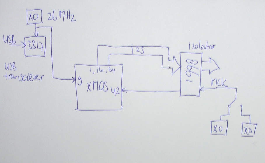

I like the concept of reclocking the i2s output from the XMOS after galvanic isolating it. But it doesn't work in this design unfortunately.
one would assume that reclocking would be very effective if the jitter of XMOS+isolator stays below 20 ns.
But what if it doesn't?... but for LR clock an error of 20 ns means that the next sample is delayed, very bad for Sound Quality.

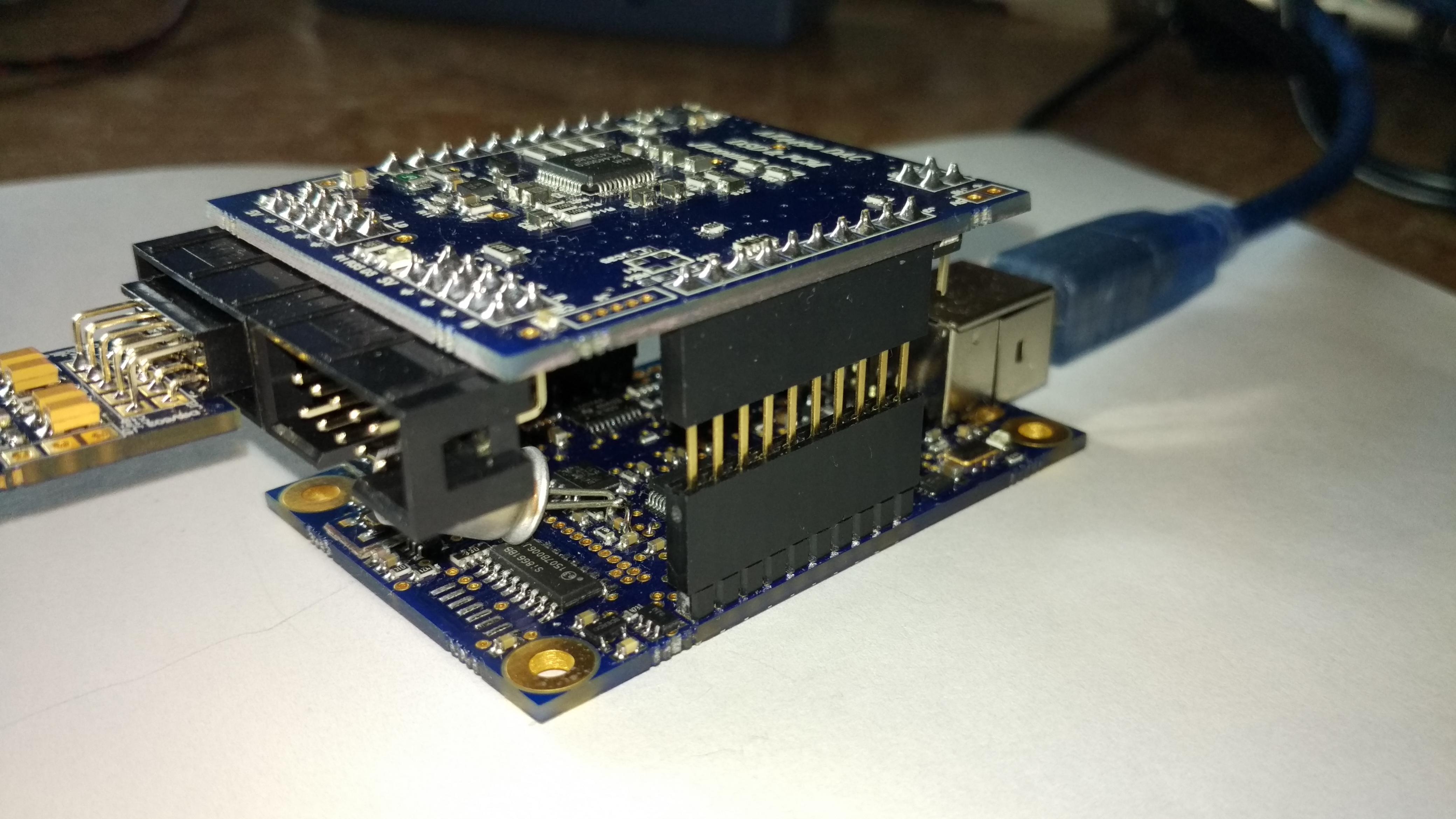

I'm quite surprised (or not?) by the fact some of you are so easily satisfied with some nice looking graphs...! They actually show little more than nothing w.r.t. the subject, but seem to be as effective as a sleeping pill.
But first, thank you joro for your comments and efforts to replicate my mod, much appreciated. In response to your post:
In this document of XMOS company, clock generation of the device is explained. An external clock, for this design a 26 Mhz clock (also used by USB transciever) on pin 9, is compared to an internal VCO (by PLL). This VCO's output is the base of switch clock,reference clock and XCore clock. The initial XCore clock is raised to 500MHz by setting F and D. This generated XCore clock is used to sample the external (isolated) audio clock, which is input on pin 42 and processed by 1 bit Hardware Response Port, as explained in this document. The acquired audio clock is then used by the logical core running the audio driver thread to generate BLCK, LRCK and clock DATA eventually. The process is asynchronous in nature due to this sampling.
The 2nd document defines XCore clock jitter as 70 ps, but obviously, since it's originally generated by VCO, the real jitter figure, and more important jitter distribution, is dependent on VCO stability. VCO output stability is dependent on stable and low noise power supply on PLL_AVDD pin, which is not guaranteed when it's tied to VDD, regardless the mild RC filter in between. And connecting the PLL pin to VDD is explicitly against datasheet recommendations.
Regarding the capacitor of your choice: Better not use an ultra low esr here, because with the 100n ceramic oscillation is possible.

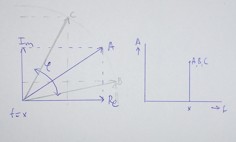

-Regarding measurements-
The analysis you did is more or less a THD analysis, an attempt to measure the effect of jitter. This is by no means a reliable method to measure jitter IMO for several reasons, let me explain.
First of all, if we want to measure jitter in a system, we need to sample the digital i2s LRCK with very high frequency and accurate clock, and this will only be possible under laboratory conditions with excellent equipment. By doing so we can really say something reasonable about jitter. You made visible THD of the whole system, USB interface + DAC + analog stage + ADC : too much players in that game.
Second when doing a spectrum analysis, one makes visible what frequencies are present in the sampled waveform, with limited accuracy due to sampling rate (192kHZ) of ADC and FFT window width / points (?). When excessive jitter is present somewhere in the entire chain, the effect in frequency domain can be made a bit visible with spectrum analysis, as explained in the TNT-audio article written 10 years ago, but this doesn't isolate jitter in itself. By simply using an (inferior for this purpose) A/D audio card with low resolution, you aren't taking the jitter phenomena seriously.
Third: Just one single sine wave doesn't show you much when transferred to frequency domain by FFT, it really becomes interesting when a more complex waveform comprised of several sinusoids is analyzed. I wouldn't expect hearing any difference playing a dull sine wave with or without the cap mod either.
In facts: The graph of a spectrum analysis doesn't show the Fourier Analysis coefficients generated by the FFT algorithm, it doesn't show phase. Phase is of interest with respect to complex waveforms, i.e. with music. The coefficients are complex numbers / vectors, the amplitude at a certain (discrete) frequency is calculated by adding both vectors, SQRT(real^2 + imaginary^2). In the spectrum graph you see this result as the amplitude, see picture 2. This clearly induces that we can make numerous DIFFERENT waveforms, which will lead to different Fourier coefficients, but will show THE SAME amplitude at the same frequencies, and thus will show the same spectrum graph. Those different waveforms are yielding the same frequency components, but the sinusoids are differently related to each other by their respective phase.
So my point is: When jitter is considered as a timing problem, altering the original intended waveform slightly in some way in the time domain, this will also affect phase linearity in complex waveforms (in the frequency domain), a property of sound the human ear is very sensitive of. This would perhaps be more difficult to measure with low resolution FFT, but at least a spectrum graph doesn't show it. Preservation of phase is an important factor for reliable audio reproduction.
Instead of focusing on unintended harmonics in the spectrum, it would be better to focus on the intended harmonics and how their phase is affected. Even more because the amplitude of intended harmonics is far greater than that of unintended ones, and thus more likely to be audible.
The effect of the added capacitor isn't determined by this measurement, just as like a THD figure don't say much about Sound Quality.

Nino
So true, whilst measurement's and science based engineering work in all other fields of electronics, this is high end audio where only our ears and fallible perception counts...
What you have to ask yourself is how much of a problem is jitter these days and if it is controlled at the point of conversion (the only place it does matter).
- Digital Line Level
- XMOS DSD 384 kHz / 32bit USB
