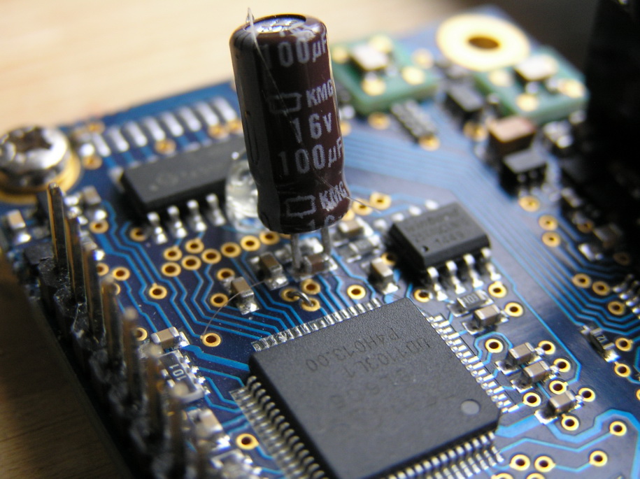

I don't have the proper equipment to do these measurements. But improvement is so obvious, I don't think figures are needed to prove the better performance, though measurements would be nice to verify my theory...
What parameters do you think are improved? Measuring noise and jitter only requires a basic PC with a half-way decent soundcard...
Hi Spartacus, no, Vdd is applied externally, onto 8 pins around the chip. Yes, it's an R, the filter is recommended in datasheet page 17 of the XMOS device used. The regulation is only a problem when there's variable current demand.

Hi marce, I don't mind what you call this at all and disagree with you. Why don't you comment on my explanation in my post, other than stating your opinion about what you think I'm doing, I think that's rather short sighted. I didn't manipulate 'digital' signals by adding the cap, it's just improving analog psu of PLL, please spare me your dogmas about minor changes to a digital system...What a silly viewpoint, you are manipulating digital signals without measurement's you have NO idea what you are doing.... Digital when wrong does not have a subtle effect on the sound, and neither do minor changes to the digital system have subtle effects on the resultant soundfield (other than possible jitter reduction at the point of conversion).
All you have done is add a larger value capacitor at some point in the circuit (contrary to the data sheet recommendation for the supply in question.), you have no empirical evidence that it is doing anything positive to the design... You may call this DIY I just call it playing...
I didn't say effects were subtle either, and by the way: we are talking about jitter reduction here indeed, you got that right!
There are more designs just simply copying datasheet design recommendations, while in this case datasheet is very clear about PLL_AVDD to be separated from VDD, with the additional use of RC-filter of recommended proportions. Just complying to recommendation won't mean you have the best design, although in this case it would be with psu separated, as stated by datasheet. By adding the cap we can try to compensate for the original error of not separating power supplies, it's just as simple as that.

Actually somebody is laying out PCB for a medical ventilator, doing the cough detection system, low level analogue from the sensors with DACs then to a microprocessor for analysis... thinking about boring things such as signal integrity (trace effects especially on low level analogue signals), EMC issues, power supplies layout and location on board (Keep the SMPS switching nodes out of the way etc.)...
So how can soldering one large value cap onto the design change the sound so dramatically, without careful measurement's along the digital chain how do you quantify what is happening. Large value caps act as reservoir capacitors in the digital decoupling scheme, they cannot react fast enough for the switching, but act as reservoirs to top up the smaller value caps local to a devices pins, so a start would be monitoring the power supply pin under load conditions...
You may find this surprising but IC data sheets tend to show the BEST practice for using that device, this is because the IC manufacturers want you to use their device with minimal problems...
Without any measurements you have no proof of anything happening, just hearsay though...
