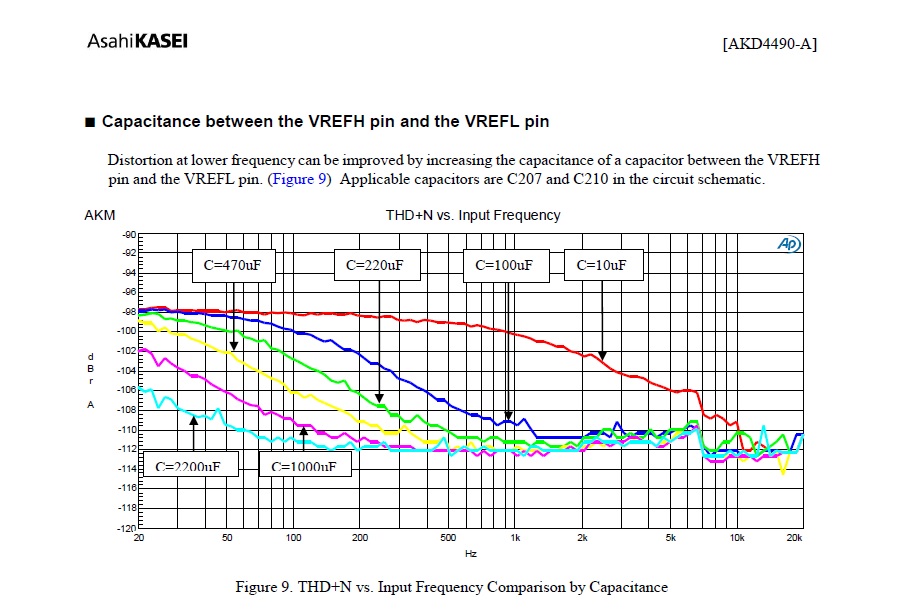

Another document evaluation board for ak4490 page 13 shows how capacitance influenced on thd.
Supply is ok but for finese give max 100nf MKP across C3.

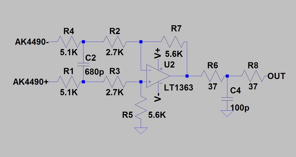

AD797 is not optimal for that schematic ...(AD797 BR is brighter than AN) and resistor values are to high for optimum preformance.

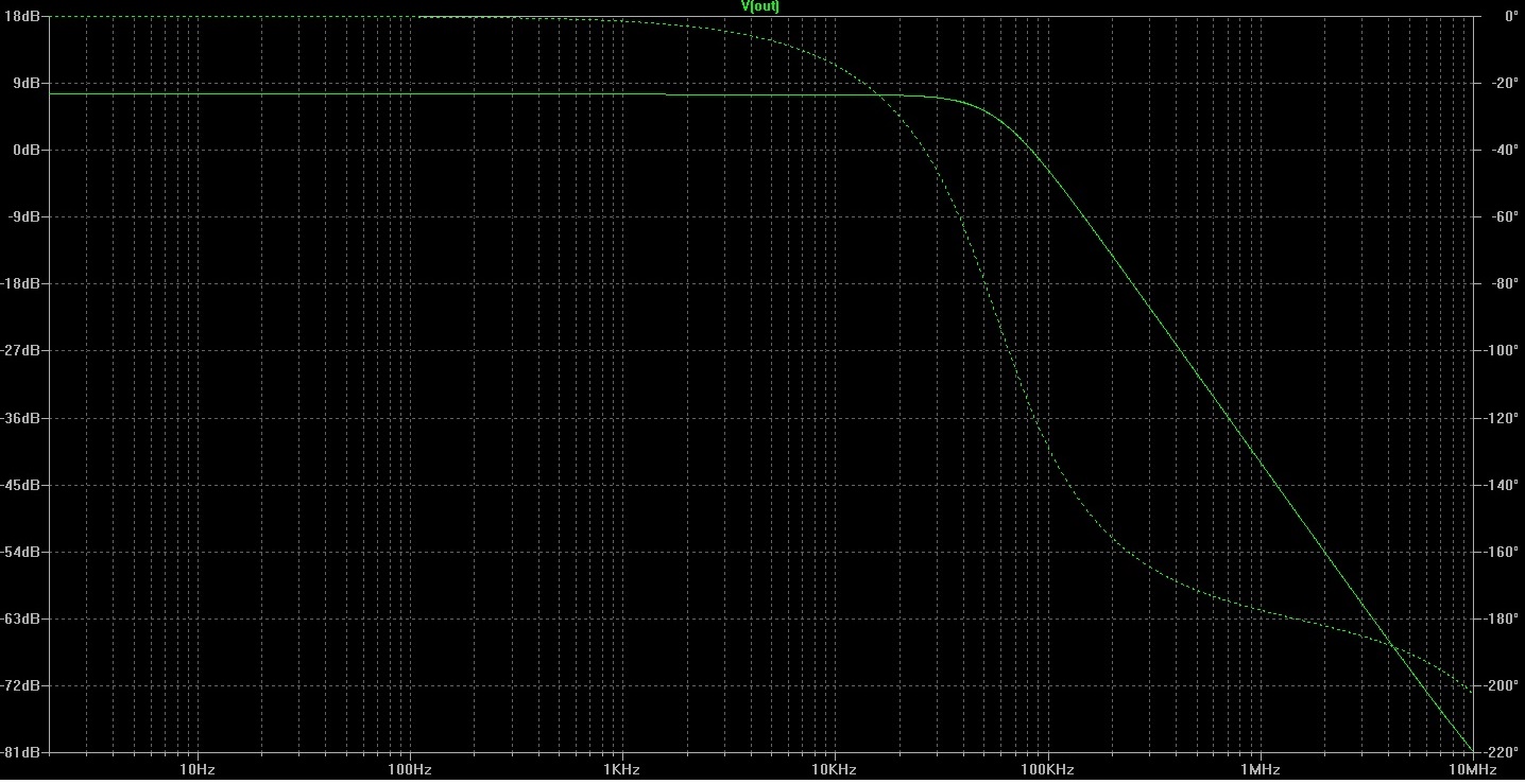

Vulejov... then put your values for that filter that you gave me in that filter calculator and describe what you get...you need to put just half period values no need to full balanced...
Multiple Feedback Low-pass Filter Design Tool
so R1 is 5110R
R2 is 2740R
R3 is 6190R
C1 is 680p
C2 is 150p
An then check original sheme values wich are
R1 1500R
R2 390R
R3 1500R
C1 2200p
C2 1000p
And now change 150p in your filter to 330p ....
so R1 is 5110R
R2 is 2740R
R3 is 6190R
C1 is 680p
C2 is 150p
R1 1500R
R2 390R
R3 1500R
C1 2200p
C2 1000p

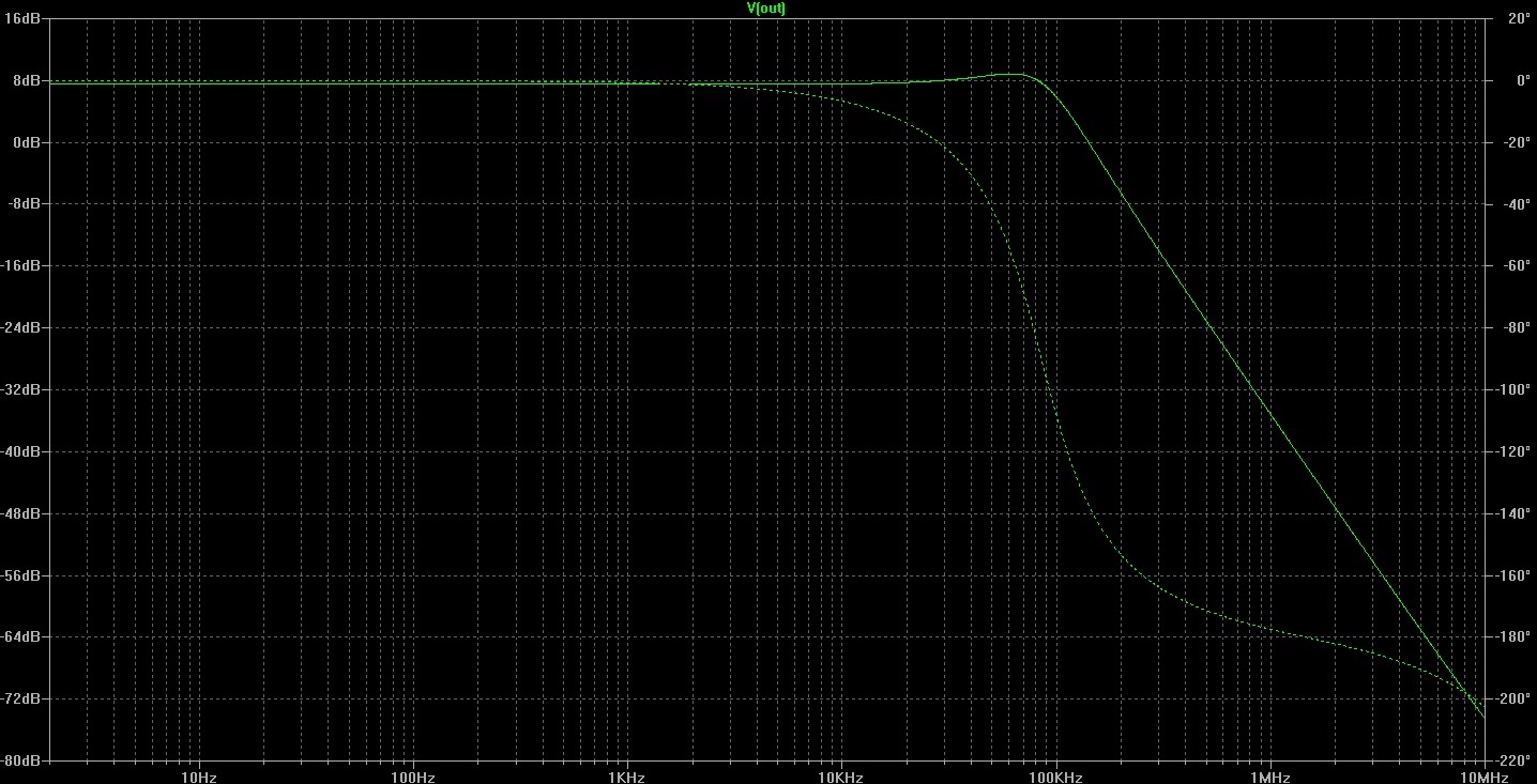

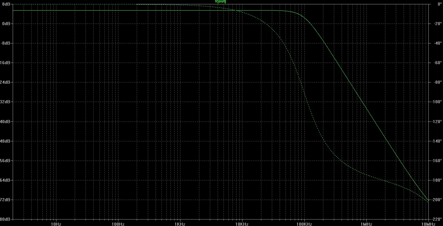

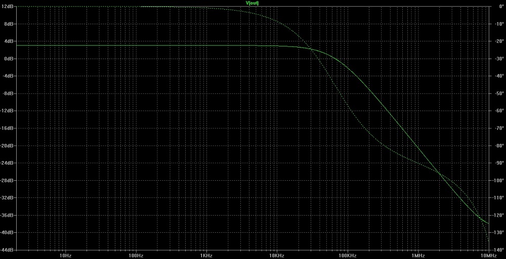

You can not use this calculator, it is note same circuit as balanced to SE output or AK..
You do not understand how C2 capacitor influence opamp speed, you do not understand how value of R1 affects AK4490 analog output..
Here are all three filters.. 330p is the worst..

You can, but you have to double C1. In differential mode, the capacitor C1 is divided by 2 accordingly. see explanation here.You can not use this calculator, it is note same circuit as balanced to SE output or AK..

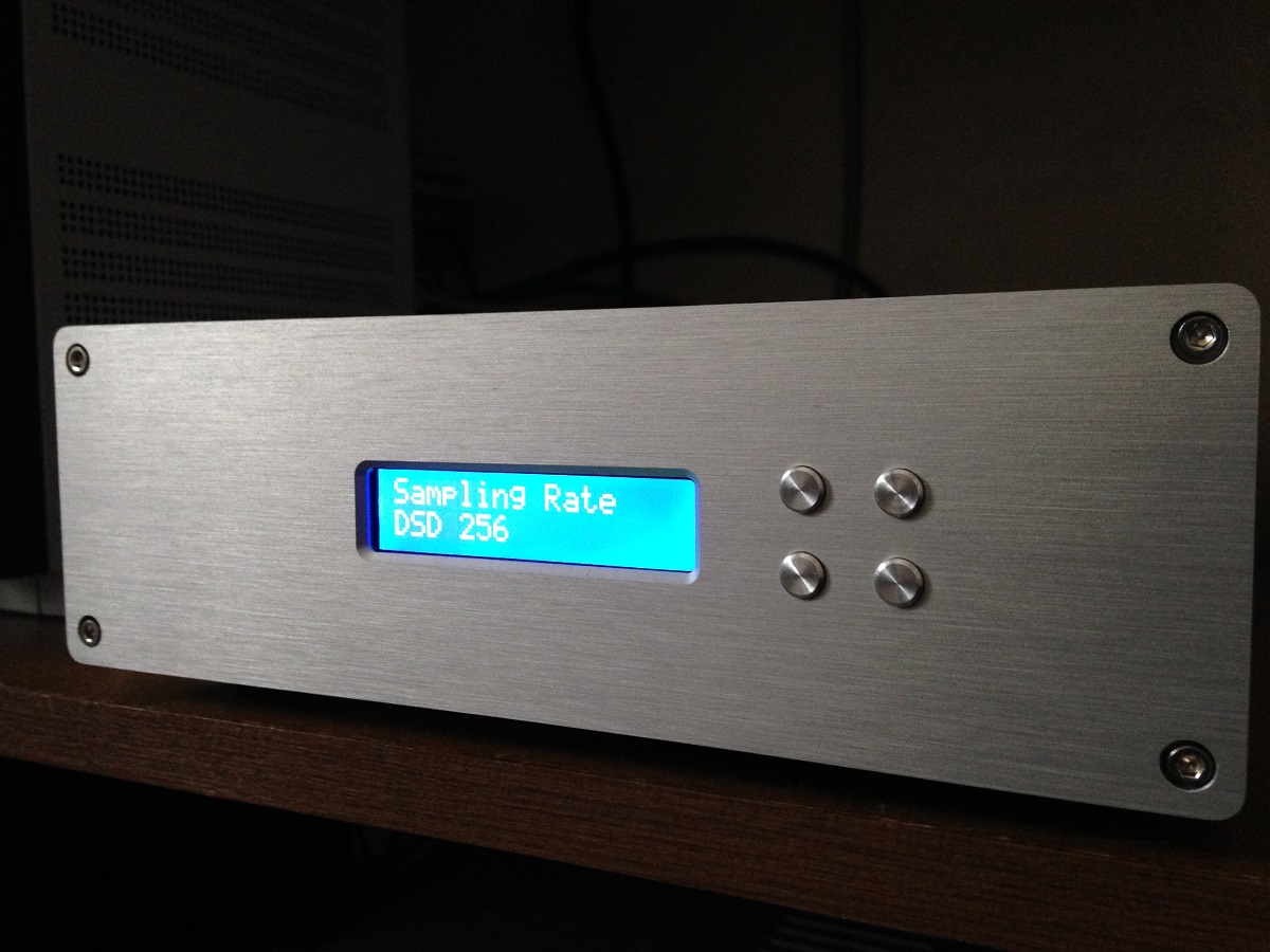

I finally got my board wired up and running. Is there a document for the display?(broken link) http://jlsounds.com/uploads/LCD_board.pdf
A map of the menu sure would be nice.
