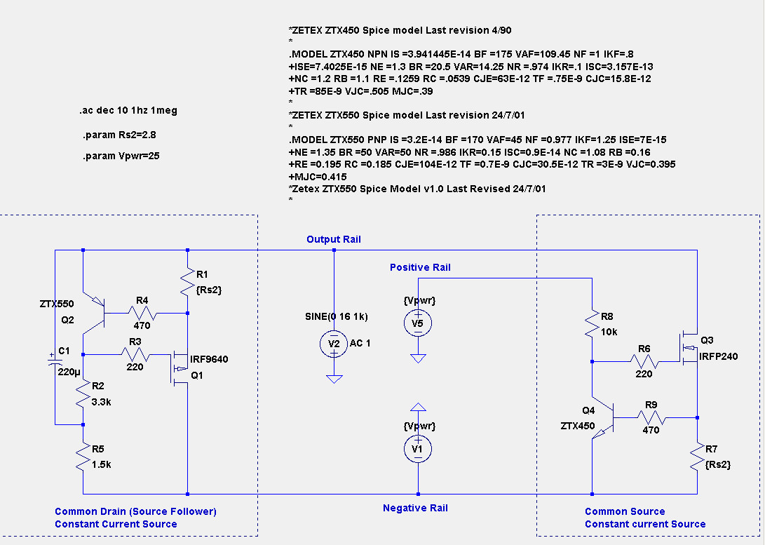

Current Source Options

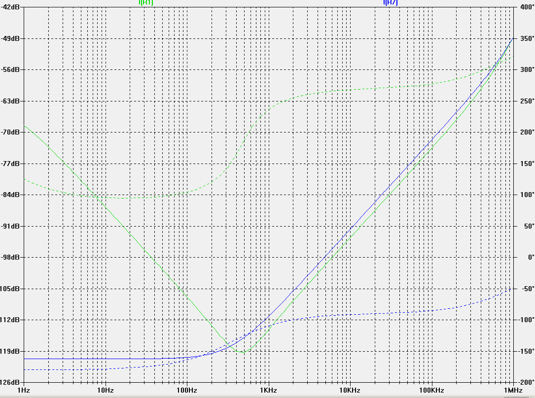

I have a question about the choice of constant current source (CCS) for the XA.8 amplifiers. Here I compare two circuits for a CCS on the negative rail:
My question is whether there is some reason not to use circuit 2, the common source CCS. The only downside I can imagine is PCB layout considerations might make it difficult to reach the positive rail.
- Left: Common Drain (Source Follower) similar to that used in the Aleph.
- Right: Common Source.
put cap C-E , then there is no diff

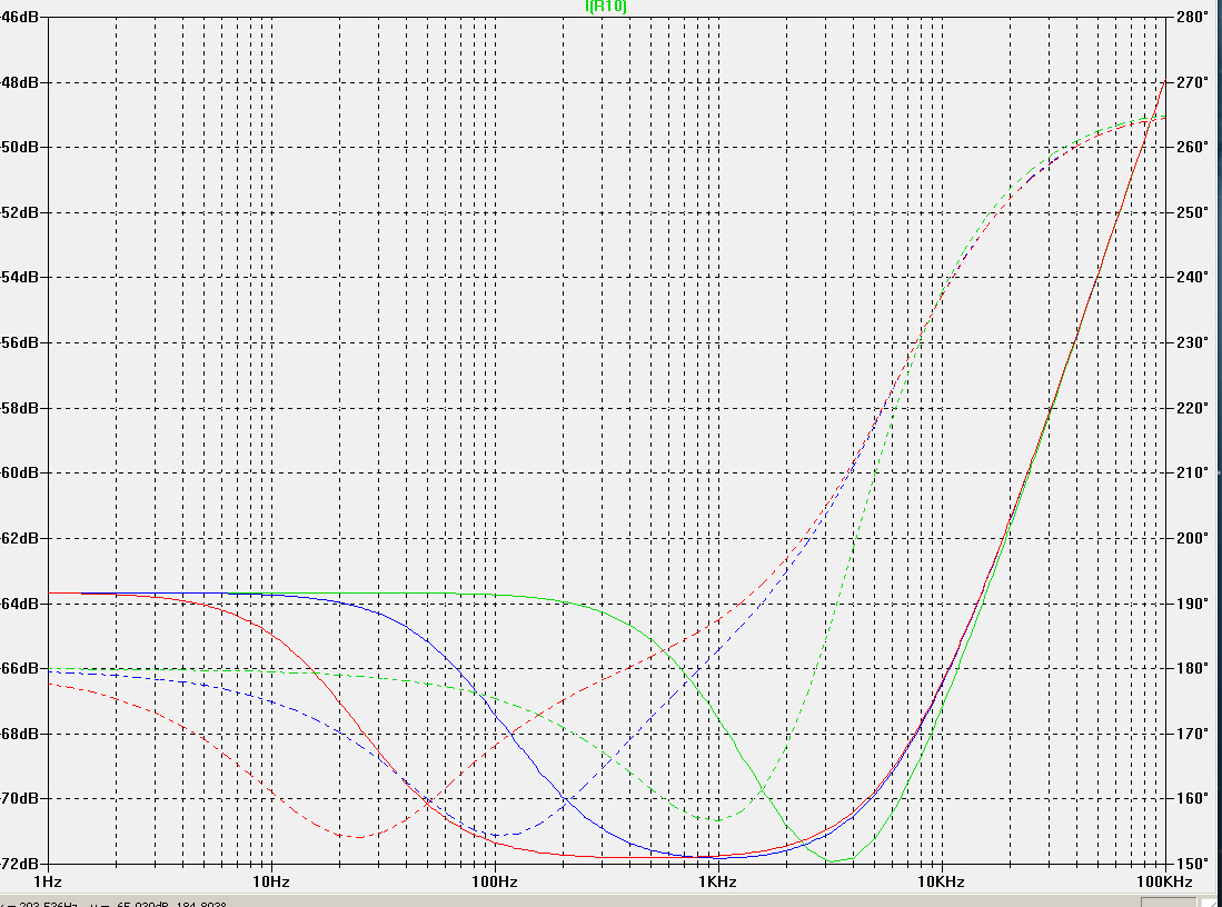

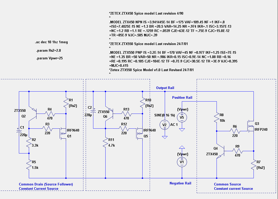

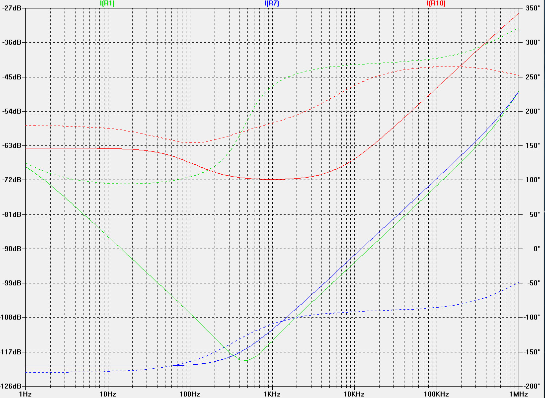

The middle circuit is your recommendation (I think), but it has relatively poor performance in comparison.
Have you played with the value of the capacitor in the bootstrapped version?

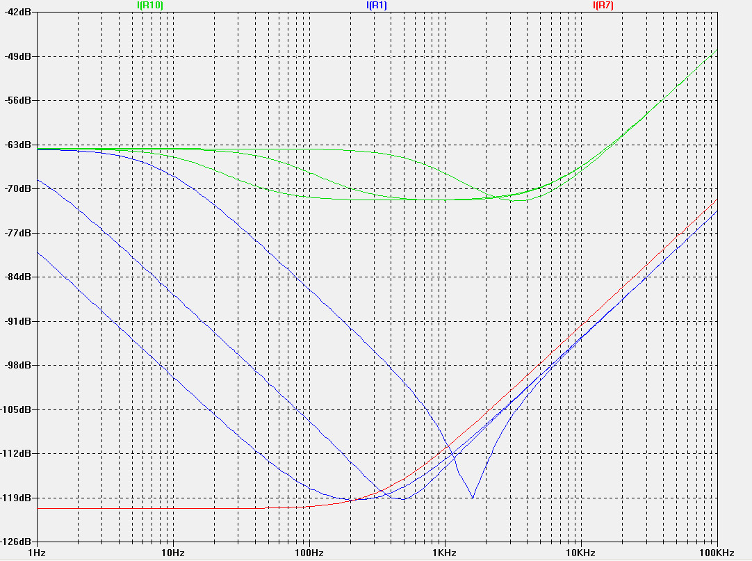

Here is the bode plot of the middle circuit (ZenMod's version) with 10uf, 220uf and 1000uf bootstrap cap.
try it on your original bootstrap circuit as well
At your request. As a practical matter, a cap larger than 220uf takes too much PCB space.
